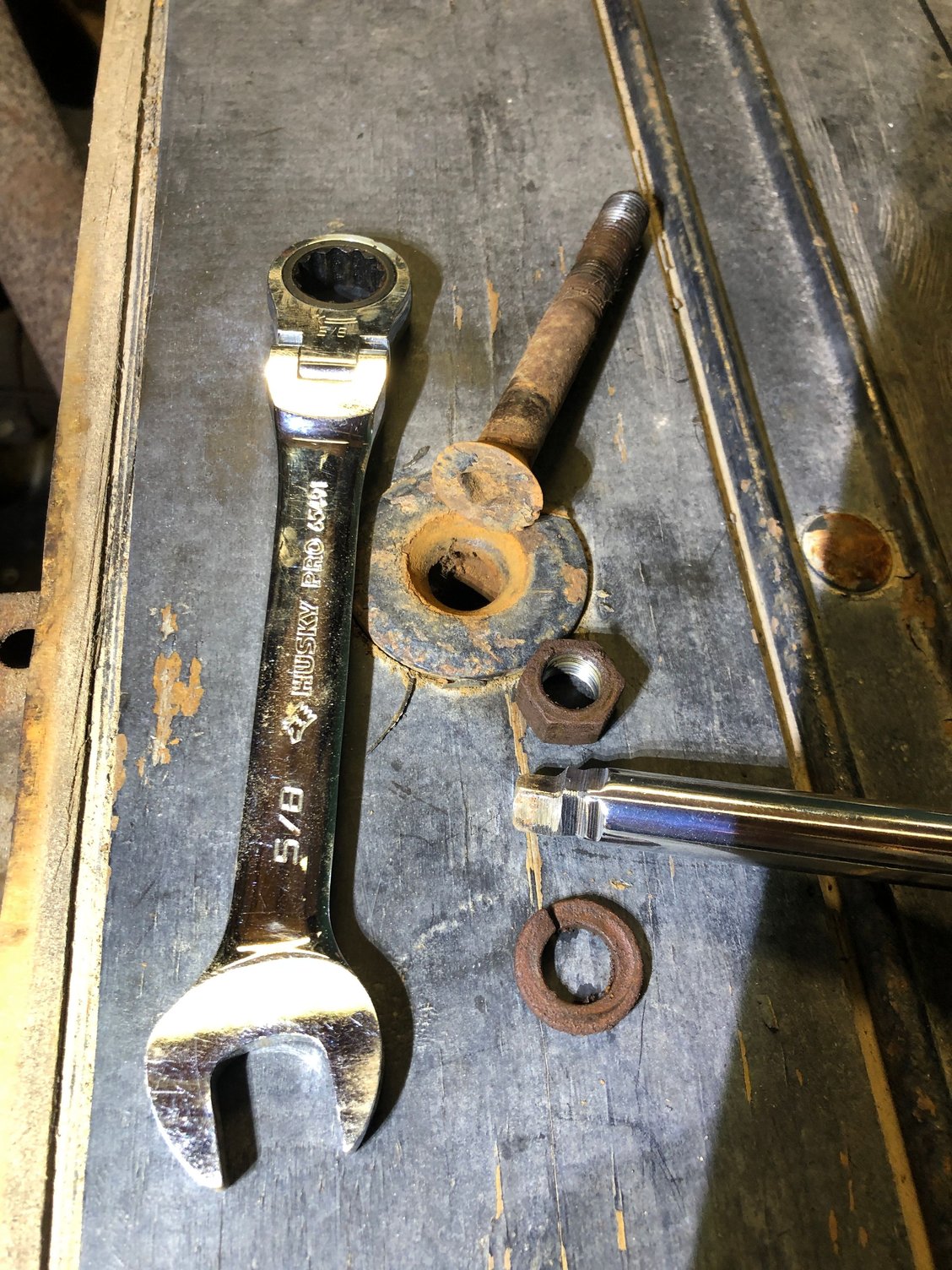

Newbie question on the truck box. I see the 4 mounting bolts inside the box, attaching the box to the frame but I'm not used to seeing bolts with square drive heads on them. What size square drive is required for these bolts? Is it 5/16"? I know my 3/8" socket extension was too large for it, but the 1/4" socket extension was too small.

Welcome to the forum! There was another recent discussion on the bed bolts. Someone mentioned using a 5/16 pipe plug socket. That would work but you'd have to find one. I still prefer taking a surplus 4" 3/8 drive extension and grinding down the end a bit to fit. Most of us tool junkies have at least a half a dozen of them laying around and could stand to sacrifice one for the cause.

Removed mine a few weeks ago, and once I grounded down the extension and hit the bottom side with the PB Blaster, all went very easy.

Since I do a lot of differential service / work on our mustangs and 70 challenger and they all have square drive pipe plugs, I found a nice set of pipe plug square head sockets on Amazon, they will be here tomorrow.
