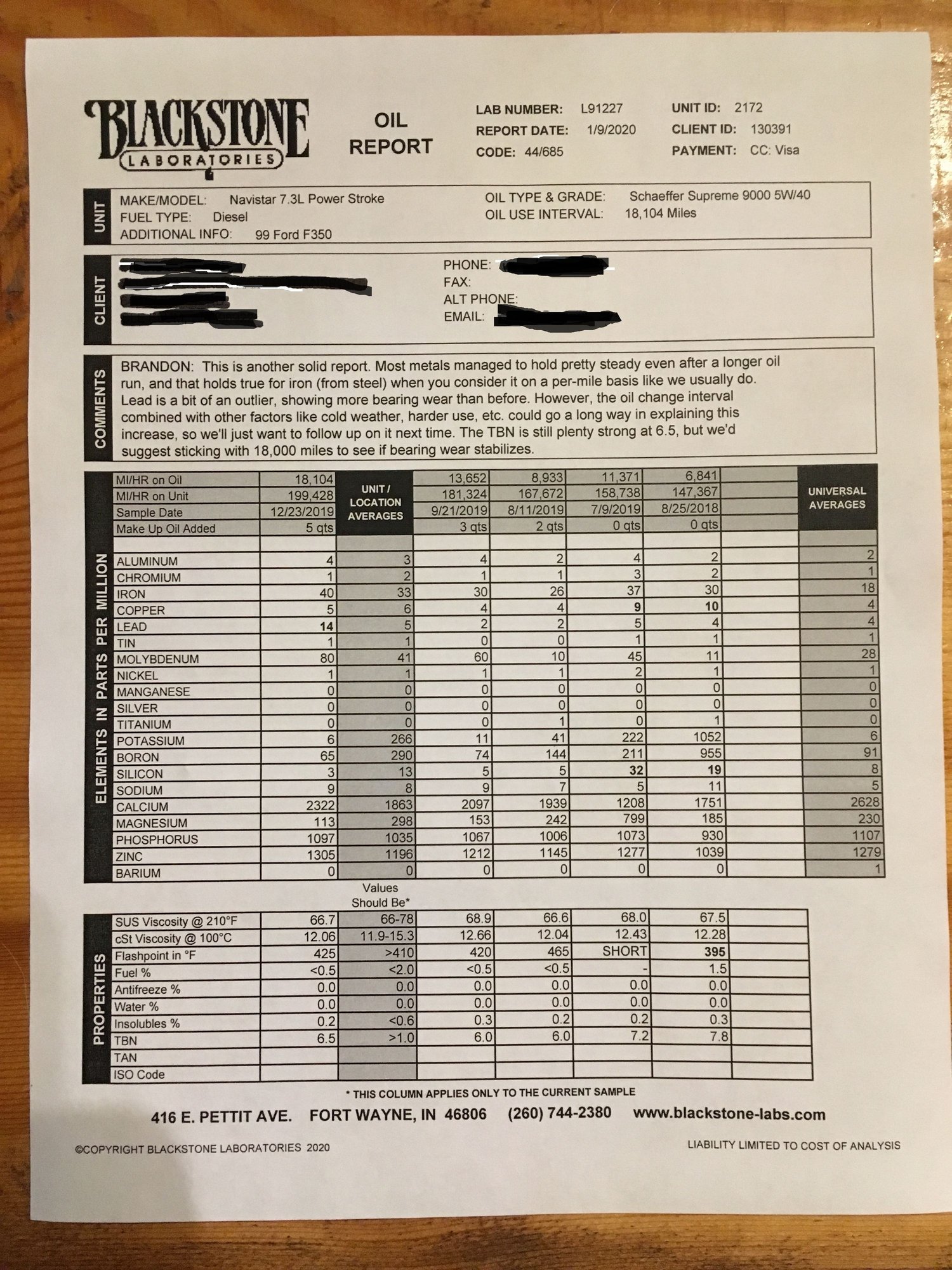

Here is an 18,000 mile interval that included a lot more cold weather idling at night to stay warm than previous reports, so I assume that accounts for the added bearing wear. Otherwise all highway and about half of it towing RV trailers of various sizes. This was a little longer than I'd prefer...15,000 in OTR use is about the sweet spot IMO since it coincides conveniently with a fuel filter change. I use the big blue Donaldson filter which holds about an extra 1-1.5 quarts over the Motorcraft filter so that helps a little.

I pre fill filter some what as well.. (thats the way my grandpa did it and he had a lot of ICE equipment to deal with) not full but i fill it up and let it soak into the filter media then add to almost top and it settles down to like 1/2 full.. when full that B is heavy in one hand laying on your back on the ground.. I use the fumto valve as well and it the deal.. I use old oil gallons and just refill them to take and dump at local autozone, advance auto etc.. best of both worlds.
One question on the black stone report of 18K miles.. is the 99 engine have the same HEUI injectors as the 2000 -03 engines.??. When i go over 5K to like 7K i start to hear a pronounced ticking in the injectors and some times at idle it get quite loud.
