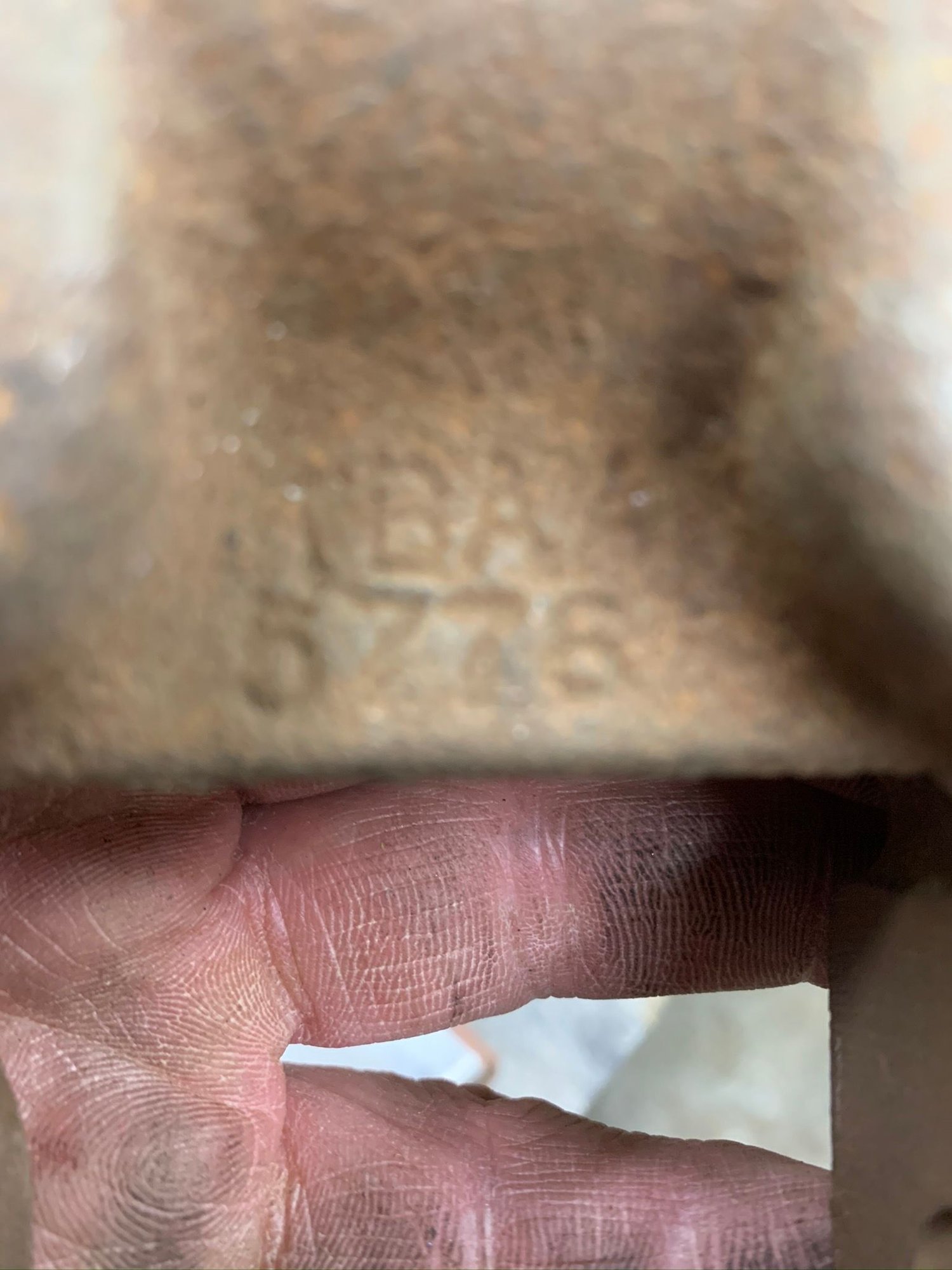

I bought these swing hangers I think in 2018. I’m pretty sure I got them at Mid Fifty. Here is the packaging. You can see the date code on it 2/21/17
It also lists 40-52 1 ton/ 53-56 f250 and f350. They are the same size as the original ones that came off of the truck. 1952 M3 (F3). Even though the parts book show a different part , these clearly fit. They have part # TBAA-5776-A. I have an NOS one I found at a swap meet and you can see it is the same as the repro ones I installed and same as old one in side by side comparison in photo. I’m not sure if they are still available. , Doug.
