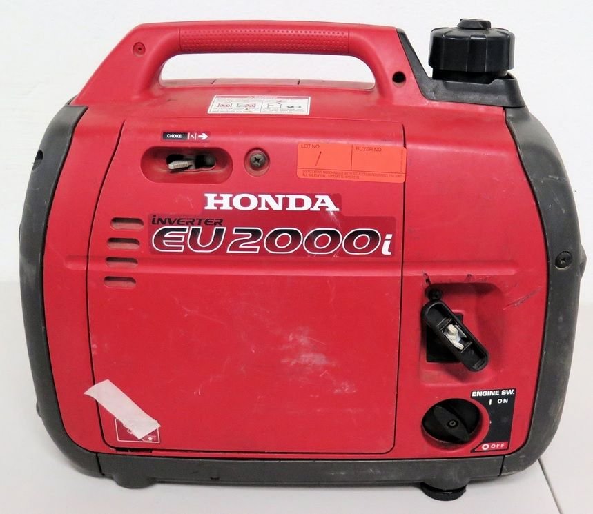

Does anyone have the older EU2000i model pictured below?
If so - I would imagine the dial "clicks" in to the "off" position. What happens if you start up the generator and rotate the dial close to the "off" position, but not "clicked in"? Will it run? Or does it, also, click in to the "on" position, where if you move it out of the clicked in/detent "on" position the ignition cuts off?
What I would be curious about is if you can start up the generator and move the dial down close to the "off" position and see if the generator will run itself out of fuel. This, on mine, takes about 3-4 minutes near idle. What I want to see is if the old style dials are actually cutting fuel off with that dial as you rotate it. If so - if you know that "work around" you, too, can run the generator "dry" by doing it, as opposed to killing the ignition or using the screw method that @acadianbob mentions to drain the bowl. The downside to even draining the bowl is the residual fuel between that and the cylinder is still present and will dry out, but it will keep the float/carb clearer.

I own both the old eu2000i and the new eu2200i.
The old will keep running till you actually turn the **** to the off position. The only way to get the fuel out of the carburetor is use the screw on the bottom of the carburetor to drain it.

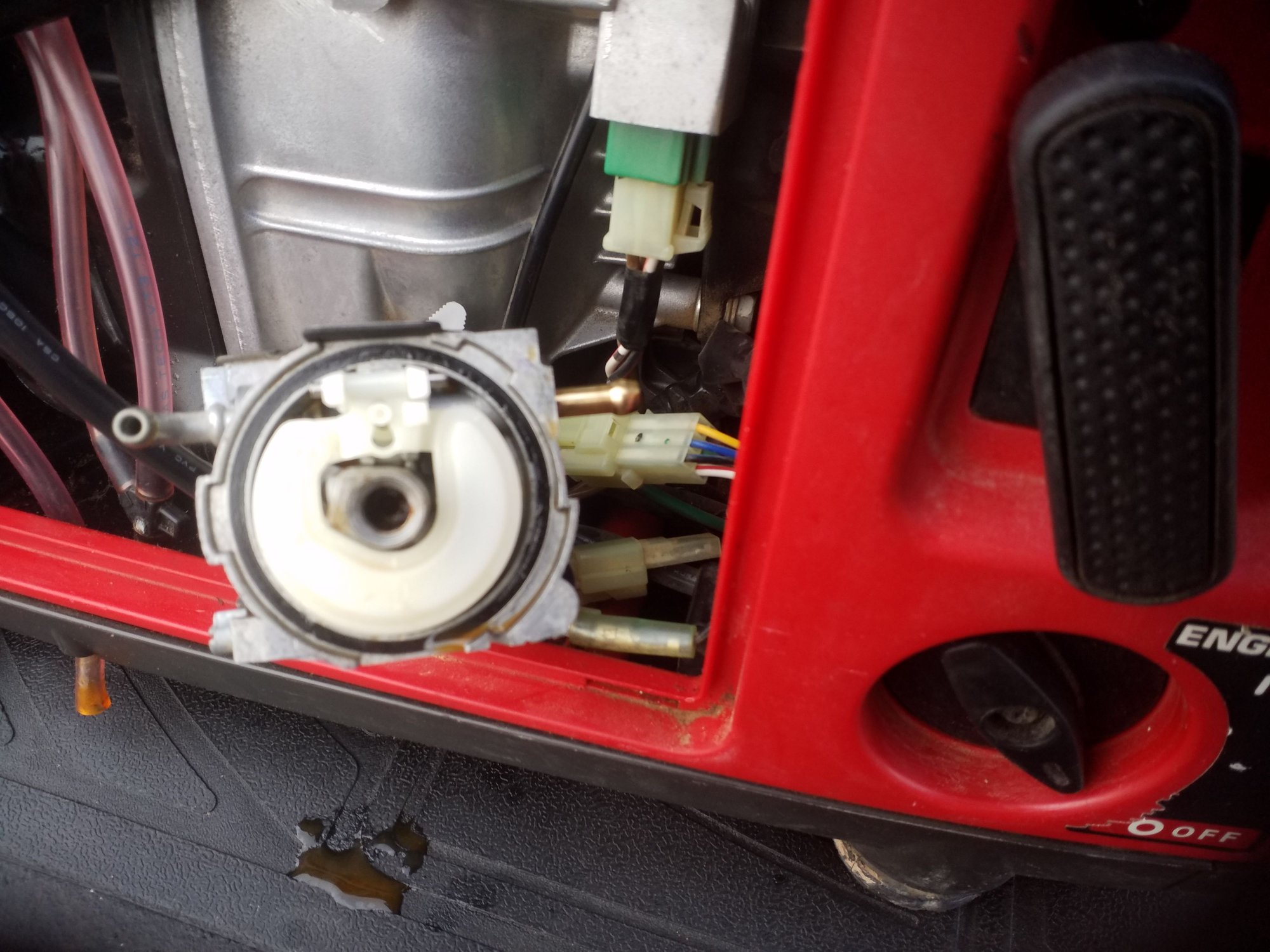

@scraprat does the 2000 series burn all the fuel out of the carb? I think I read they are bad about that. Running the unit "out of gas" doesn't, leaving stale fuel to gum up in the carb. I have one, they are excellent generators but I haven't needed it in a few years now.

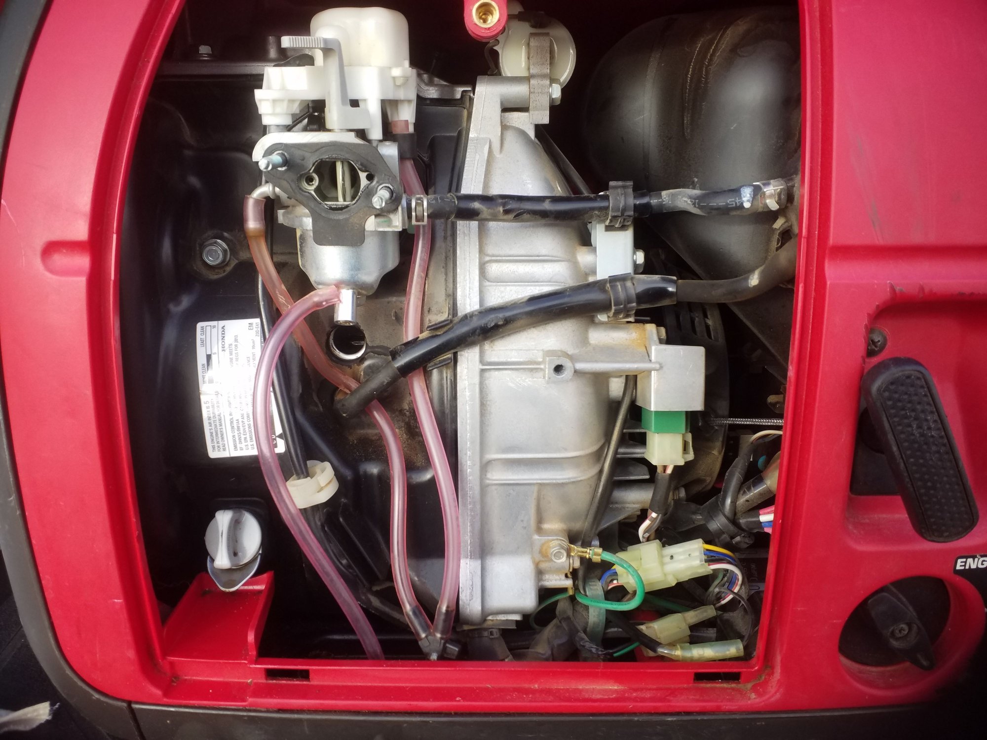

No it doesn't burn it all out. Here is a pic from my eu2000i from Nov when I cleaned it. I use my generator maybe a dozen times a year mainly in the winter months and run it for 2 hours at a time I got lazy the previous year and didn't clean the carburetor or drain the gas from the carburetor but use seafoam in the gas that goes into the generator. It was running rough. For folks that don't know there is a small brass tube that runs up through the middle with a few pin size holes in it for fuel distribution. It wasn't pretty in there, after some carb cleaner and a little brass brushing purrs like a kitten now.
the air filter assembly removed.

That was my experience with them as well ^^^, though I never saw that much sediment in the fuel bowl.
I found that the wire out of a bread bag's twist tie was about the right diameter to clean that brass pieces holes. I ended up taping one inside the cover of one, so I didn't have to go find a new one when it was time to fire up the generator.
