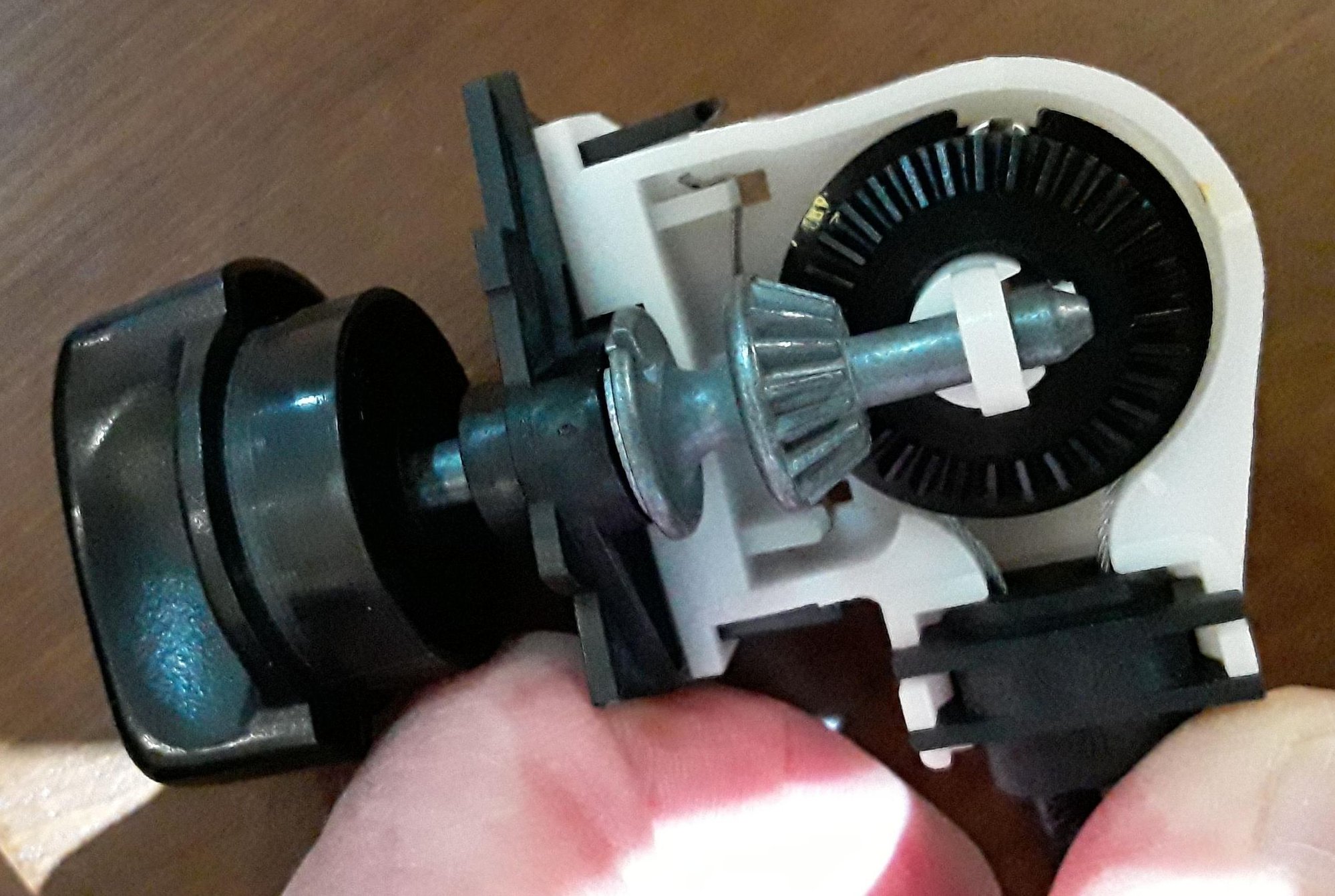

Here's a photo of the 1996 double cable at the climate control end, after removal from the climate control module (and with the **** put back on in order to move the cable), to compare with your 1994.

Looking at the pictures of the two (I don't have them in front of me) it looks like the drive assembly could be swapped from one to the other as both appear to have a tab and a screw hole.

Since I'm currently dealing with a sticky 1996 double cable, I also wonder if it's an upgrade or worth the trouble to switch from the 1994 single cable, unless your single cable is broken and you happen to have access to a hard-to-find double cable. Most of those big plastic cams are probably getting kind of brittle after 25 years, and it's twice the length of cable to dry out or kink.
