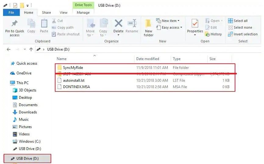

Ford really makes this difficult. It says NOTHING about unzipping the files before moving. I tried both before and after. No luck. Same message. Finally, reformatted my flash drive and deselected they “quick format”. Took well over an hour to format, but it worked. Having trouble unzipping with Windows 10.
Did you try unzipping on your local machine before moving to USB? That was the only way I could get it to work - it would fail every time I moved it to the USB drive then attempted unzip.
The website instructions are horrible. The only thing that hints to unzipping is where it says "extracting" at the top of step 2.
Their screenshot of file explorer is also wrong, you don't need both the JR3T-14G381-AM.ZIP folder AND the extracted files - that would take up twice as much space on USB drive,
You only need the SyncMyRide folder along with the autoinstall.lst and dontindx.msa files.
