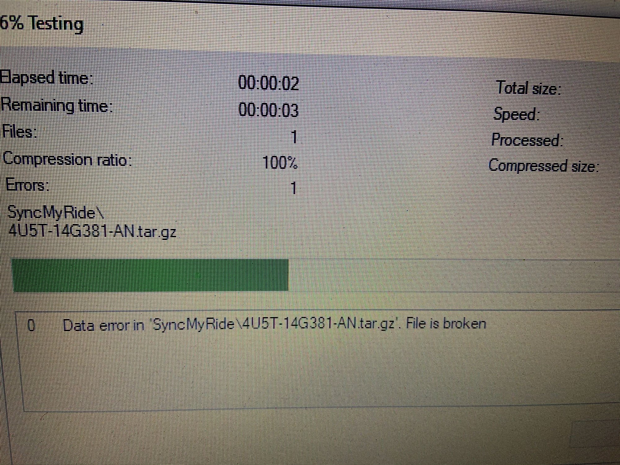

I must be doing something wrong. I downloaded the files and tried it in the truck. I get a failure message. Then, I tried re-downloading from the Sync site about four more times. Each time, I opened the 7-zip Manager. Selected the Sync folder, extract “here”.
It gives me four files. Then each of those four needs to be extracted. One of the four files, which ends in AN.tar.gz has an error every time. See photo.
EVERY time, it’s that one darn file!

I must be doing something wrong. I downloaded the files and tried it in the truck. I get a failure message. Then, I tried re-downloading from the Sync site about four more times. Each time, I opened the 7-zip Manager. Selected the Sync folder, extract “here”. It gives me four files. Then each of those four needs to be extracted. One of the four files, which ends in AN.tar.gz has an error every time. See photo.
That is frustrating.... they don't make this easy. Instead of 7-zip, have you tried the native windows 10 extraction tool? Should be able to right click and select "extract all" instead of extract with 7-zip. That worked for me.

I get errors when I try to unzip and move 2 of the files, no matter what tool is used to unzip and no matter what the destination ( hard drive, thumb drive, network drive ). Tried Windows 7 and Windows 10 OS PCs.
All get the same "unspecified error".

as the OP, I have about given up on this for a while. My Harley uses a similar system for updating and it always works. everything I see says two of the files are corrupted - doesn't matter what format the destination has.

If you do get it figured out please post. I'm having the exact same issue... it's pretty obvious the files are corrupted.

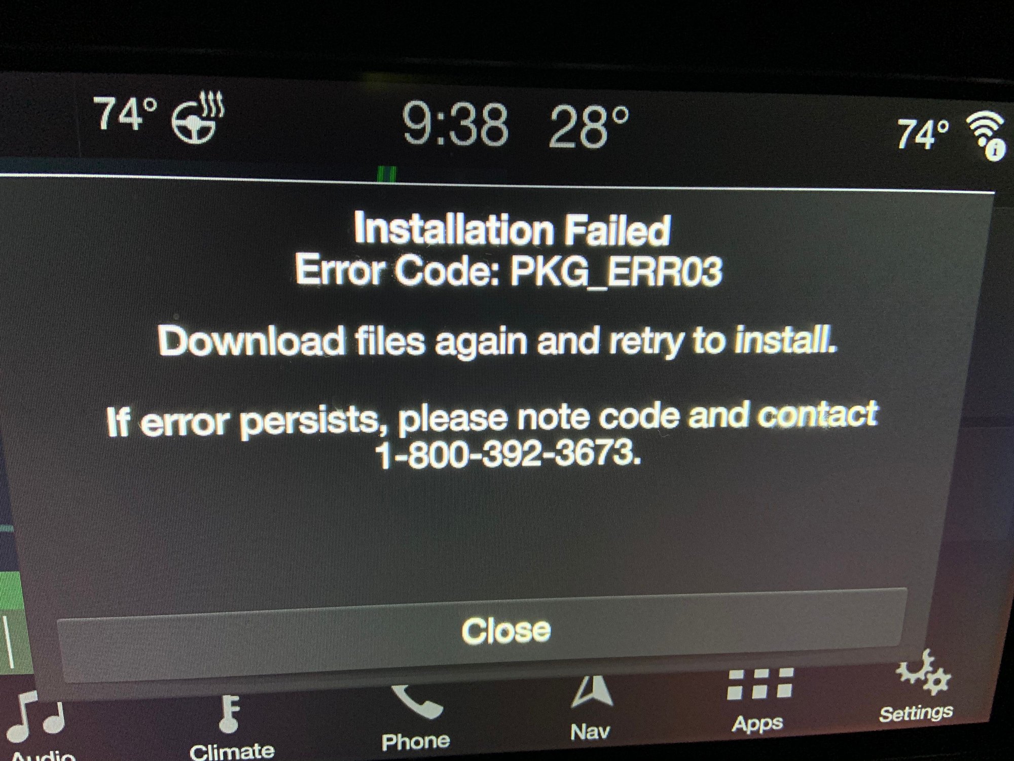

Yea, idk... it worked for me after hrs of trying. But then I hit the issue where it says update failed bc out of memory or not compatible with version. Ugh. Trying to figure out how to get past that now. Why the heck is this so hard.
