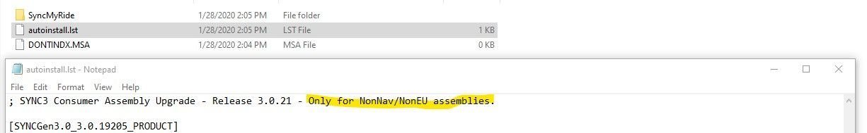

Originally Posted by hillcountryflt
Thought this update might work on my; 2016 Expy with Sync 3. it accepted it and then reported the update is available for sync 3 with nav only. Checked the ford owner website for updates related to the expy and it shows only the same file name downloaded for my truck - so assuming this update only applied to nav based sync 3 systems and no updates are out there for the non-nav systems.
You will need to download separately for non-nav sync system. I don't have nav on my '18 f150. If you open the autoinstall.lst file with notepad, you can see that it is only for non-nav units:
