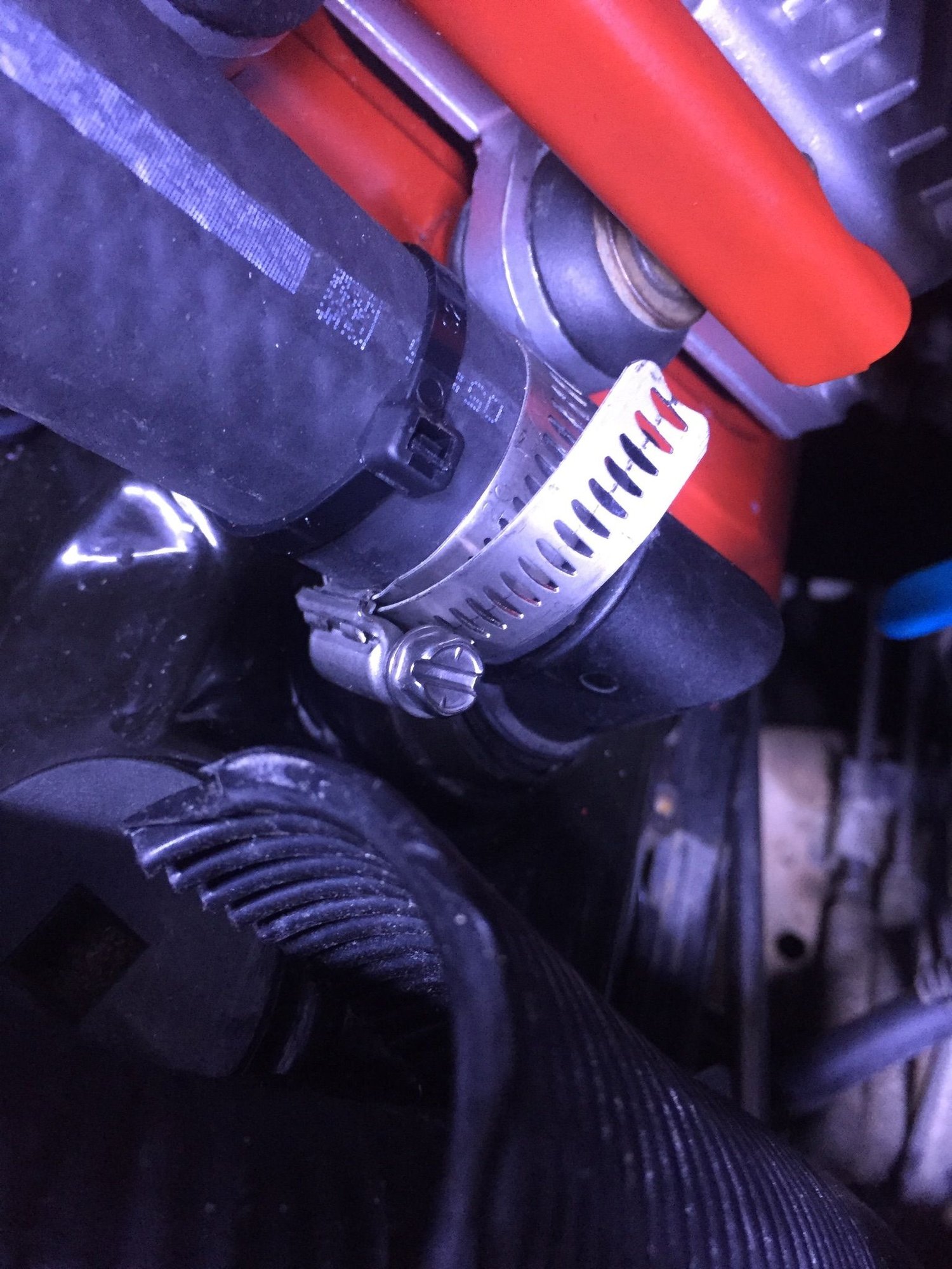

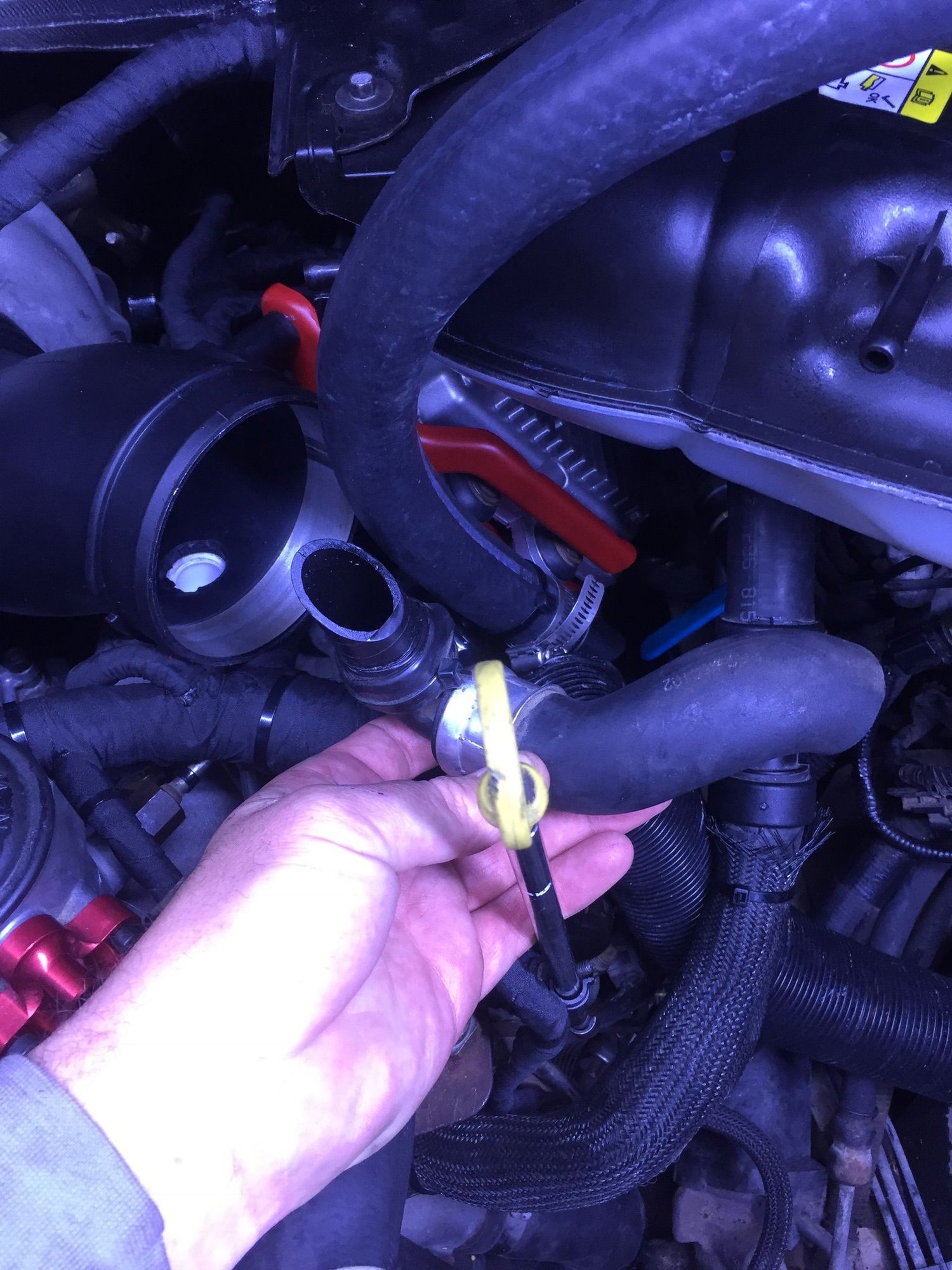

Plug the intake hose inlet with a 1” PVC plug
Pull the CCV tube off the intake and twist and pull fitting out of valve cover then cut the center section of hose off fittings and replace with 1” heater hose and clamps so you can turn it the other way towards driver side battery.
Run heater hose down to frame and terminate by transfer case or about halfway down the frame on 2wd. Leave it open ended, never drips at all.

thank you. I was interested in how you laid the hose. It goes up in front of the degas bottle. directly from the elbow downwards is very narrow.
i'd like to run the hose right down from the elbow. i'm gonna look...
