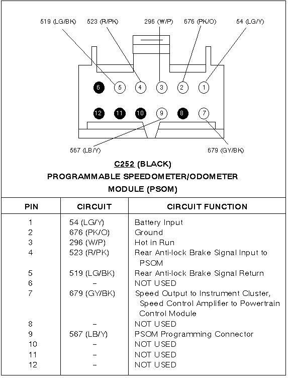

I have a 1997 F350 7.3. I have no digits displayed in odometer and the speedometer doesn’t move. So I’m not getting a speed signal. I’ve done the vss, changed fluid, checked wiring, ive even sent the cluster out 3 times to be repaired. I have power at the plug for the back of speedo in the correct spots and a good ground. I am stumped and I was wondering if the pcm could be doing this. Or what I need to tackle next. Thanks in advance

You have codes get them read with a scanner that can read transmission codes.
a bad PSOM could cause this as well IIRC.

When you say you checked the wiring, do you mean you electrically checked both wires to the VSS from the PCM for continuity, short to power, and short to ground? If not, you didn't check the wiring.

I have power to those 2 pins and I even checked that the ground checked out. am I going to have to pull the dash and change the harness

My dogs chewed up the wires running to my rear differential. It had the exact same symptoms you have but I don't remember the flashing OD but it could've. I would check those wires on the rear differential. I spliced mine back together and it's been working fine since.
