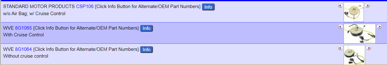

OK, so go to another parts store and see what I can see. Oh look, there is another Dorman part number 525227 at O'Reilly that states "w/ air bag and w/ cruise control". Great! Wait, the one single review states "part was completely wrong for a 2001 F250 with cruise control and airbag". Well crap...
Link to O'Reilly clockspring page
At this point I am thinking I might need to remove the OE clockspring and match the connectors to what I can see online. But, then the truck will be laid up for at least a week the pictures online are not always a good representation of what we receive in the mail.
Advance Auto has the same Dorman 525213 that I have pretty much determined is the wrong part, but they also have a BWD with part number CLS206. Although, the BWD part once again boggles my mind with the description of w/o airbag...
Link to Advance Auto clockspring page
Might as well try AutoZone now since we are running out of options and have already wasted a crap ton of time looking for a part that should be simple to find. This is starting to remind me of my U-joints ordering fiasco which turned out to be a great learning process for me and will hopefully help others in the future.
AutoZone was nice enough to include both Dorman 525213 and 525227 in the search results, but my confidence level is low for either of those part numbers. Despite the description for 525227 being correct as "with speed control" and "with air bag", I would prefer to have a bit more confidence in the part I was ordering. I could return the part to a local store if it was wrong, but that doesn't get a new clockspring into the truck, so moving on...
Link to AutoZone clockspring page

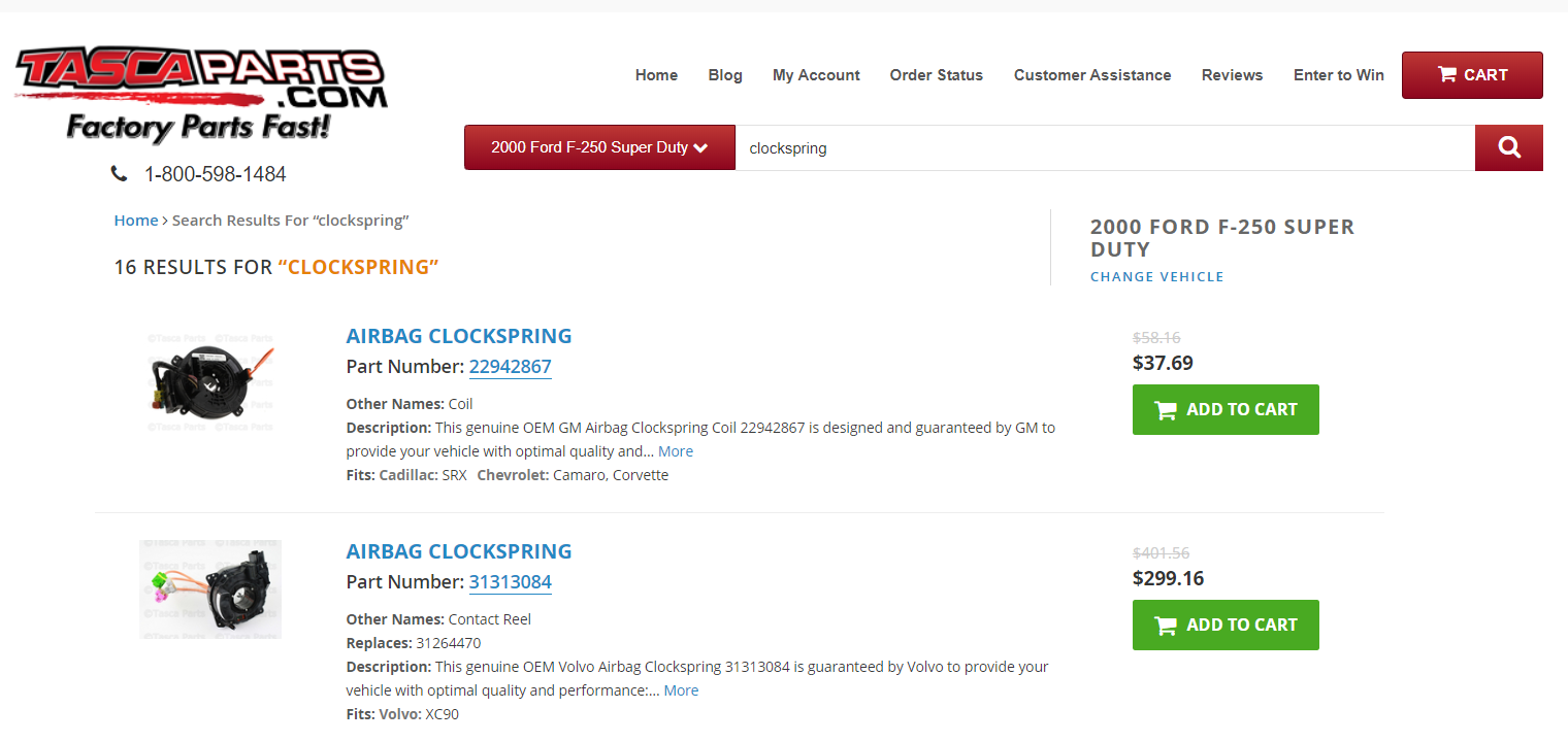

Going to Tasca Direct OEM Ford parts has been a good choice in the past at times, so I tried them. Their search results for a 2000 Ford F-250 Super Duty that needs a clockspring came up with 16 results. Most of which are for different manufacturers like Volvo and Chevrolet.
So, I ask you my friends of the FTE... Do you have a good and reliable part number from ANY manufacturer for a clockspring that will allow the airbag and cruise control to function properly in a 2000 Ford F-250 XLT?

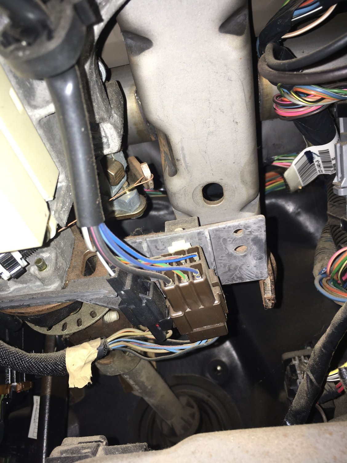

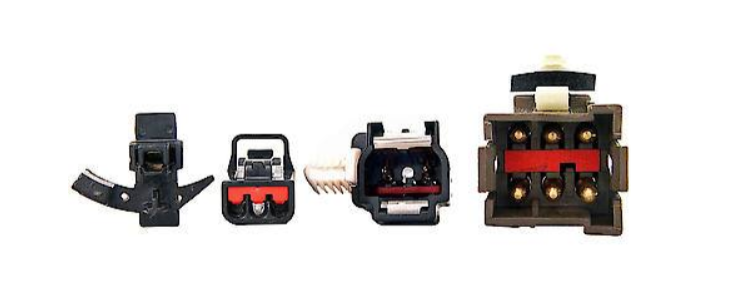

These are the plugs that need to match. This is just below the steering column.
The airbag, cruise control and horn connectors are all the same under steering wheel AFAIK.
Its really easy to yank steering wheel off. Unplug the (2) plugs at the end of clockspring harness, remove the little plugs on back of steering wheel and remove airbag with 8mm socket. Bomb suit not required - you have to send 12v to bag to blow it up.
Loosen the the steering wheel nut, but don’t remove it. Put your hands at 3 & 9 o’clock and your feet on the floor. Pull and wiggle. We left the nut on so ya don’t end up on the back seat.
2nd pic is a 6.0 column that had steering wheel controls. You’ll have different plugs than this, but looks the same otherwise.
My confidence level in being able to remove and replace the clockspring are high, but I am having trouble finding the right one to purchase without tearing into mine first. Maybe since Lavonia GA (next town over) has a regional distribution center behind it, maybe they can get the right one the next day or something if I take the current clockspring in.
I will have a look under the steering column at the connectors. The connectors is another aspect of the clockspring that is somewhat confusing as well. Some of the descriptions state "new 6 pin connector which replaces old 3 pin connector". Here is an image of the connectors for the Dorman 525213 clockspring.

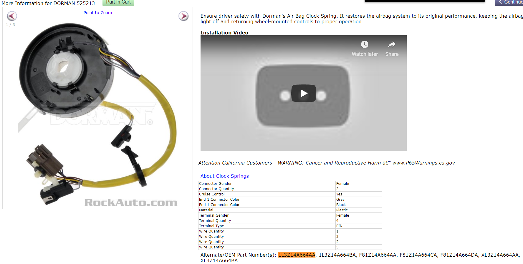

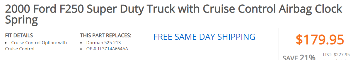

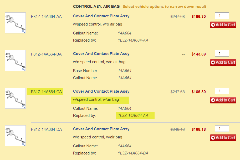

According to Tasca Parts online, the proper part number is 1L3Z-14A664-AA. Link to Tasca part page.
I plan to dig into this part number and see if I can come to some sort of conclusion that this is in fact the right part.
EDIT: 1A Auto has the 1L3Z-14664-AA part number listed as Dorman 525213 as does Rock Auto. I am fairly confident is stating the Dorman 525213 clockspring is in fact the right part for a truck with an air bag and cruise control....
Snip from 1A Auto below.
Snip from Rock Auto below.
Looks like I might be getting the Dorman 525213 and giving it a shot. Unless I decide to pay the higher price for the Ford manufactured part at $166 instead of the Dorman part at $87. Rock Auto has the Dorman for pretty cheap, but I will check eBay as well before purchasing and see about getting the Ford part cheaper than $166. Hopefully this thread will help someone in the future that runs into a similar issue like I was having.

I bought the dorman 525-213 from RA last year. Lariat with airbag and cruise control. All plugs matched.

Thanks CC, this only solidifies my findings and thoughts on the matter.

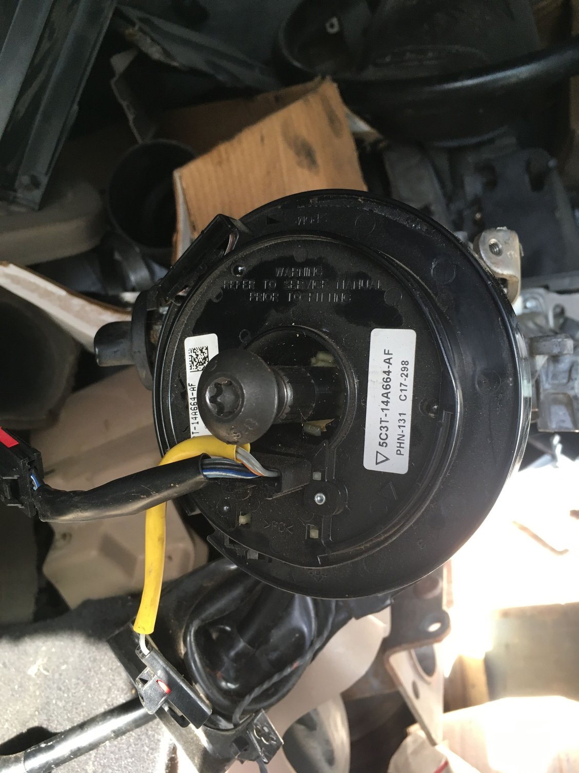

Bumping this thread to ask if anyone has tried the much more affordable clock-spring for the 7.3 vans?
Part no is F8UZ-14A664-DA. Looks just like the Super Duty clockspring: https://www.ebay.com/itm/264187210444
*EDIT* I'll find out later this month

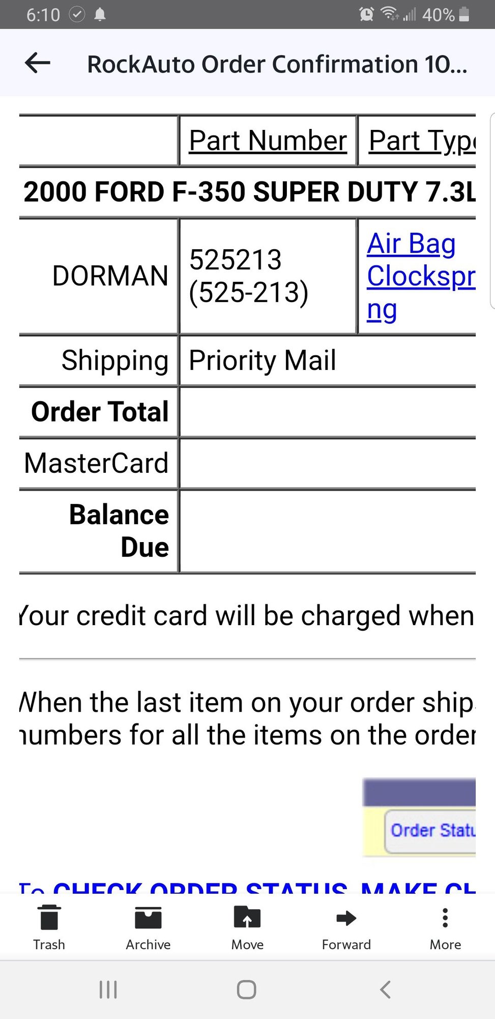

PriusLover, disregard the request for information on the fitment. I went ahead and ordered the Dorman 525-213 clock spring from Rock Auto.

Sure thing. The parts shipped early this morning and I hope to have them installed in the next couple weeks. Truck is in the garage already and I will start tearing the steering wheel area down soon.
I'm going to try and remove the steering wheel without a puller, but may have to rent one.
