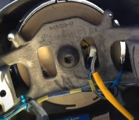

I'm under the impression there is a torx bolt holding the steering wheel on and then loctite and age to the splines. I took a snip from a couple of videos on the YUBETUBE and pasted them below. My plan is to loosen the torx bolt, thread it out most of the way and then back in most of the way. Try to beat the steering wheel on each side and pull up on the opposite side and middle together. I will only give it a decent try before stopping instead of going "ape $sh|t" on it and breaking something else.

@Sous , may i suggest a 2-jaw puller instead? That's what the slots on either side of the bolt are for.

That looks like torx Plus.. The plus stands for we want you to spend even more money on tools.

T-50 got the job done! Thankfully that is the largest Torx bit I have on hand and no need to run to the parts store.
