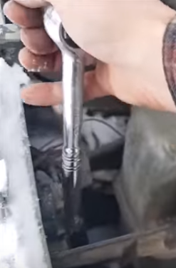

Today I was watchin zip ties and bias plies and I saw him jump the solenoid with a ratchet bare handed
first I thought he was gonna shock himself but nah he also later used his leatherman to do the same thing
is this really possible? When I learned how to jump a solenoid I was told to use a screwdriver and never touch anything other than the handle
heres a pic
heres the video too

What's the difference between the ratchet and attaching the positive battery terminal? I prefer to use my Copenhagen can on the Ford solenoid as its always convenient.

sure it's possible.... but pretty stupid .. leaves nice Arc Marks on your tools and if it happens to be near a battery that is Out Gassing you could kiss yer but good bye...... Just saying...

You were thinking he would get a shock. 12 volts won't shock you.

Nah, not much of a shock... and if you're jumping the solenoid, not the battery, it won't even arc much.
You MIGHT get a tingle if you're still attached to the coil in the solenoid when current is interrupted
and the field in the coil collapses. Just a tingle, tho
Now, touch the negative terminal of a coil with the engine running,
thinking, 'ah, it's only 12 volts' and THAT will make a finger twitch!

12 volt auto batteries won't "shock" someone the way high voltage will. What it will do though, is instantly turn anything electrically conductive e.g. a wedding band or metal watch strap, into red hot molten metal. From all accounts this Sucks Really Bad.
Be careful around batteries, they are absolutely nothing to fool with, there is a tremendous amount of energy stored inside.

Now, a lot of what he does is "hold my beer and watch this". There actually is a bit of science behind jumping the solenoid with bare metal tools and not getting shocked. Trick is to remain connected to the battery connection, not the coil connection, i.e. stay connected to the big post and lift off the small post. Reason is, the collapsing magnetic field will generate that spike in the coil of the solenoid when the circuit is broken. The battery is not affected.

Yep, totally feasible, I've done it plenty of times. Those solenoids like getting stuck from time to time.
Of course, observe caution, and if possible, use tools with insulated handles.

I did the same quite a few times on my dad's '87 until we got the key switch working, though usually with a screwdriver. If the solenoid itself is good but your wiring/key switch/inhibitor isn't working right, you can jump from the battery cable connection to the control post (the one with the wire that pushes on). That'll engage the solenoid and make the starter go without the sparks and drama.

2 ways to Jump it....... 1st off from Battery terminal to the S post ,,, IF the Coil in the Relay is Failed this won't work.... 2nd way across the 2 large Posts, you will get a larger EMF kick from the Starter solenoid than you get from the Relay coil.
this is why Remote starter switches are handy.... I guess in an emergency you do what ya gotta do.
it Not Voltage that Kills it's Current... https://darwinawards.com/darwin/darwin1999-50.html
Granted it's not likely 12 volts would hurt you under normal circumstances due to skin resistance being high and we all know Ohm's law (for sure we in the field do)
get that wrench across the battery terminals and This is what Happens........................................... .......
