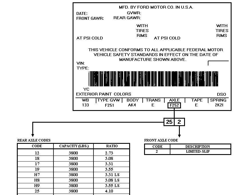

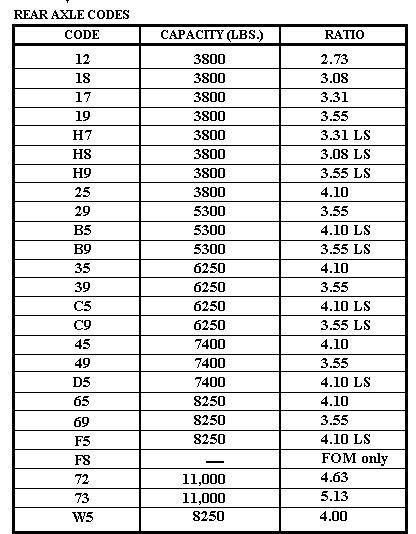

Check the Axle Code on the sticker located on the driver side B-pillar. OBS trucks never came with 3.90 gears from the factory. Yours is 3.55 or 4.10 assuming it still has factory gearing.
Example:
Ford Truck Axle Codes

4.10
It has 4.10 gears.....C5 code.... gas mileage sucks!!!
