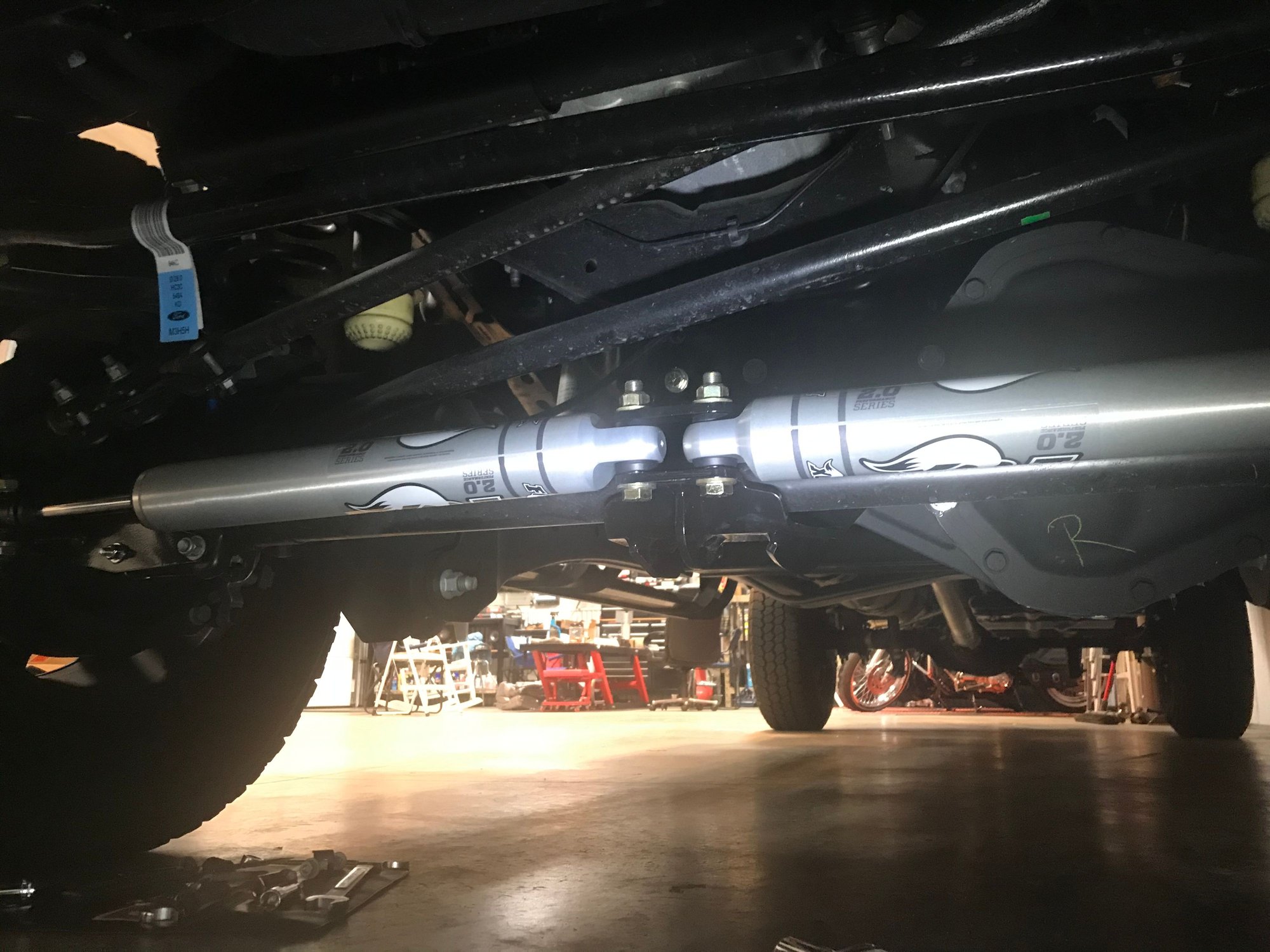

Did you install Kelderman yourself? Would you post some pictures of this set up please.

Here ya go.
