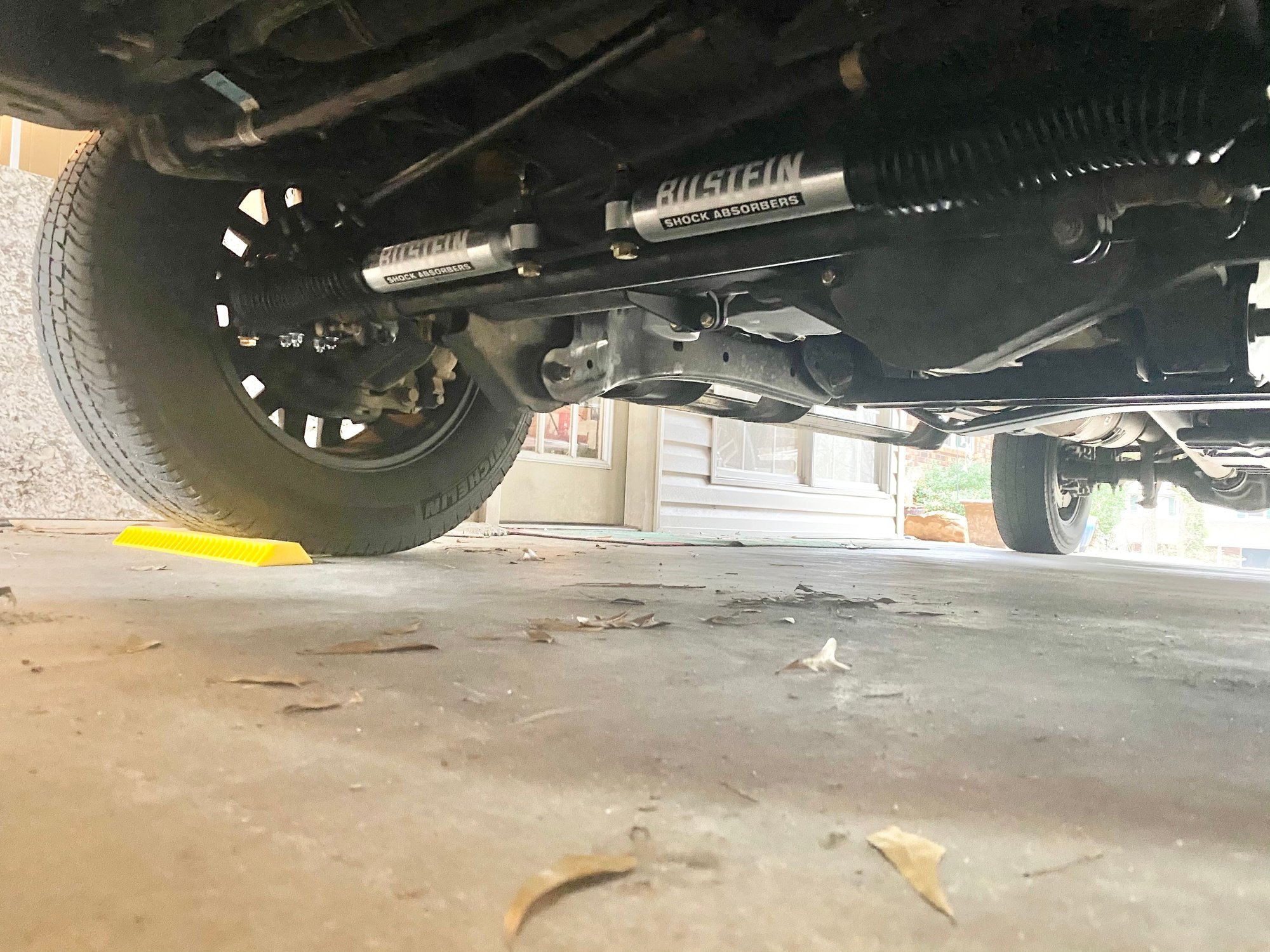

I had the PMF with Bilsteins on my 2011 F350 at stock height without any issues. I plan to get the same again for my 2020 F250.
For those of you that went with Fox or King shocks, what made you choose the more expensive units? Being as this is for steering components which see much less 'activity' than suspension I am curious about your choices?

For me, it was purely aesthetics. I have Fox 2.0 shocks and I wanted the stabilizers to match. That being said, I know they are a top notch product and I was willing to pay the premium.

Well I went with Fox because PMF said I had to. Said they need at least 10"-11" of stroke for the dual stabilizer. My case is unique though. My truck is an F450 but I am currently swapping over an entire 2006 F450 suspension and axles. So my front end is a wide track Super 60 with high angle steering. I know Bilstein has long stroke shocks that would probably work but I figured I'd pay the $80 premium and just get the Fox's that the manufacturer recommended.

simple blistien 4600 worked fine on my 2010.
they were take offs from the rear position.
they had the exact shock strut travel needed

If the Bilstein leaks you throw it away and buy a new one. If the Fox leaks you buy a seal kit and rebuild it.

I decided on the dual after seeing where the stock SS is. There are quite a few links between that and the road, and for only one shock to handle. The dual SS puts the shock close to the bottom of the components, making the job of protecting them more efficient.

This is the way I saw it, stabilizer should be connected the what it is suppose to stabilize. I went with the PMF with the Bilsteins, stock '19 F250, plow package, 275/70/18...no regrets, big difference.

I got the product installed, and I love the way it handles now. I appreciate all of the responses/opinions/advice.

I'm convinced it has to do with the larger tires. My f250 w/275/70/18 had bump steer until I installed the PMF Dual Stabilizer. My f350, same coil spring front end, has 245/75/16, never wobbled or experienced bump steer, stock, both trucks are 4x4 with plow package.
