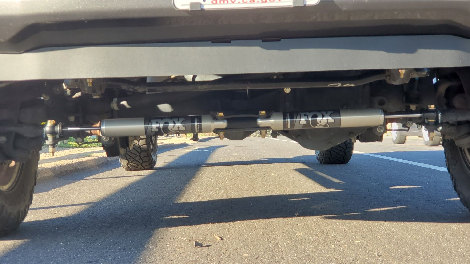

I just installed the PMF kit with Fox stabilizers a couple days ago. Very easy install. It mounts below the axle for stock height up to 3 1/2" of lift. Any more than that and you have the option of mounting it on top of the axle. I had the BDS/Fox dual on my previous 2005 Super Duty. The PMF is definitely more stout.
