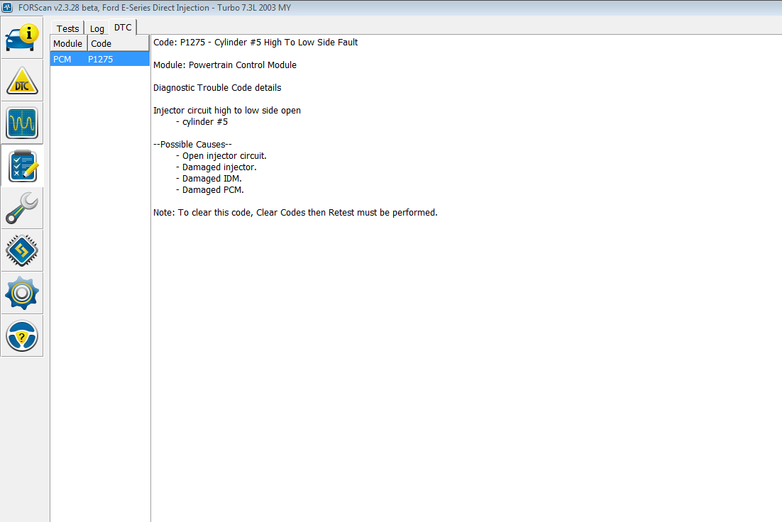

Update; got a laptop/cable and ran a buzz test. All injectors buzzed loud and clear, but it failed the test due to one injector pulling a p1275 cyl #5 that alone has made me love forscan already first try. Anyways is it safe to assume #5 injector is just tired and worn ? I still have the original injectors with about 300k miles on them which is why am assuming it is the most likely, when I bought this vehicle it had massive oil leaks and one valve cover harness was also toasted. I replaced it with motorcraft stuff and it ran much better, I also resealed everything in the upper engine, and the whole nine yards, then I started noticing a slight idle up and down barely noticeable at first then almost 100 miles later it got worse, after warming up the truck would idle erratic and I started hearing the Tugly loose injector knock,but it could have have had it before, and i just didn't notice, I'm getting better at what a healthy 7.3 should sound like every time i drive it, i get more in tune with it if it makes sense. I havent gotten around to retorque them, but I will do when I get back in there, knock can be heard in my first video in first post. I dont drive this vehicle for the time being, so my question to you guys is assuming none of the wiring is chafed would it be a safe bet to assume its a bad injector based on that? Or should I keep digging. I don't know if I want to swap injectors around as I would have to replace the seals because I wouldnt trust to re use those 300k mile seals in a new hole. I guess am being a little greedy as I want to enjoy this beast atleast a bit before it tears a hole in my wallet again, already spent over 1.3 just doing preventative maintenance and resealing things new turbo etc... which is why I say that. Thanks for reading my ramble.

I forgot here is a quick shot, My icp and hpop seem to be within spec so I guess this is my new problem now that icp is ruled out.
