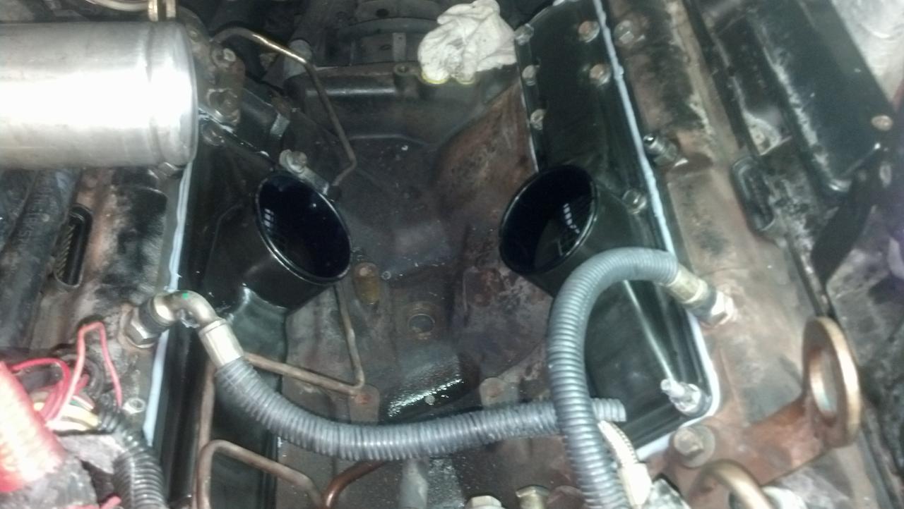

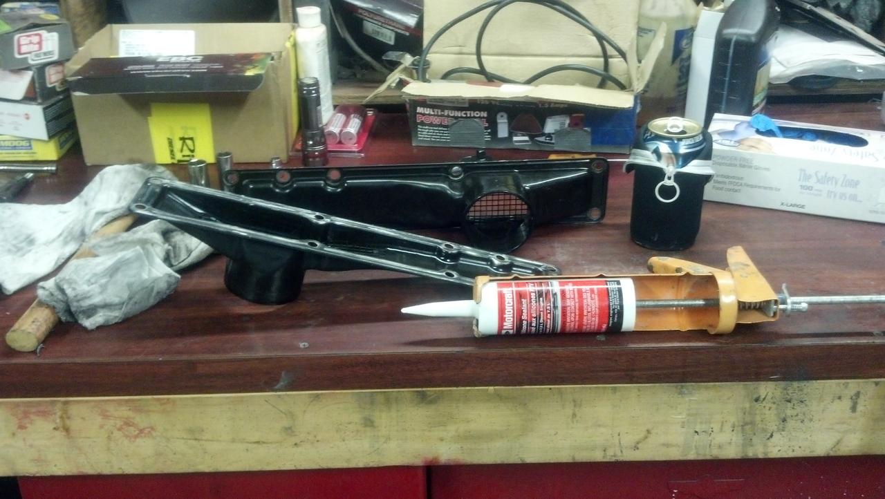

Originally Posted by ronjon95
Got them off,cleaned up and reinstalled last night!
Attachment 73003
Attachment 73004
How did you clean the plenum and the motor? Solvent? Did you use the dremel tool to get it off? I noticed a leak the other day and I"m trying to gauge if I should take it on. I've only started working on this truck 1 1/2 years ago.

on edit: After removing plenums, I stuff a towel in each head to collect debris, then scrape most of the old sealant off with scraper tools. Then a wire wheel on a drill and finally solvent (brake cleaner). Vacuum as much as you can before removing towels and then vacuum intake ports for good measure.

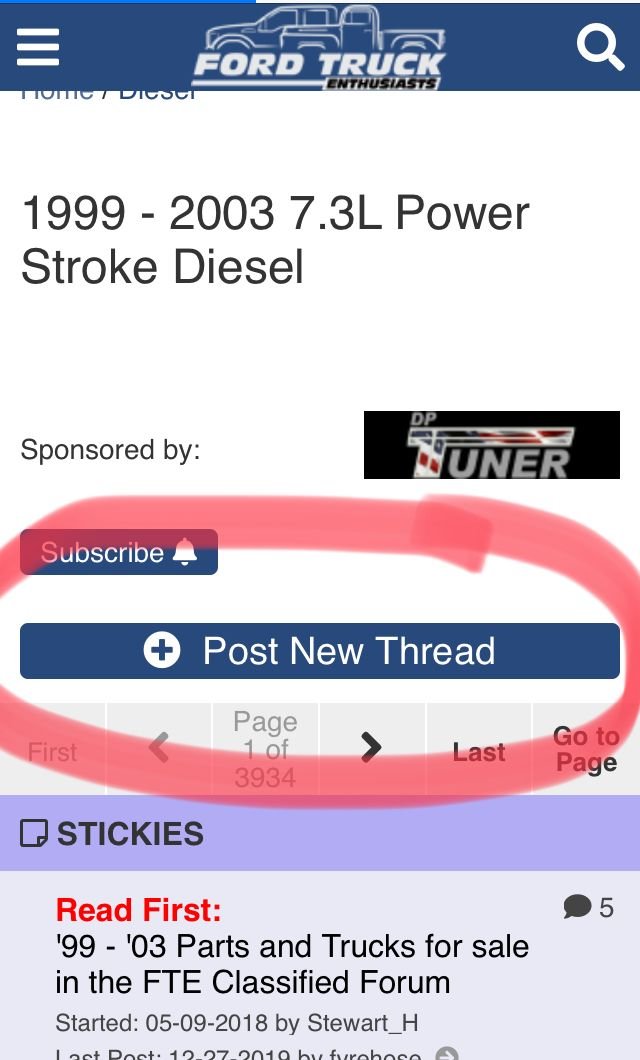

Ok, I have some suggestions - will you start another thread about your truck so your symptoms and repairs can help others?

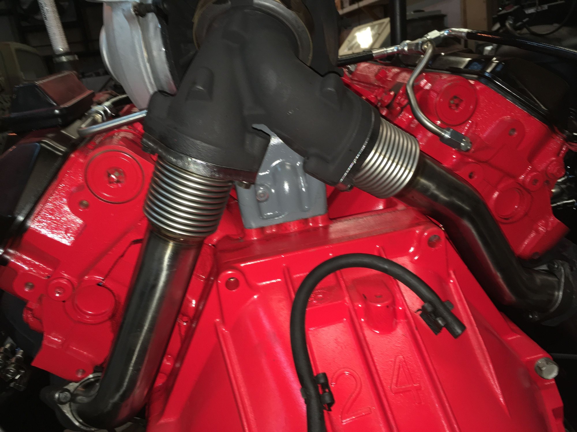

I’ll post again in ‘your thread’, but drive pressure (up-pipe) leaks are the most common reason for these trucks to lose power and MPG while making higher EGT. The oil on and in boots is normal.

I don't know how to start a thread. I was however in there on a start up the other day and noticed a little smoke coming from back where the turbo is. Not enough to identify where it was coming from exactly and it stopped after a bit of running.

From the 99-03 sub forum click on ‘post new thread’.
Not sure what that looks like on PC. @Sous can be more help there.
Smoke under the hood at start-up is likely from leaky up-pipes.
You’ll want to change them with a bellowed up-pipe instead of the donut gasket failure prone Ford version.
Like these.

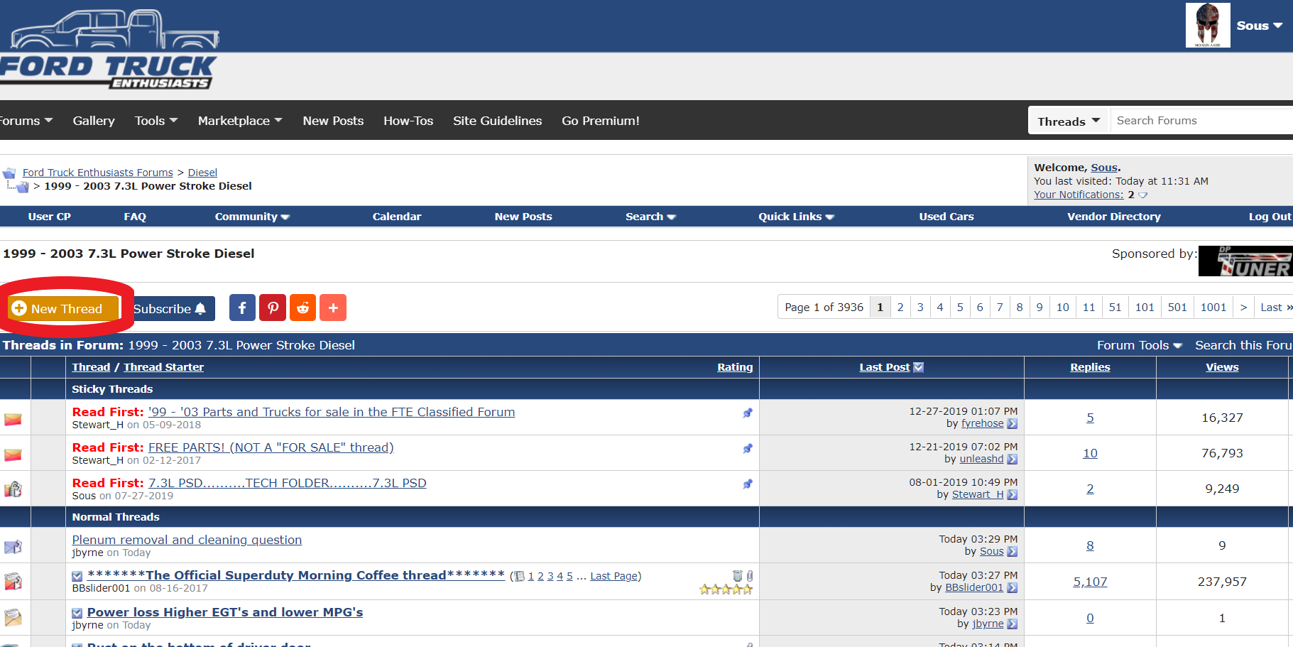

@jbyrne , I have moved your posts in order to create your own thread. I have also tagged @ronjon95 because your original question was asking ronjon95 how he cleaned the plenum to block surface after it was moved. The original thread can be found by clicking here.
In addition, if you are on a PC you can create your own thread by by clicking the "+ New Thread" orange/yellow button at the top left of your screen and as seen below circled in red.
