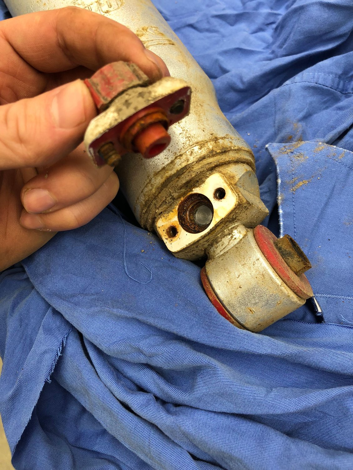

I and multiple members recommend greasing behind the adjustment ****, especially with consideration to the climate your based in. The plunger rusts and seizes, then people
wonder why it won’t turn and begin to use force until the plastic **** breaks. Take the small Allan head bolts out, throw some grease behind there and work it in. This was a front shock, Rancho replaced both under warranty. Prior to sending these back, I experimented to see if I could break it loose and after soaking in WD40 and using a small socket, I was able to.
Info sharing!
