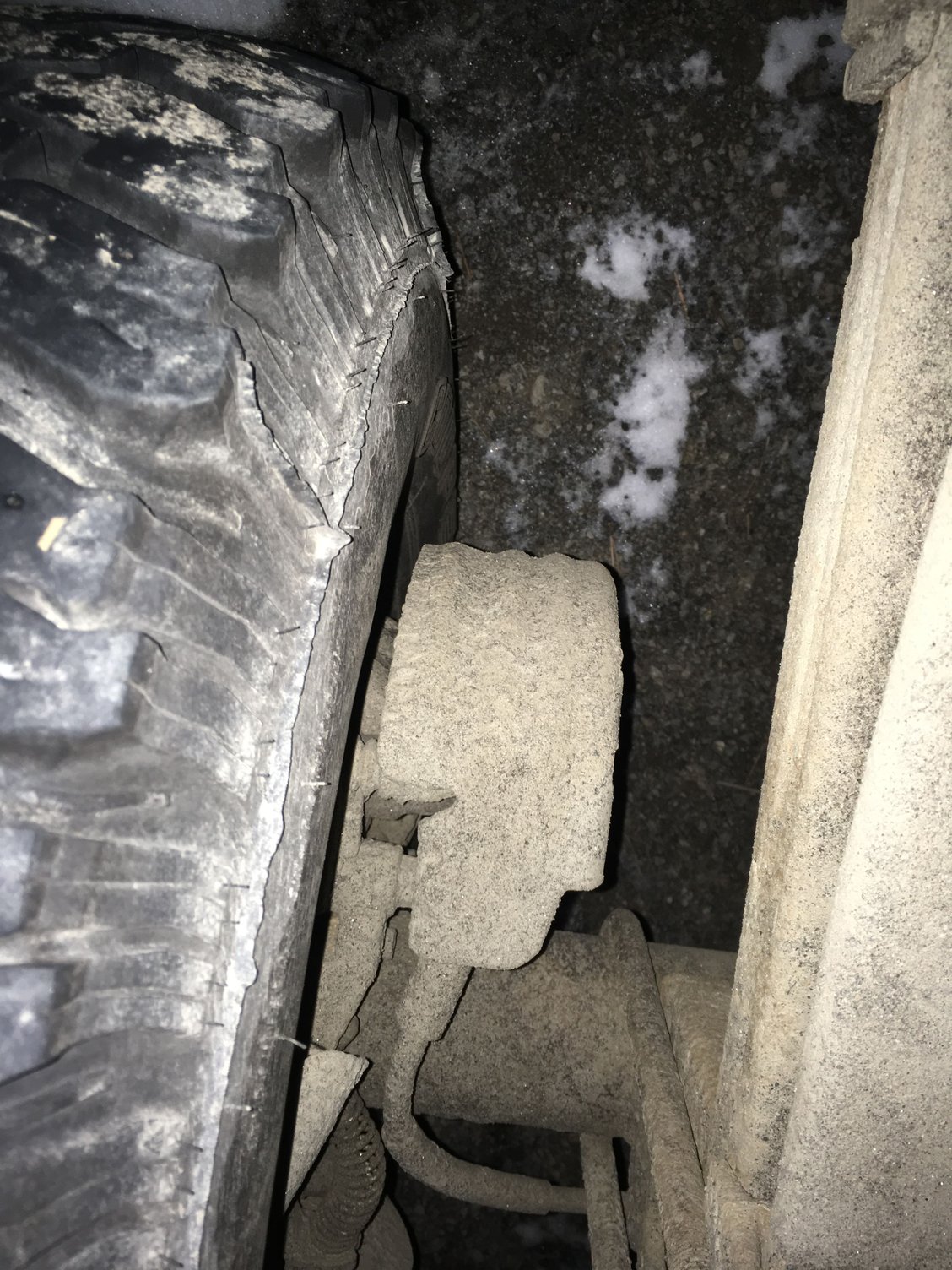

Question about left/rear caliper
I noticed something recently that got me thinking, and then another thing just a couple days ago. My truck is on it's third rear driver's side caliper and I've owned it less than 3 years, while the one on the passenger side has never seemed to be a problem. What I noticed however, is that one sits behind the axle, while the more problematic driver side mounts to the front side of the axle, I assume getting blasted by water/salt/road grime worse than the passenger side, and probably explaining the high failure rate of calipers on that position. However a couple of days ago I had mom's E99 over to the tire place for leaking valve stem, and I got to looking closer at the rear axle. There is a splash shield totally covering the caliper on the driver side on her truck! Is this a part that just went missing on my truck at some point? (The passenger side on hers does not have one). I can not seem to find this part listed on the online parts catalogs such as Tasca or Ford Parts Giant. Anybody know anything on this?

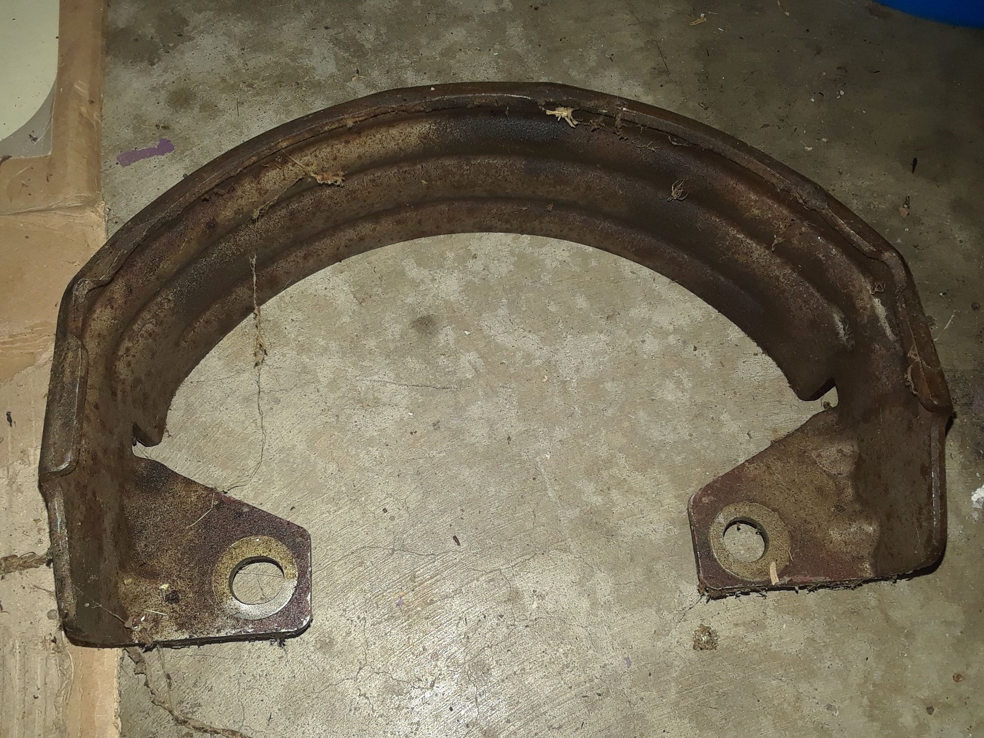

I'm thinking he means this part
About 3" wide
About 3" wide
That appears to be it.
Anybody got a part number for this?

I couldn't find the part number but I found this:
https://rover.ebay.com/rover/0/0/0?m...2F273941801288
Cool I'll probably pick that up. Thanks for finding! I have a Dana 80 DRW but I am pretty sure it is the same caliper and hardware. Those bracket bolts look identical to mine and I cold not figure out why they had extra threads sticking out the end of them but now it makes sense. I'm assuming somebody took it off mine and didn't bother replacing it.
