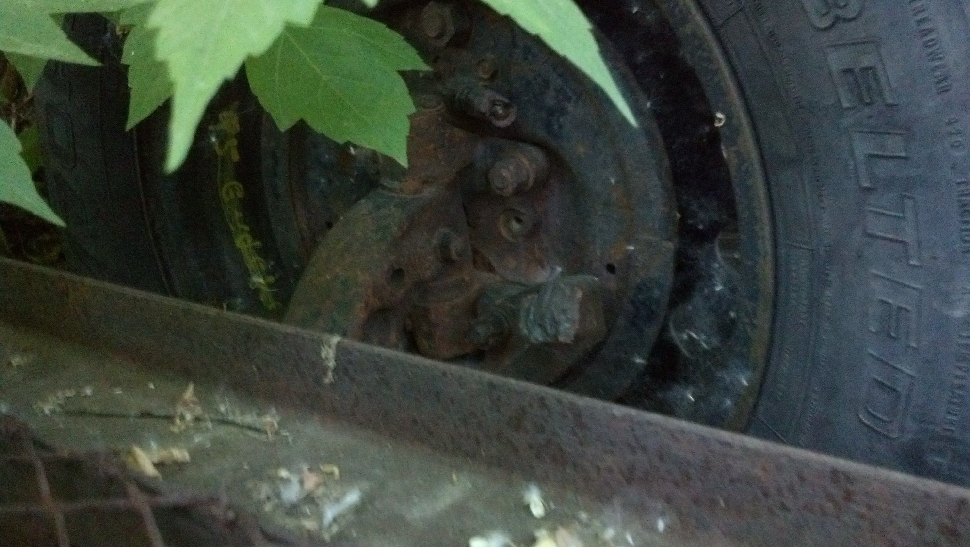

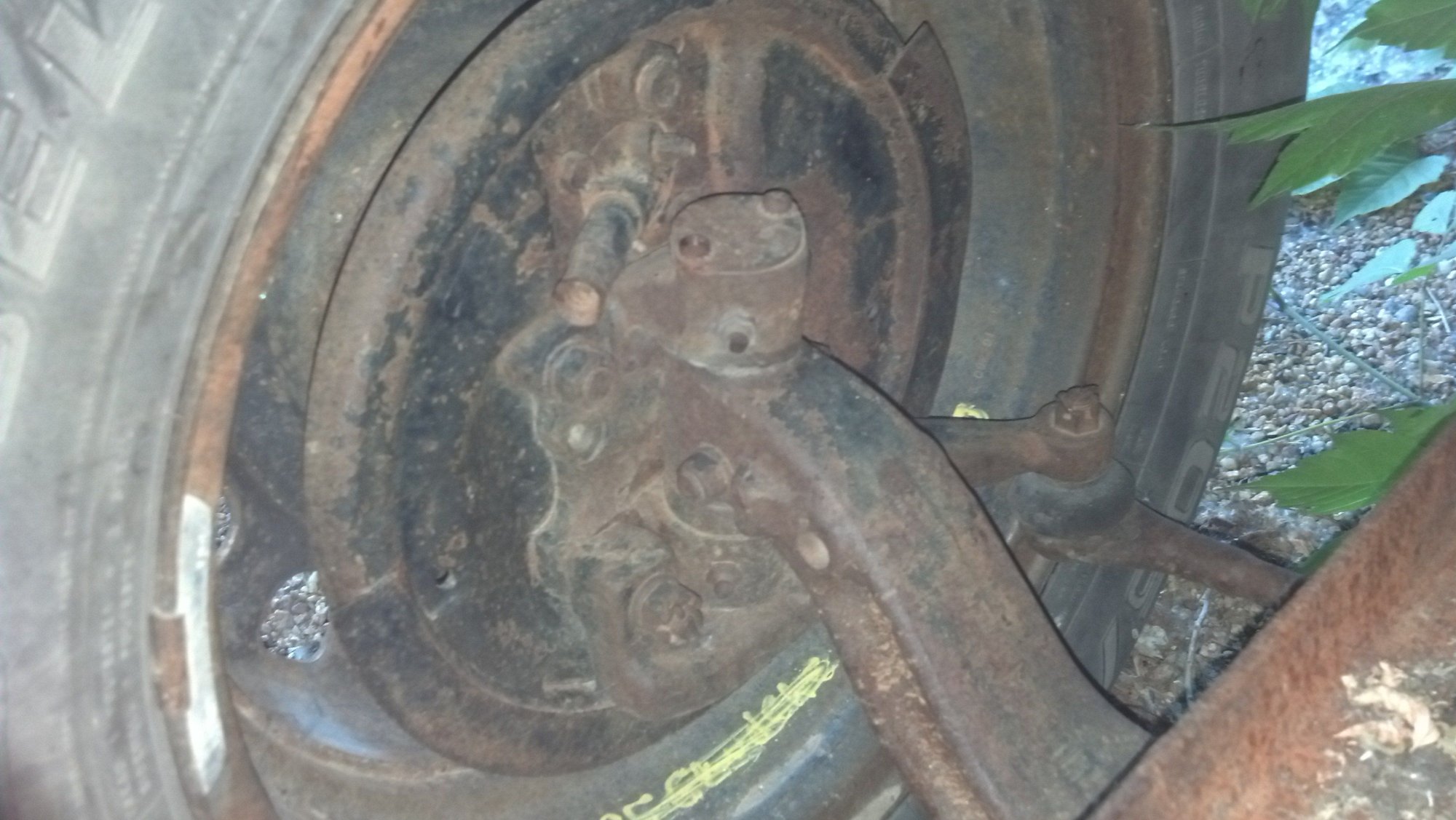

Does anyone recognize the axle in these photos? I have a homemade trailer that was constructed using the front end from "an older ford truck" (what the seller told me years ago). It was in a flood recently and now has a bent hub. I'd like to replace the hub but have no idea what year it is so I thought I'd start in the 67-72 forum and work backwards. Any help would be appreciated!

Welcome to the site.
If it is a straight axle, then it would be older. Twin I beam started in '65?(something like that).
I know the '67-up have thread in caps for the king pins, not a bolt on cap.

You may need to go back further, the 57-64's didn't have caps just an O ring. Maybe 53-56?

What is the engineering ID number on the axle? Look underneath and find out. Does it start with an A or B like B3?

Thanks to all so far for the help. I will see if there is a visible engineering ID number and also start looking at pre-'57 years.

Finally got underneath and found the following number: 3892504 GM41

It is some kind of GM axle. Not Ford. Looks like GM axles used 3892504 and then the “GM” part was a version.
See here https://droppedaxles.com/chevy-dropped-axles-0
Also, Google searching may help.
