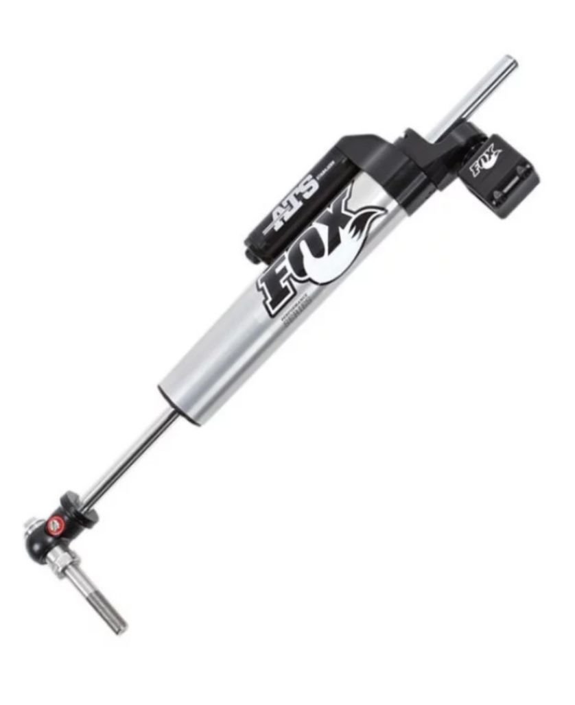

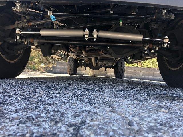

I put the Fox TS on my upper and the Fox double on the lower. Works great.

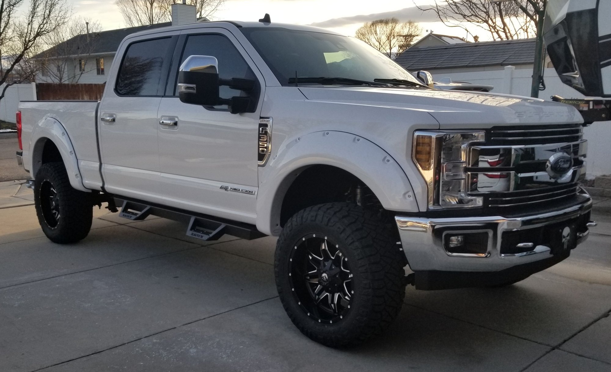

When I drove my truck home from the lot, it was stock and tight. The next time I saw my truck it had a 2" Level Kit and 35" x 12.5's. Obviously it didnt feel the same. Once I added the single and double stabilizes, it tightened right up and feels great now.
2019 Lariat Ultimate F-350
