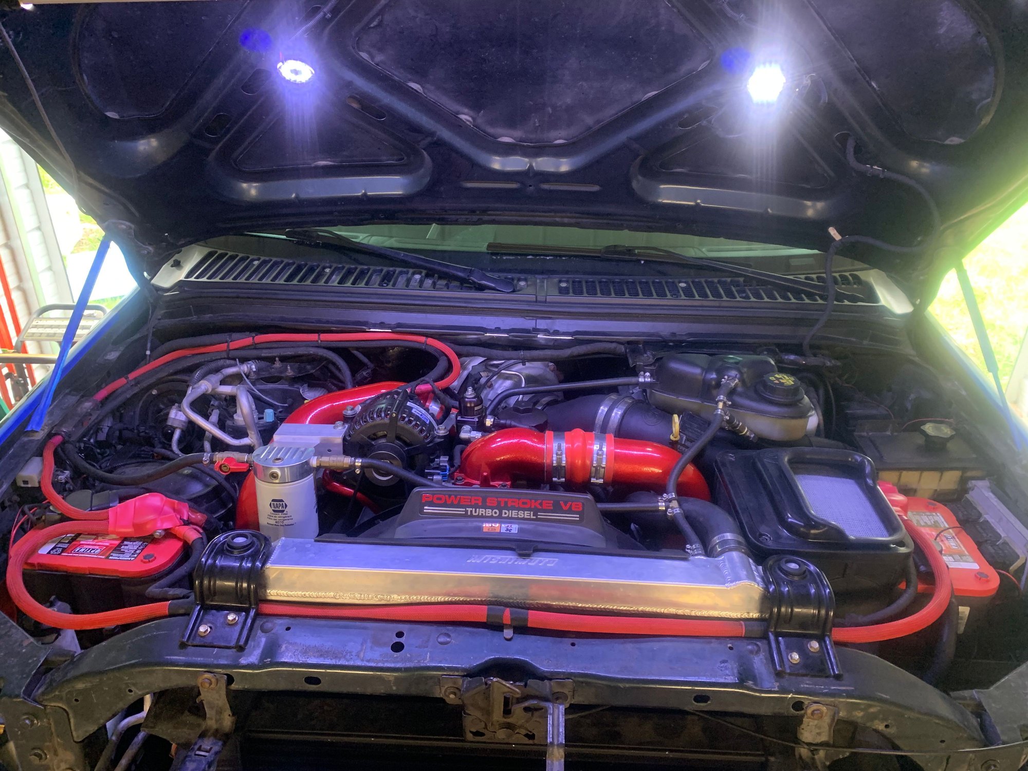

Even with the S&B I was getting the filter minder light on the cluster so I removed the lexan cover and drilled a bunch of 5/8” holes in a grid and covered it with some fiberglass core nylon coated solar screen to maintain flow while keeping leaves out when I open the hood.
You can see it in this photo
