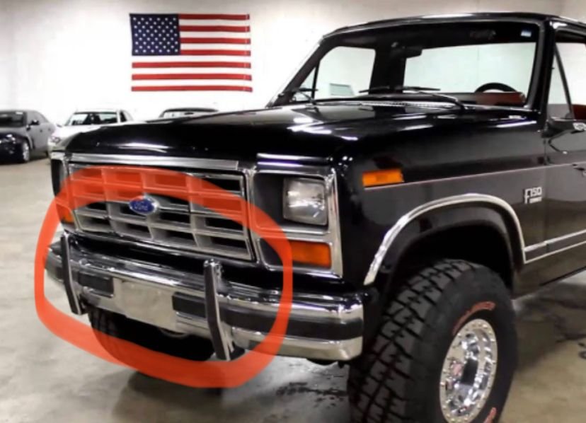

Hello all! I keep trying, and failing, at removing the push guards on the front bumper. I really like the look of them so I want to slap them on my 86 but my word removing them has got the best of me. I can’t ever get the nut to break free without the whole bolt just turning and I can’t get a grip on anything to hold the darn bolt! I was wondering if any of you guys have tips for removing them or maybe someone has some for sale?

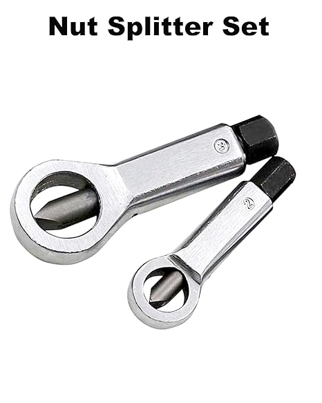

Can you get a nut splitter on the nuts?

I got a nut splitter from NAPA for this job, something like this:
