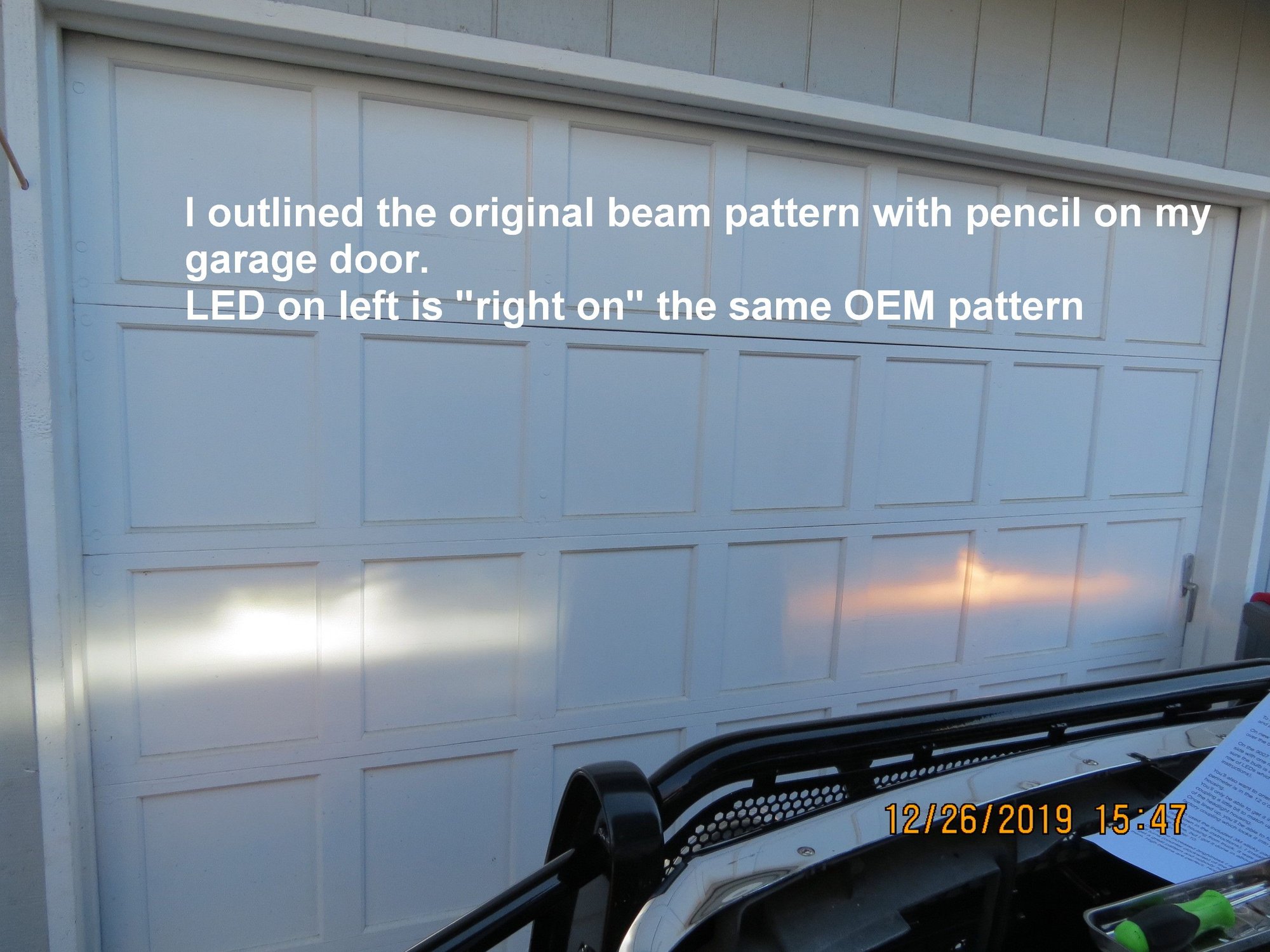

Wheelnon is absolutely right. LED's have not come close to equaling good Halogen bulbs. There are some well known websites that compare Halogen 2007 bulbs like "Candlepowerforums.com"
So I have tried every "brighter" bulb like the Sylvania/Osrams, Phillips Extreme, and GE Nighthawks. But the LED aftermarket has been known for good low beam brightness, but dismal high beam brightness. FWIW, I drive 1 to 1-1/2 hours every night to and from work on winding 2 lane roads and need good vision for safety, so this has been a "mission" of mine for many years to find brighter bulbs without blinding oncoming traffic with those HID conversions that do not match the filament depth in our headlamp housings.

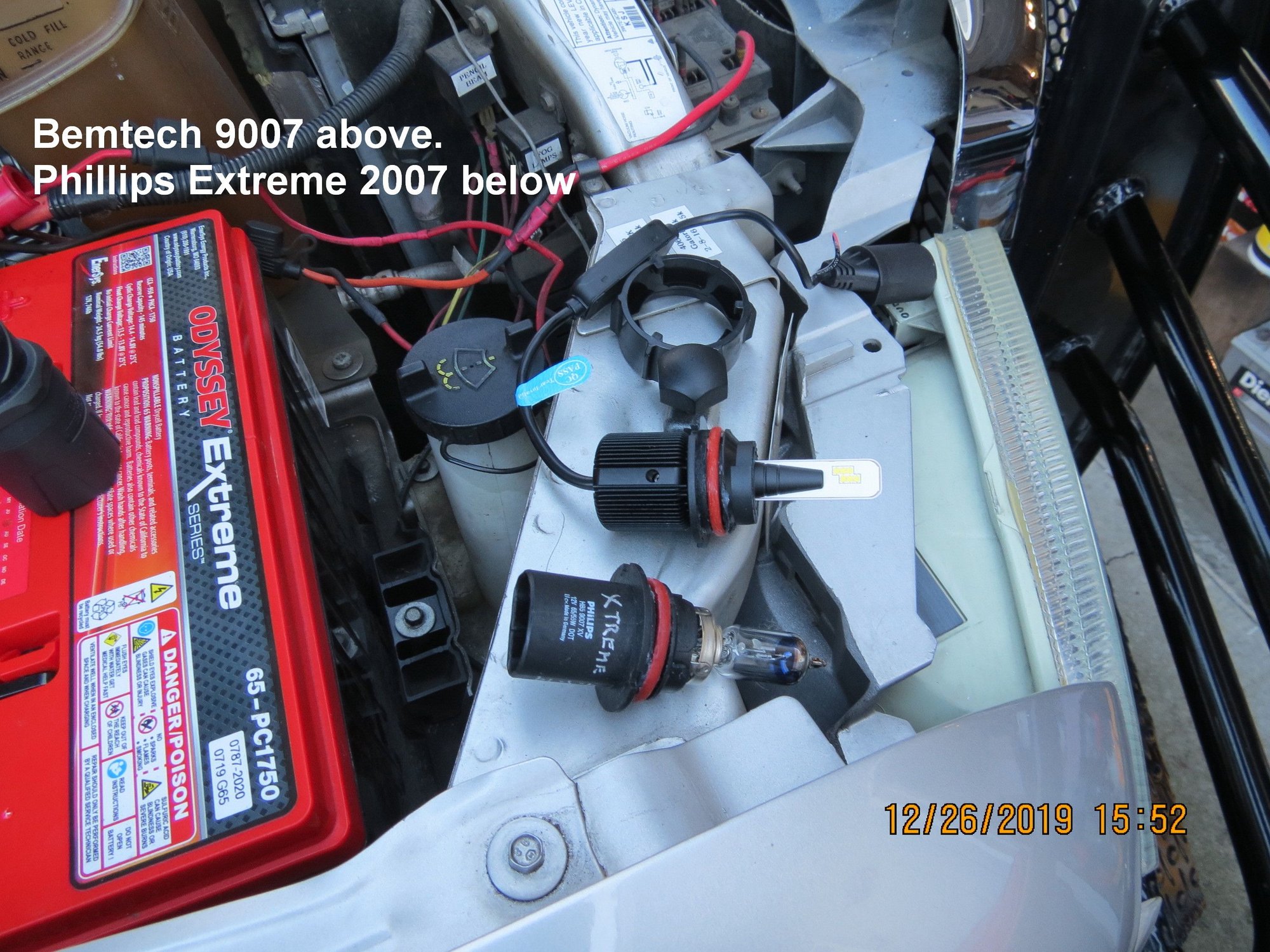

There was a poster here in the FTE forms that said he got great results with Beamtechs and I decided to give them a try at only $40 for a pair of 9007 bulbs on Amazon.
The results were VERY noticeable, not just a slight improvement ! For those of you who know How bright Rigid "D" series pro cubes are (and how much they cost, ouch!) , these are almost as bright on high beam. These are designed with the LED elements in the same positions as a stock 2007 bulbs and I checked the pattern on my garage door before driving with them. No one has flashed me yet.
After more than a decade of trying many bulbs, these I can highly recommend. The photos are of my 2003 Excursion, but I also have these on my 2007 E-450. See for yourselves . . . . .
LED matches stock 2007 bulb pattern
Bulb comparison

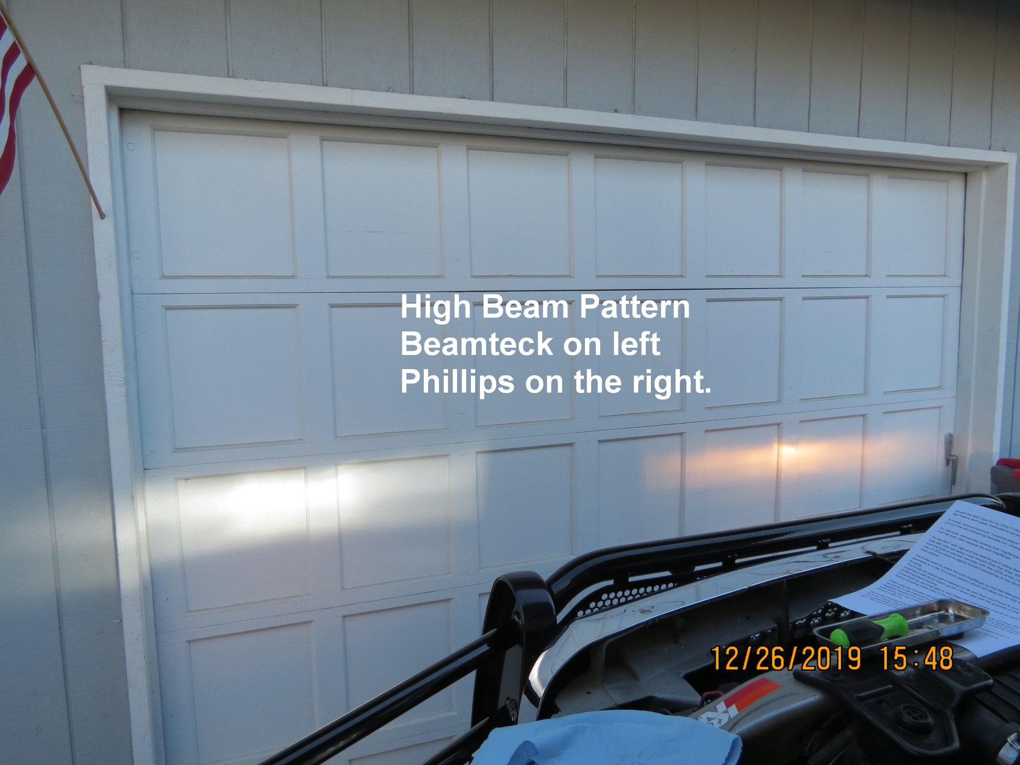

This is a photo of the high beam comparison with the Beamtech on the left and the Phillips halogen on the right.
Finally an LED bulb with a bright high beam !

^^^ First report [after a night ride] - WOW!
The light is much "whiter" and brighter than the Halogens (I think that I had the same Phillips ones that you had). The key is the beam pattern, which - as you noted - looks unchanged.
Very impressive results - thanks again for the tip
And the price is great, too.
The plugs don't seem to fit very well, did not seat against the rubber seal... but that can be addressed by some other method.
