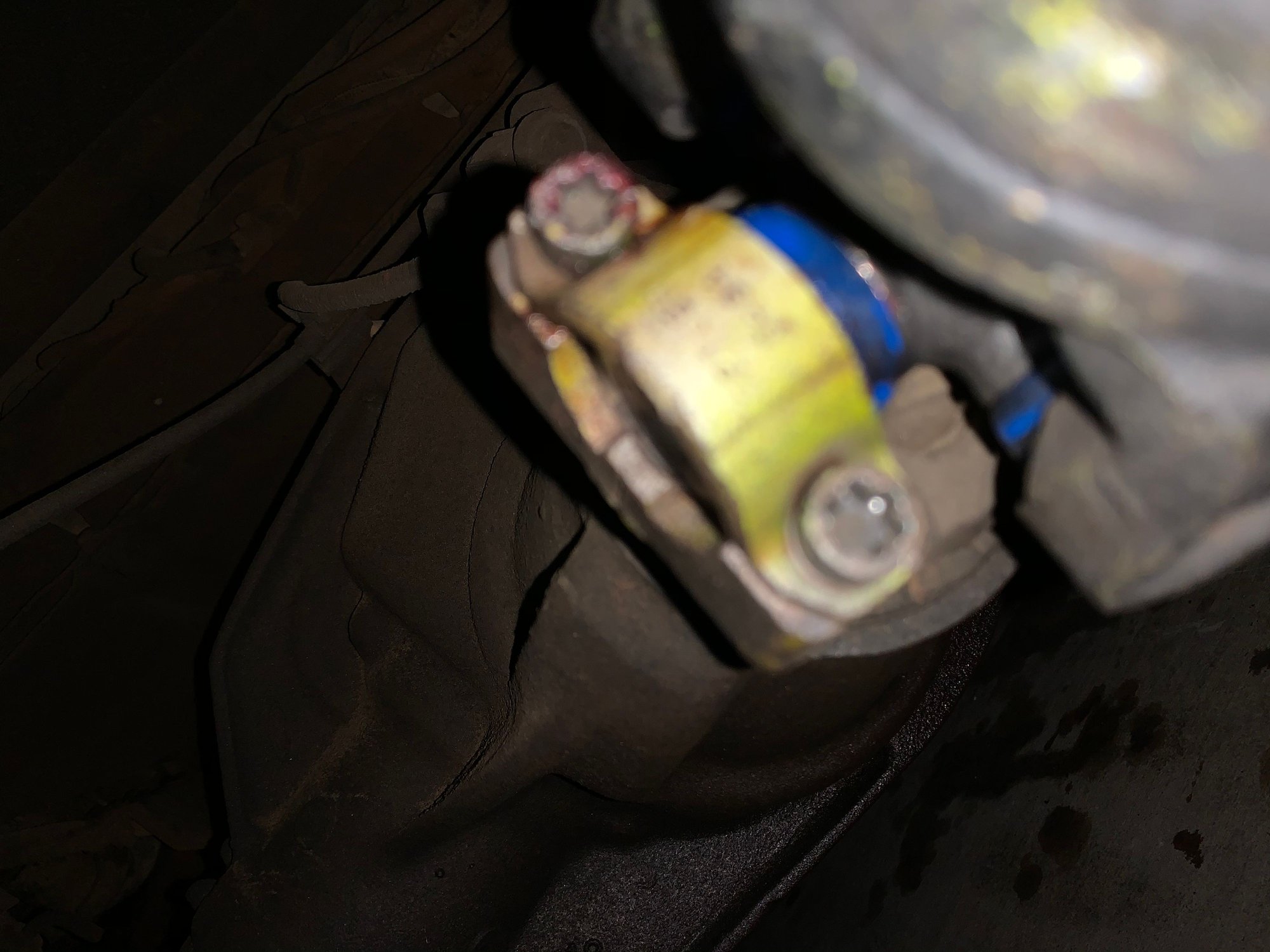

I’m new to the form guys .I’m im having some issues I recently have been chasing down a mixture of vibrations and a slight shake I just able to get my truck back from home iv been busy with military stuff so I drove it cross country and didn’t realize how bad my truck drove ! I start to get this vibration/shake going at high way speeds it will start to be noticeable around 70+mph and gets worse I’ve replaced worn drive train components like new tires and rims , rear brake rotors, ball joints ,carrier bearing and just had my drive shaft straighten and And rebalanced with new u-joints the drive shaft repair helped a lot but it still has this slight shake and vibration going hwy speeds it’s really aggravating me I looks under the rig last night and saw that there’s a space in-between the u joint caps and the diff yoke kinda hard to see in the pictures don’t know if that would even be enough to throw it off center line ?I don’t know if this would be contributing to this issue my truck is giving me or anything else it could be ? Transmission mount ?pinion angle ?possibly bad alignment? I’m clueless right now any help would be great !

I had a issue with this on a truck I tried several different brands of ujoints it all boiled down to. The rearend yoke was wore and allowed side to side movement.

didn’t think to check it thought it would be done right by the tire shop turns out the rear tires were at 40psi so I got them inflated and I’ll have to drive it tomorrow
was it those tabs where the u joint caps sit that was wore out ?

Yes tabs where wore out cause side to side play I have seen where people have pulled the caps and installed a dime in each end inside the ujoint caps. To get rid of the play I wouldn’t necessarily suggest that but if you where in a situation where you needed to get home I definitely would. Because side to side play could cause it to potentially fly out.
if I have to end up replacing it how hard would it be to change the yoke bearings or should I just leave it alone

Personally I’d just pull it throw a new seal in and install new one Loctite the nut and torque to spec.
