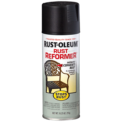

During this curing waiting period, I ordered a 6-pack case of Rust-Oleum Rust Reformer black primer. I used the water-based (no fear - they're water based solvents) version of Rust Reformer (there is a oil-based version too, but it's made to be used with traditional oil-based Rust-Oleum paints that many people avoid for automotive use). So - after letting my truck sit about a week during the converter drying/curing process, I then went around and sprayed the entire perimeter with a few coats of this flat black primer. This primer also has a type of rust converter within it along with a nice flat black primer. This all really came out well. I've used well over 100x cans of this over the last few years for all sorts of projects and really like it. It's fast-drying and it's sandable and seems to hold-up pretty well. Late this fall, I primered the entire truck with it and (as expected) - no problems at all.
https://www.rustoleum.com/product-ca...rust-reformer/
So this is just where I left off a few weeks ago - this is as far as I got before stopping for the current holidays. So far so good. It's now Winter here and getting pretty cold so am not sure how much more I can do until Spring. But we've had some reasonably warm days lately so I may be doing some more work (I'm also re-sealing the drip rails with 3M seam sealer (I also used Rustex & Rust Reformer there too first, came out nice).
TIP - or should I say "tips" ? As in "spray tips". My very next step is goint to be to use the Rust Reformer primer again, but this time with extended reach tips made for spraypaint cans. I did a lot of research and reading a few weeks ago and even made a few of my own custom spray tips . . .
