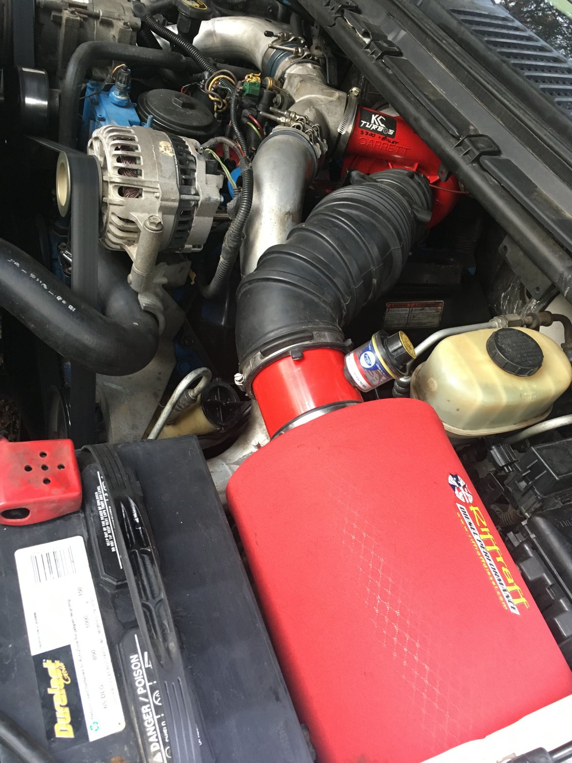

First, let’s talk about the air filter. I think there is a common misconception about the stock filter. Let’s clear that up. The stock filter flows and filters very well and does not affect performance of a stock or slightly modified 7.3. However, the stock air box is often broken and/or not assembled properly - rendering it ineffective at preventing dirt from getting in the engine.
The AIS is by far the quietest and the best filtration of any other option, but really only flows enough for a stock power truck.
The 6637 style filter is easily the best bang for your buck both upfront and replacement filters. It also flows and filters adequately for almost any HP you can make with a 7.3.
S&B closed filter is a great option for a bit more $$. It will be significantly quieter than the 6637 style filter.

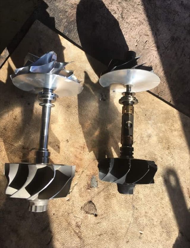

So this KC wheel and shaft set up go right in a stock turbo? And you have seen EGT's go down? That would be good new when towing.

Joined: May 2014
Posts: 27,352
Likes: 5,946
From: Lake Hartwell, GA
FTE Emeritus
@Wesley Green has been running the KC turbine with a couple of different compressor wheels and some towing. I think he had a 4/4 and now a 7/7 and he has a thread out there somewhere about it and his thoughts.
I put the KC 300 turbine wheel and 6+6 billet compressor wheel with extended tips pictured above next to stock parts in a truck with .84 exhaust housing and fresh 160/0 injectors.
Very impressed. The turbo spools like stock and cleans up the 160/0’s easily in the hottest tune. The owners pull a big 5ver full time around the country and LOVE the extra power. They went from stock, tired injectors and stock turbo with chip and gauges to this. EGT’s are lower across the board and nearly impossible to put in the red. The truck is a 4R100 with 4.10 gears.
Jason, so both wheels are from KC? I might have to give this a try before going to the T4. Only because I am in California and it would be easy to pass smog. How loud is that 6x6 wheel? I don't like loud turbo's. I did up grade to the S & B intake from Clay. Thought that would help but it didn't. My 5th wheel is about 12K unloaded and as much as 16K loaded according to the trailer paper work. I am planing a cross county this summer and it would be nice not to have to worry about EGT's all the time. I have no leaks in my intake. But the stock turbo with 1.0 exhaust side and a WW. I believe the other guy said RR 4x4 wheel.
