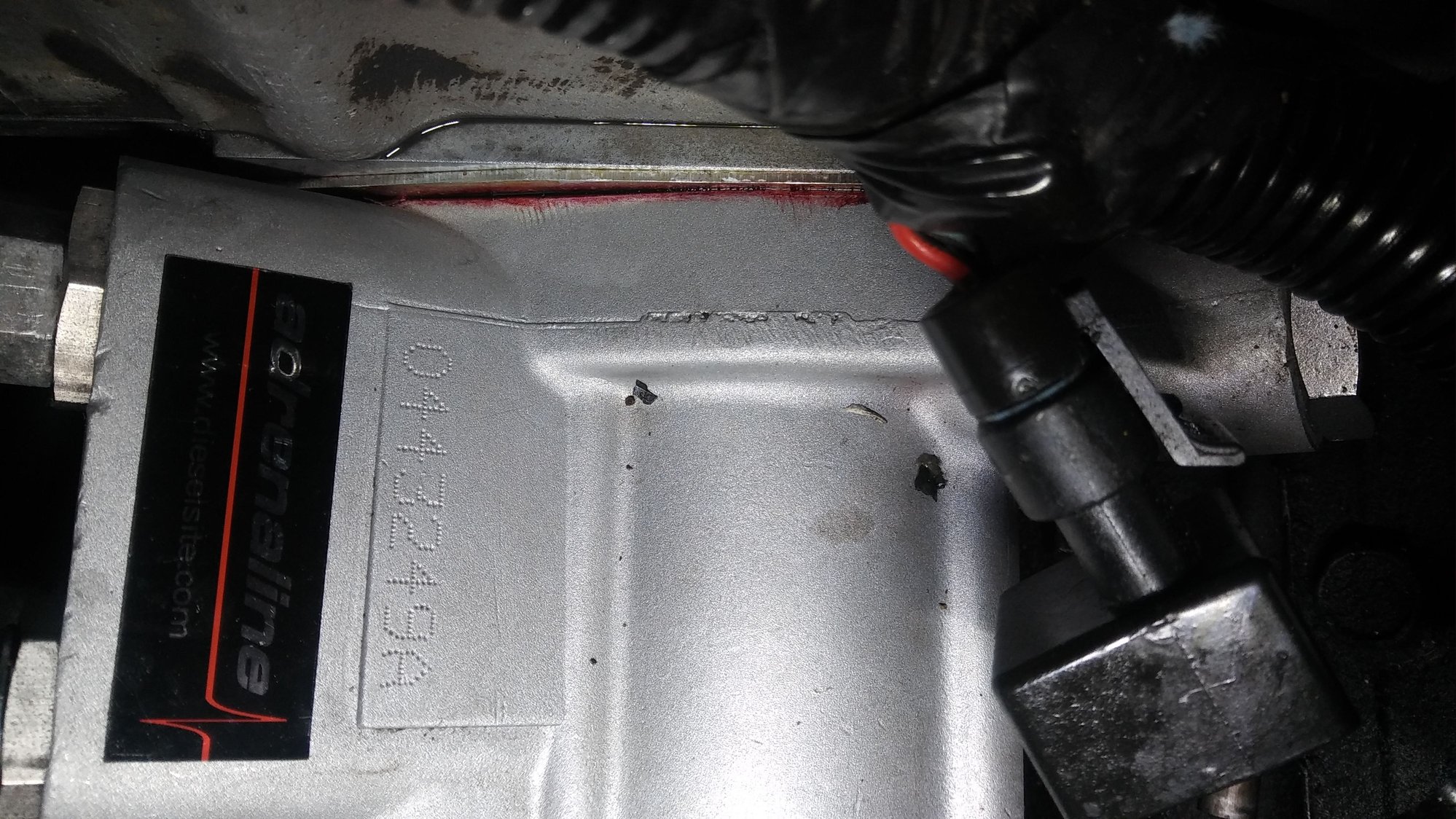

I cant seem to solve this leak. Here is what is going on. That is a new gasket and this time it was torqued to 20lbft. This is the 6th time I have tried to reseal this gasket. What else could be causing that to leak. I'm about to slather my gasket in grey right stuff RTV.

From this angle it looks like theres gap in between the gasket and HPOP, and appears that the HPOP looks to be at fault?

There is no leak between the HPOP and the front cover just between the gasket and the reservoir cover. I can see the air being purged from underneath. I watched bubbles being pushed out. AE shown a nice stable 600 or so psi at idle and DC is around 11%. The wetness you can see in the picture is just sitting at idle after bringing up the oil pressure it runs out much more.
