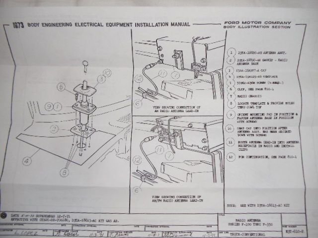

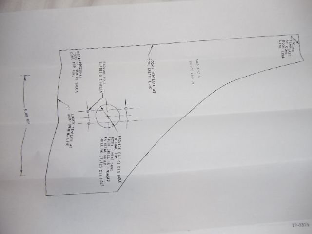

Back in the day when you bought a radio over the counter, they came with a full size template to show where to drill the holes. Unfortunately there aren't any dimensions for the hole locations.

So you all think my hole was drilled wrong. Ugghhh I really really want to use the factory style base. I guess when I get home I’ll look down it and see just how far over it is, it wouldn’t kill me to just buy another smaller based antenna but dang I was excited. In other news I figured out the 76 am/fm radio has gone kaput. So I’ll need to buy s newer unit any way.
Does anyone one know how I can view the picture of the template a little clearer? I can’t make out what it says.

Since they're at full size already and clicking on them would not do anything, the only option (other than Mike uploading higher resolution images?) would be to right-click on each one and "save image as" to your computer. Then open it up in your own screen and see if you can enlarge them without so much distortion that you can't read the text anyway.
Hmm, let me try it right now. Quicker to do than to describe sometimes!
BRB...
Paul
Old Dec 17, 2019 | 02:45 PM
1TonBasecamp's Avatar
1TonBasecamp
Joined: Jul 2017
Posts: 9,601
Likes: 1,174
From: San Jose, CA
Just barely more legible.
If your eyes are not that great, you could try reading glasses and not enlarge it quite as much. But as soon as you get it to the point it would normally be easier to read, the words are just too blurry.
Good luck though!
And maybe Mike has a higher-res shot he can e-mail you.
Paul

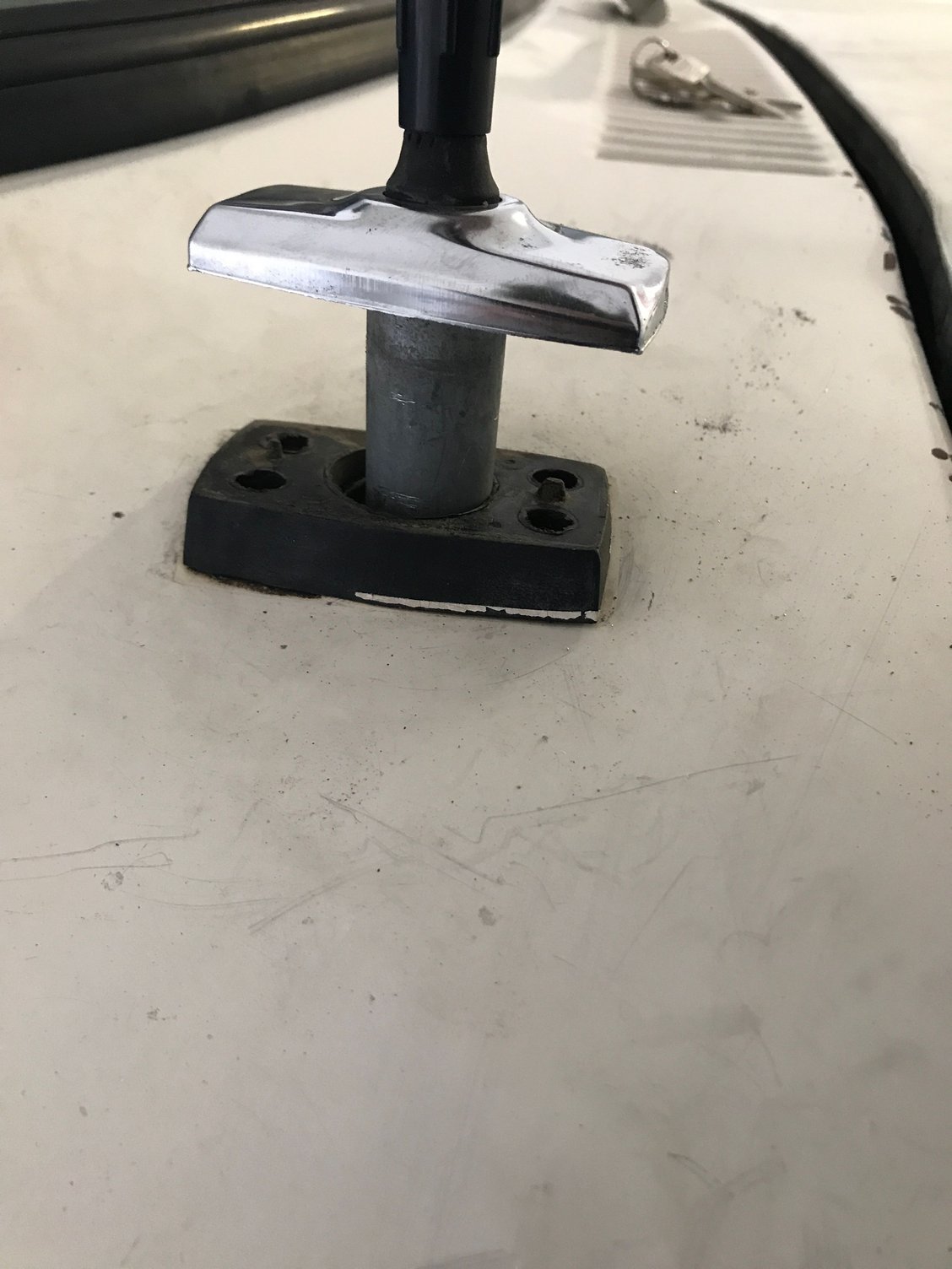

I ran into the same problem on a 1979 truck of the hole being slightly in the wrong place and interference underneath. To SOLVE it I added a second stock black rubber base piece to get a little more height, the antenna stands straighter upright (or leaning in to centre of truck when viewed from in front of truck) but it screwed in with 4 longer screws and works fine being a stock antenna but having 2 black base pieces under the chrome trim top piece.
Ditto. A friend also did that to mount the antenna.
