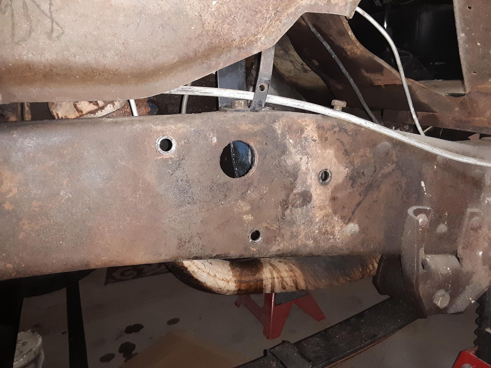

I agree with the to many holes. I was going to weld up the other holes and start fresh. Was going to add two gussets from the top of the frame to the bottom if needed. Fabrication is my strong point. The reason I am looking at a kit rather then piecing it together is time. Matching Ford parts is never easy, especially when you don't have time to run to the salvage yards and it is 20* outside. I want her truck out of my as soon as possible so I can work on my car.

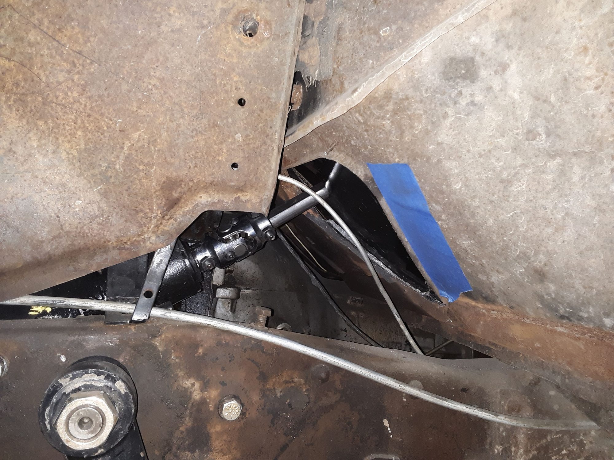

Well we installed the kit that I purchased and would not suggest this kit as an option.
If you can locate the box itself, buy one and build the system yourself.
The first step for me was getting the box installed. The box comes with spacers to space it away from the frame rail about 3/4". Due to the big block that is in the truck the box needed to be installed flush against the inside of the frame rail (This would be the best option regardless of engine).
I trimmed the top rail back about 1/2" to get the box flush on the rail.
The mount plate supplied did match up to my hole pattern on the frame unlike wcs69rat's setup.

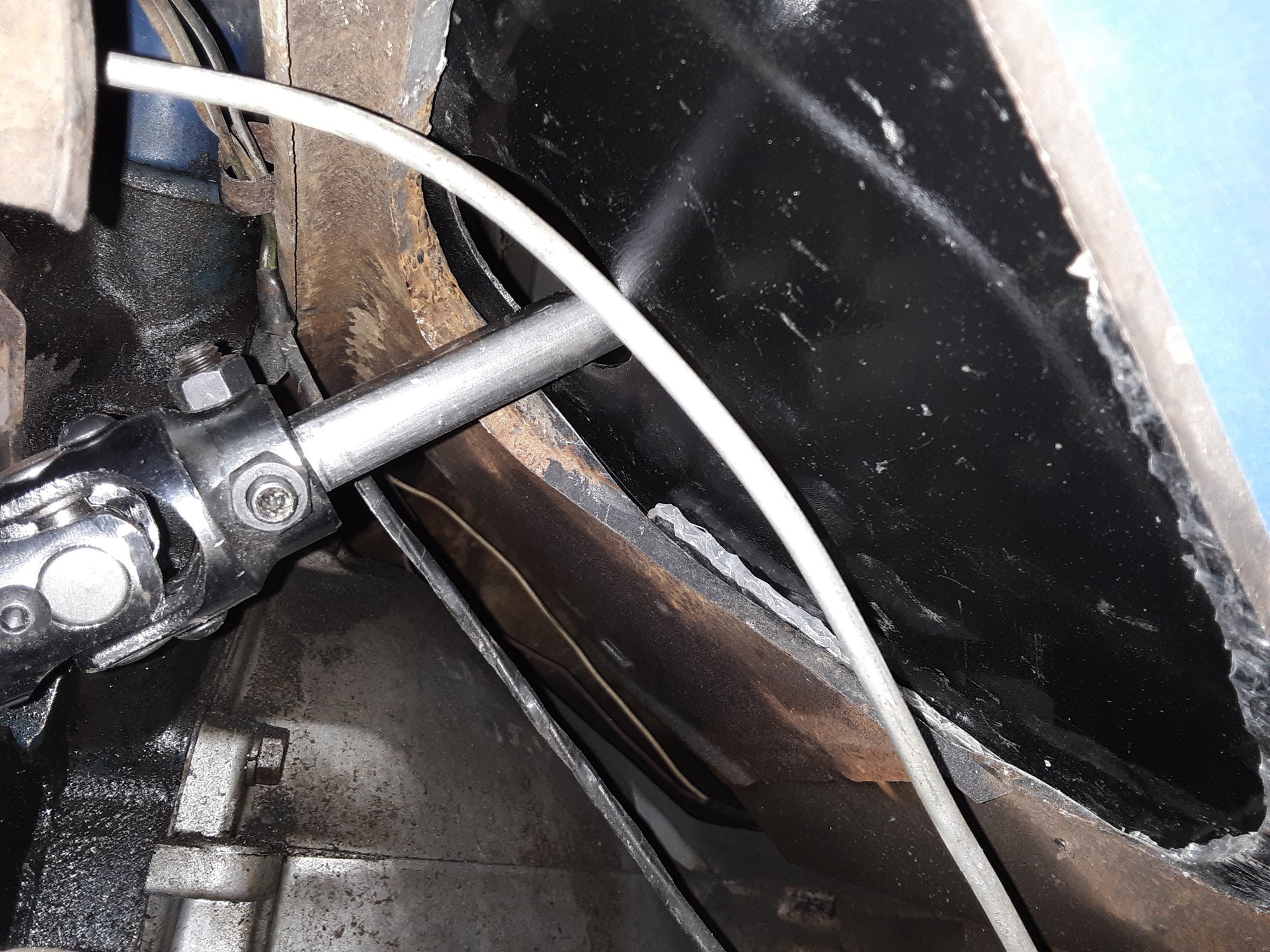

The kit supplied me with two couplers and a bunch of plates to mount a jog in the steering shaft but did not take into consideration that there is only about 4 inches from the top of the box to the firewall.
We purchased a chrome column for the truck since the original one needed work anyways.
I used one of the couplers to connect the column to the box. and had to relocate the column a couple of inches to the right of the original location to keep it straight.
If you are doing this, you will need a shorter column then the original. I would suggest a 27 or 28" depending on the steering wheel mount and steering wheel.
