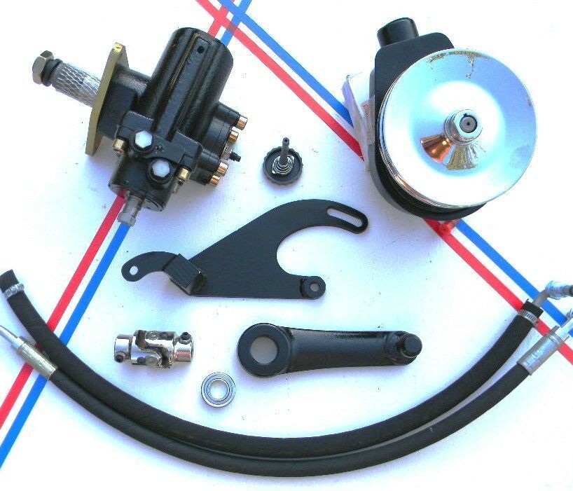

Which kit did you order? option 1 or option 2
option 1
option 2
Old Dec 18, 2019 | 10:22 AM
wcs69rat's Avatar
wcs69rat
Joined: Jul 2014
Posts: 161
416Ford,
the kit that I purchased was the one that you have shown in option 2. However, Don at ezsteer ordered a bracket to match my March Performance brackets from a different company and that bracket was not compatible with the Saginaw pump (which the March bracket is) so my kit came with a 71-76 style Mustang pump. Also, the picture of the kit shows the bracket that the heim joint goes through to create the lower support as a welded assembly. Mine showed up in pieces so you would have to fab and weld it yourself...which may actually be better. I just thought that I would let you know that the image is a little misleading.

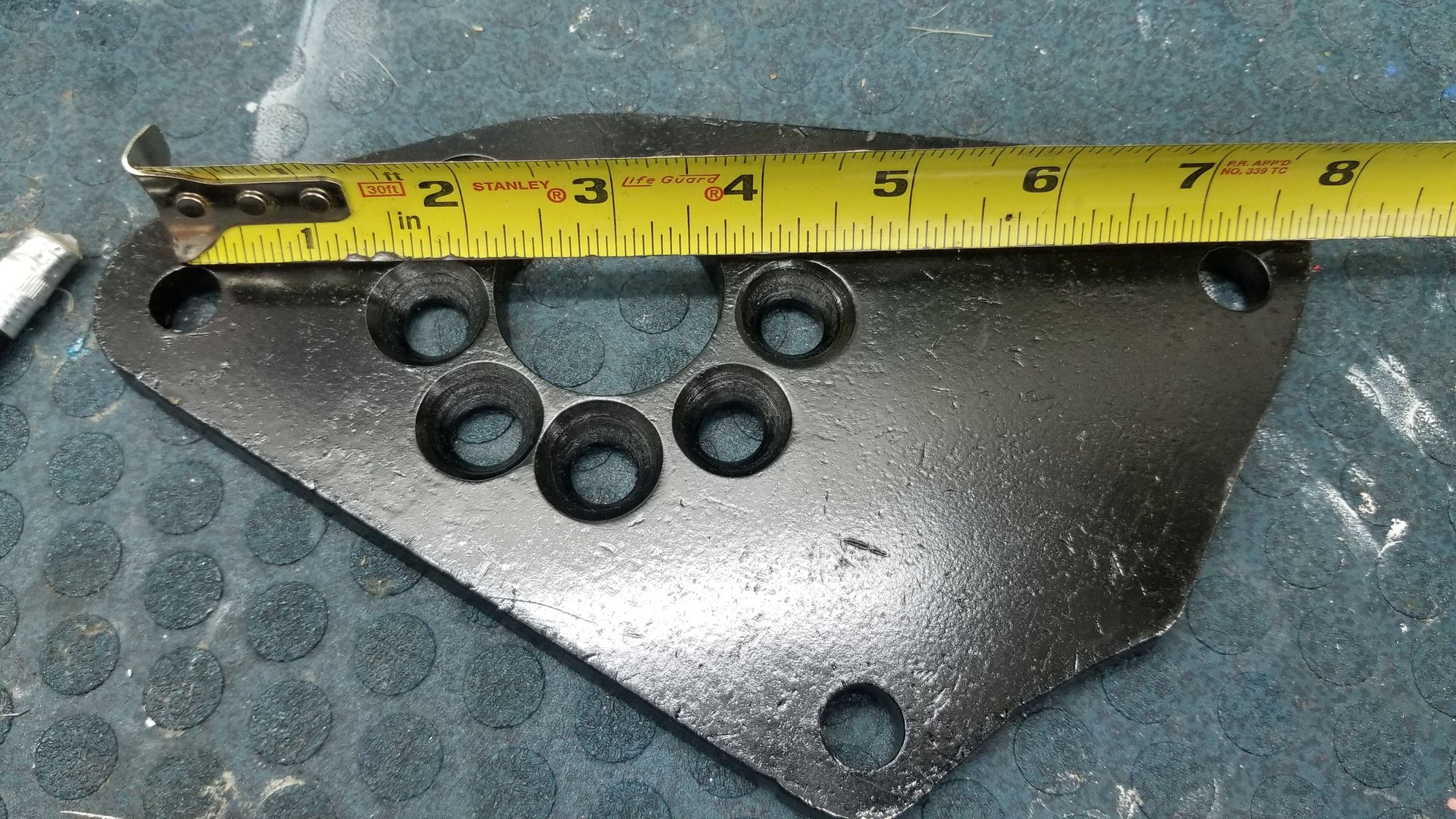

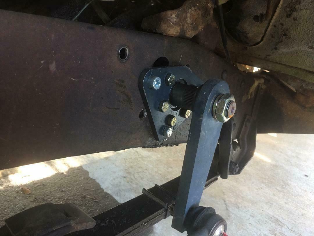

I think the kit will work fine with your set up. Just my two cents , but I would avoid using the 1960 and earlier mounting plate and would fab your own out of 3/8" or 1/2" plate to match our trucks mounting holes for the factory box. I have attached an image of what EZSteer sent me as to their suggestion of how to get it to fit with my four speed. If you notice, they wanted me to not only drill three new mounting holes for the plate, but then install the plate on the outside of the frame which would require up to seven more holes to be drilled to mount the plate to the steering box, but then they wanted me to drill another large hole in the frame for the shaft that the pitman arm attaches to adjacent to the large stock hole that is already there. The way they wanted me to mount it would mean that there were four stock location holes and then up to an additional 11 holes in the frame within an area approx. 10" long. That is just begging for the frame to crack. If you fab a heavy mounting plate that uses your stock frame holes, I think you will be happy with it.
