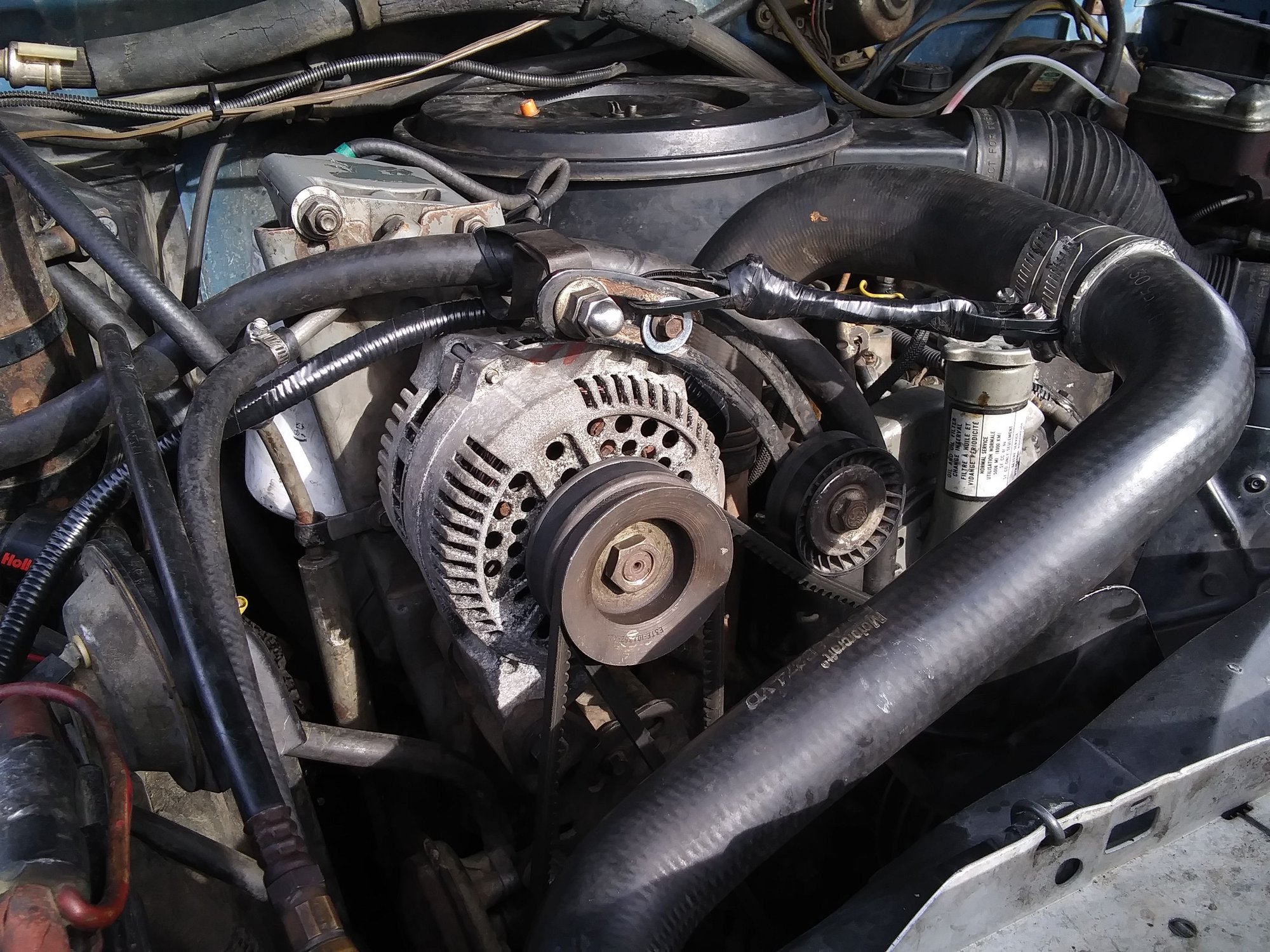

Alright, got the alternator in..
Donor was an early 90's lincoln continental, for the alternator and connector wires, the primary wire was sourced from a late 90's grand marquis with eyelets and fused links built to exact length.
I picked the 8.5 in large frame 130a unit clocked 12 o'clock apart, and fit is absolutely exactly as 2g 70a it replaced, perfect fit.
I took the slim fender washer from behind the stock pull nut and put it behind the pulley on the 3g, perfect belt alignment and case clearance.
The pics online varied in most cases from what I found in my 85 so just had to figure it out, but was pretty straightforward. I kept the stock alt harness because it backfed B+ to several yellow wires, doesn't hurt anything to stay hot, keeps old electrical routing unchanged, but clipped out where unneeded terminals were, kept ext voltage regulator, but it is now unused.
Fat wire went to the hot side of GP relay, the yellow went to the hot side of the start relay, which backfed by old alt harness retained to the other stock yellow wiring.
Green w/ red is pulling double duty now, from same color lead from near the external regulator. one to energize the alt as it's supposed to, and 2 it is now powering a 30a relay to activate an electric booster fuel pump, because this was hot on ignition and not acc.
I retained the small red ammeter wire that feeds through hot to the yellow wires in the stock alt harness, but clipped it's small yellow sister, that also was hot, to prevent burning wires or stock ammeter gauges because of high amperage.
The red wire has no outlet for now, but when I put in a volt meter gauge in the stock cluster, that yellow will be geounded to power that gauge.
It's running fine, no more grinding bearings noises from the old alternator. Though that 70a old bass turd was a trooper and earned my respect.
The installation went smooth and it is nice to have my axc fuel pump on that relay, I guess the alternator does what it's supposed to be doing so looks all good, I'm happy to have found an oe motorcraft that wasn't a rebuild, I will pick up a spare to have just in case, hopefully it proves as reliable as the old alternator.

My current 3g is a rebuilt one and the old one was oem and at idle there's definitely a difference in output. This rebuilt one doesn't wake up all the way til 1k, the old oem one didn't care so nice score!
I'm extremely pleased with the 3g swap and I'm sure you'll be too
