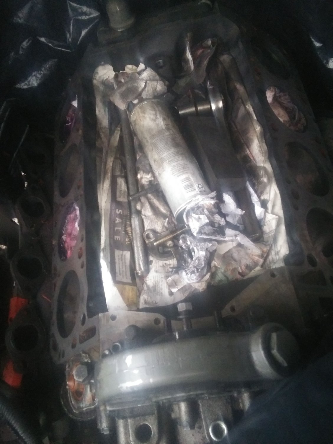

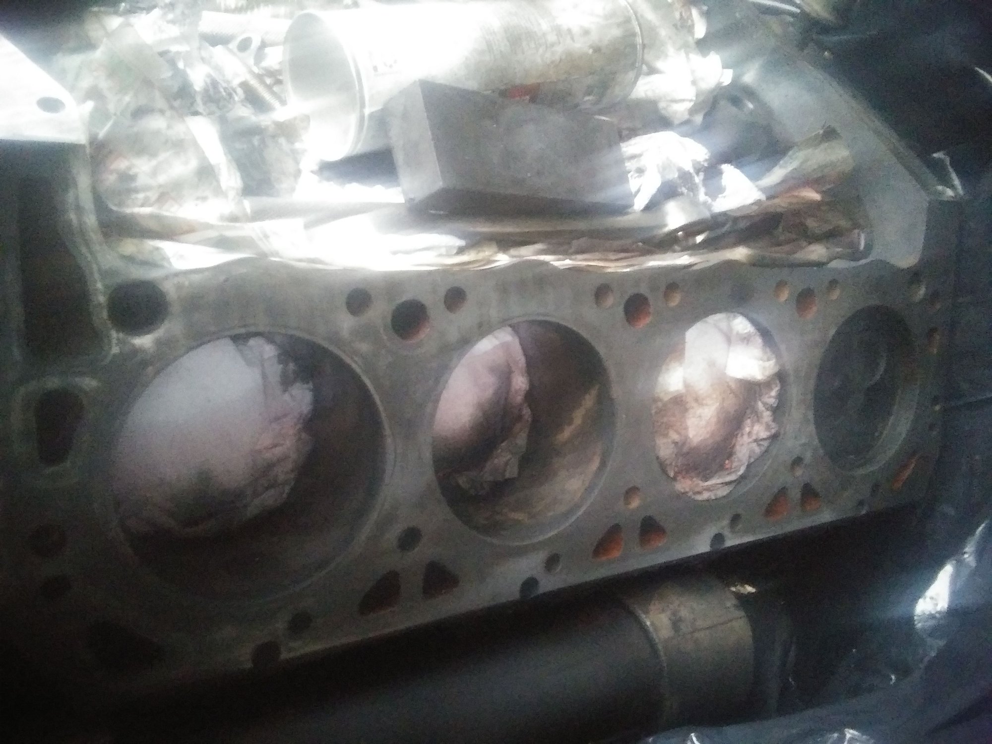

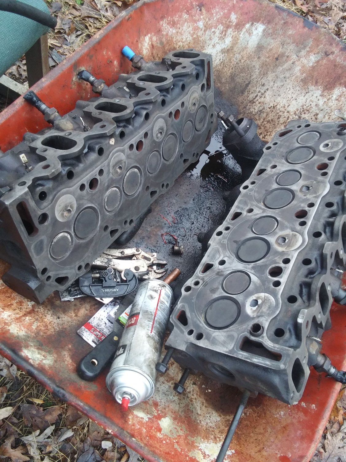

Incidentally after resurfacing both the decks and heads, where the gasket had broken, it was 'high'
and tight on both sides right there, causing a pinch point, that probably cracked the fire ring and overly compressed the gasket.
Could Also be higher because of exhaust gases passing and swelling the iron higher there, but close examination shows print of a crack in the former fire ring likely from pinching before, years later opening up and blowing out.
I blocked only far enough to achieve a smooth flat surface, then scraped the carbon from all around the valves.
Only have to clean out the cylinders, clean and lube the head bolts, and fashion up 2 alignment dowels.
pass side dowels came out in the head, seemingly glued in. Fortunately have some copper lineset that fits like a glove and will cut dowels to length.
Pics of resurfaced block and heads ready for degrease and installation.
