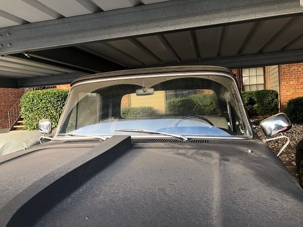

Is there any potential harm in installing longer wiper blades on a 65 F250 4WD? For example, to the wiper motor or any of the mechanicals?
It appears that the worse that could happen is the longer blade will lose contact with the glass at the bottom of the arc (and when the wipers are parked) on the passenger side.
OEM wiper blade length is 12-7/8". Most replacements (and what was on there) recommended are 13". It looks like it could handle a 15" (or maybe longer) blade. I'd love to have the larger swept area.

I run a 15 on the driver's side and a 13 on the passenger side. If you use a 15 on the passenger side, the end floats in space a bit where the glass is curved, but I don't see how it could do any damage.
That sounds even better! I can even see in my own pic (above) how the end of the 13" blade just barely makes contact on the passenger side. Thank you.

I'm running 15" blades, as stated above the pass side is off the glass near the top of the blade when parked at the bottom of the sweep. Hope that make sense...Pat

So, I'm gonna go with 15" on driver's side and 13" on pass. side. Trico 33-150 and 33-130. Had to order the 13" blade as it was not in stock. Will update with pics when I get them installed.

I have 15" on the driver side and 13" on the passenger side. There was no rain, but the dust provided a decent substitute. It's not annoyingly lopsided, so I think I'll go with it.
