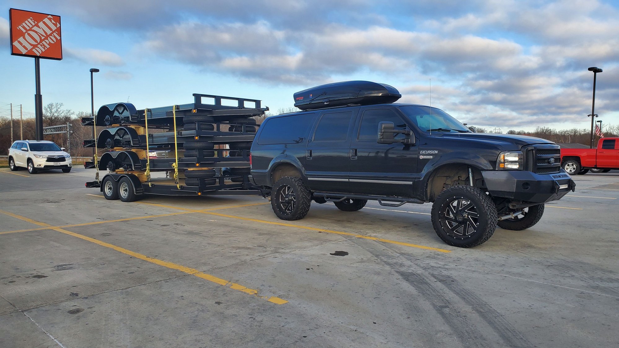

Before I swapped wheels and removed the lift, I measured 32in hub to fender and rolled on 35s........
