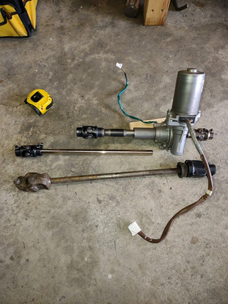

Im in the middle of an EPAS build but its on pause for now. I took the EPAS out of a 2007 toyota prius. I built my mounting bracket and used 3 u-joints and a piece of 3/4 DD shaft. I didnt cut and fit the DD shaft yet. Im waiting till cab and everything is in final position. Getting ready for paint soon and hunting season is here. Its going to be a little while before Im back on this.
This is how mine is laid out and thats the original shaft beneath in the pic.
