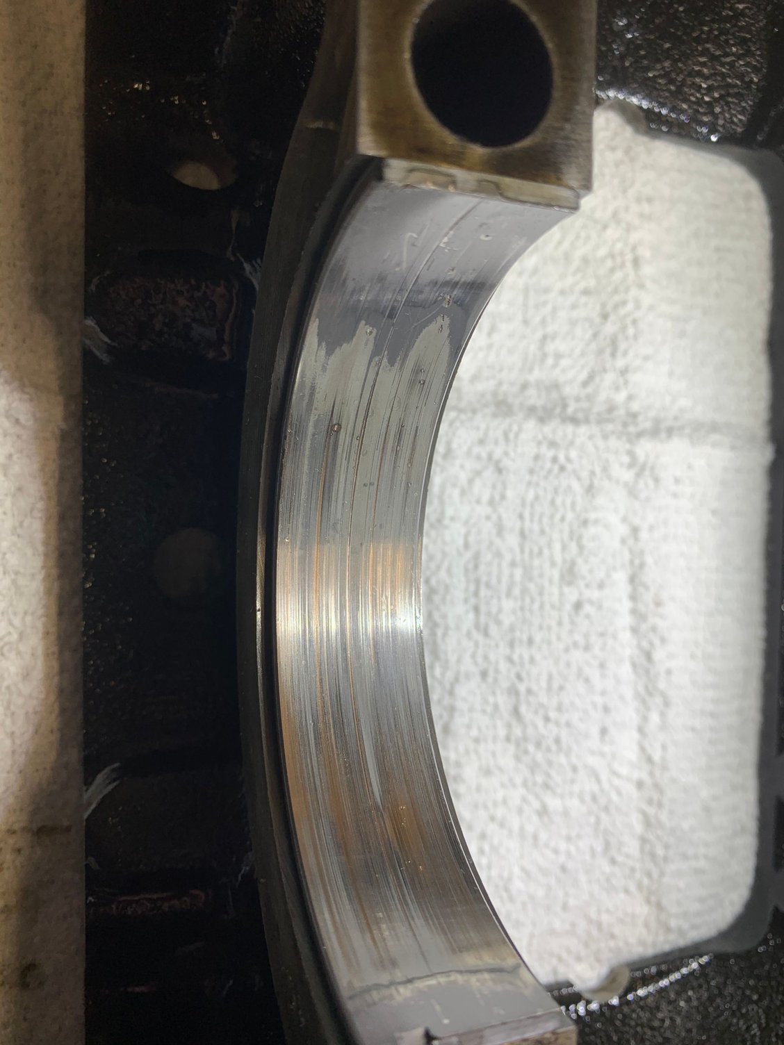

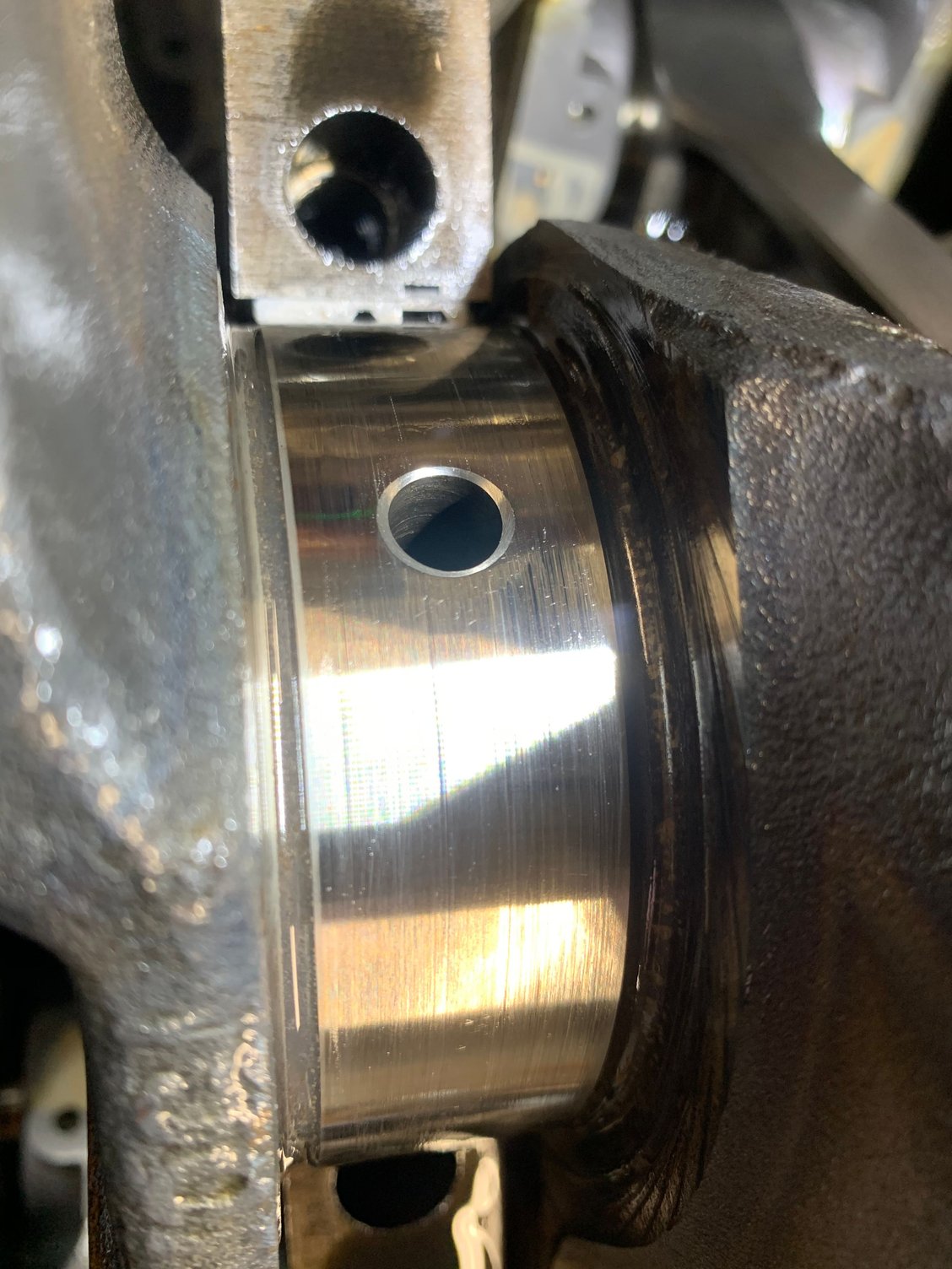

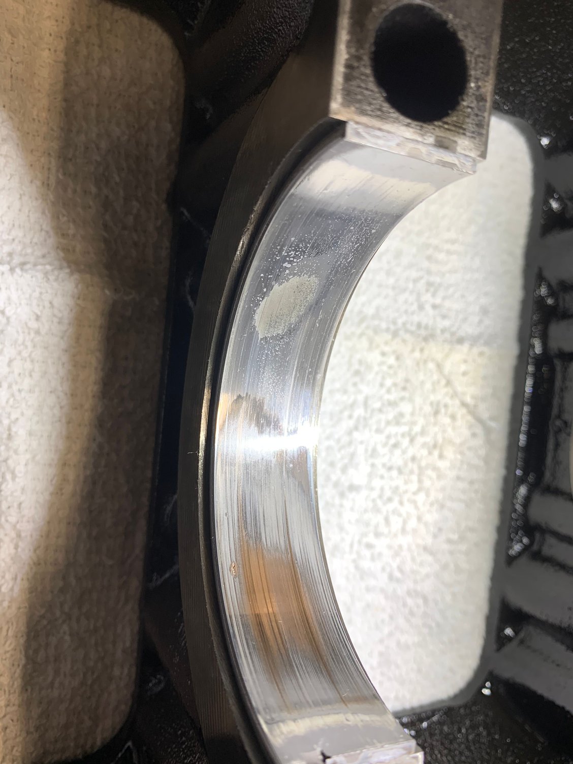

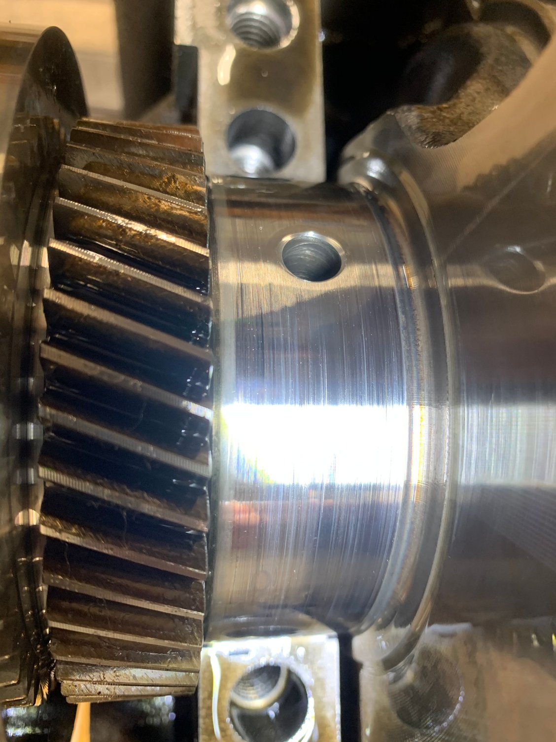

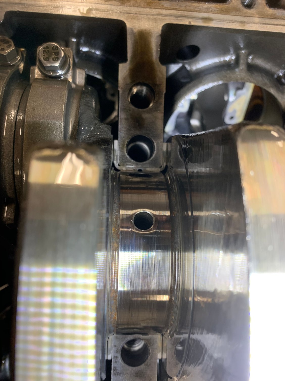

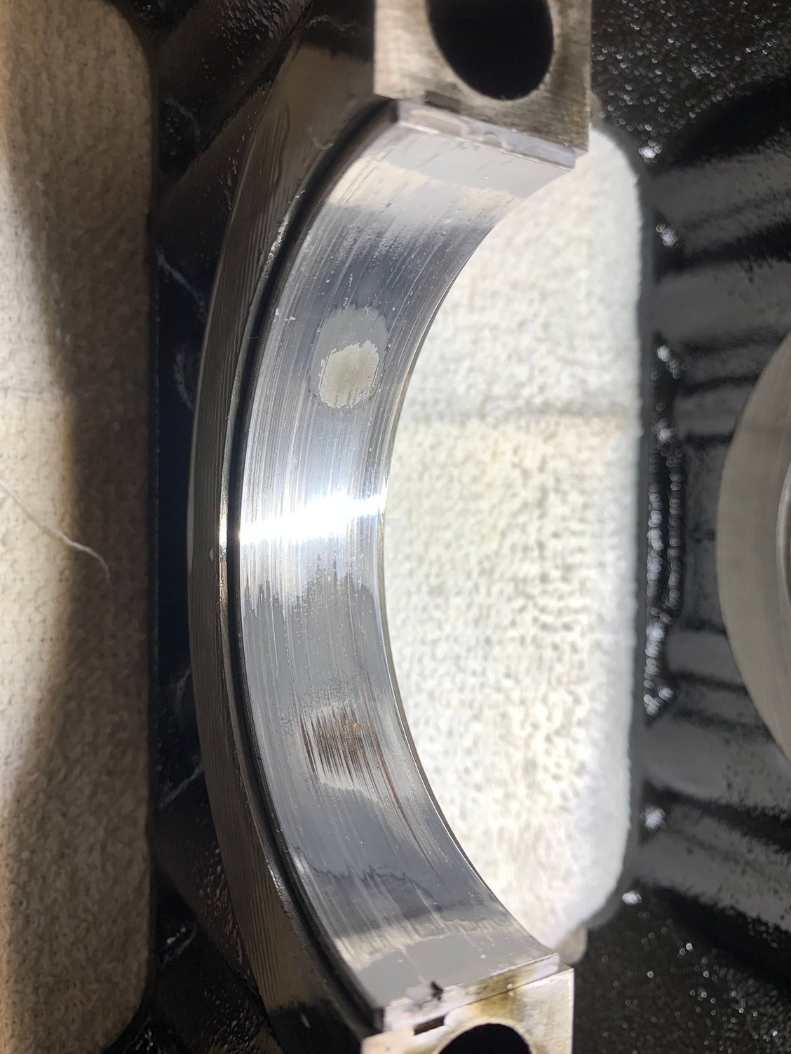

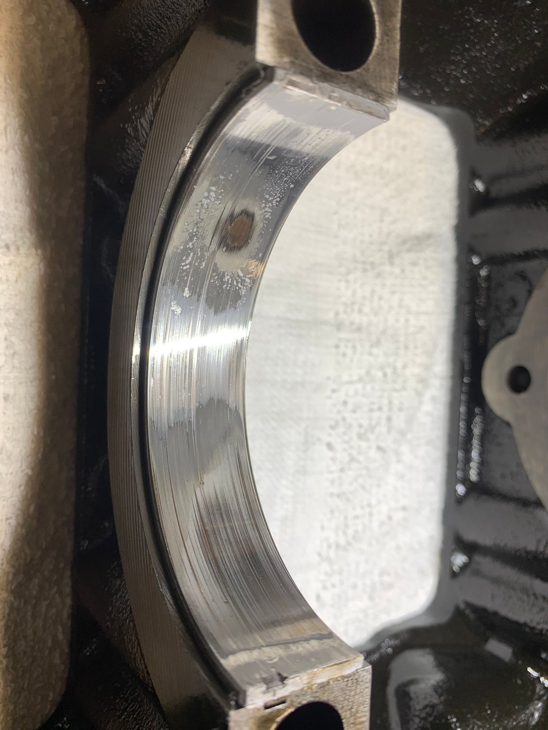

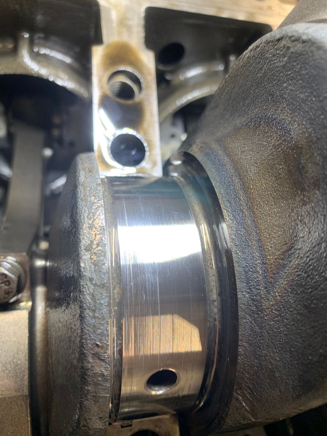

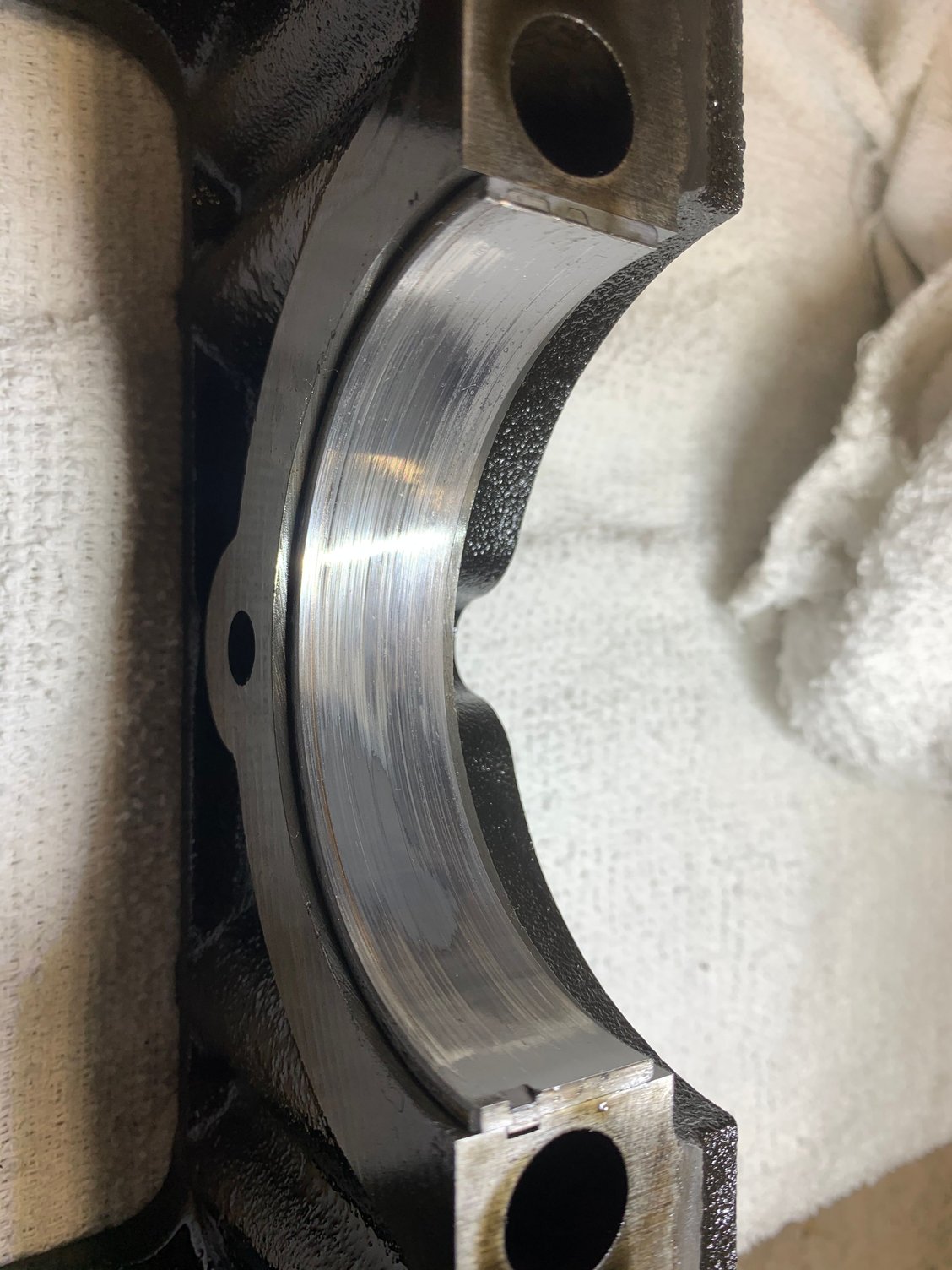

Crank and crank bearing wear, if I do this I’m doing a full rebuild or short block.

Some of what is in those images I don't think is too abnormal, but for the mileage, my interpretation is the wearing to the copper is high. I didn't understand at first why you have so much scoring. You probably could just put new shell in and let it run for some time. Then you mentioned the history of the vehicle. I'm speculating the first owner didn't take care of it well, and/or there was work done on the vehicle and cleanliness during the work was not a high priority. We all will get some debris and dirt in the moto, and there will be score lines in bearings and journals from that. There's way more history there than just the normal machining marks on the journals.

I totally agree Jack, it’s pretty hairy. I know I was meticulous when I worked on her so it had to be from the previous owner’s shade tree shop! From the looks of it someone has been in this engine since it was new because the amount and placement of grey RTV is insane. It was globbed on the front and rear cover and every front cover bolt had it on the threads. There is no service record of the studs, oil cooler or EGR delete (welded on both ends) so I know someone at least did that much somewhere other than the dealership. I am looking through my records for the documentation I was given when I bought it at 150k and over three years ago. I have service records from Ford for the 120-150k mileage but none before that. Who knows but I know I really don’t feel like pulling this engine every six months so I’m going to do it right and be done with it. I spoke with a local machine shop (2 hours away) and the lead machinist and owner is going to call me Monday to discuss further. I think I can get the machine work and parts and assemble the short block in my little shop for less than buying a short block.
keep the recommendations coming guys, I’m just weighing options and seeing what some of your past experiences have been with short blocks. It might be worth another $500-700 to have a reputable shop do the machine work and assembly but some of these quotes I’ve been given are pretty wild.
Thanks!
