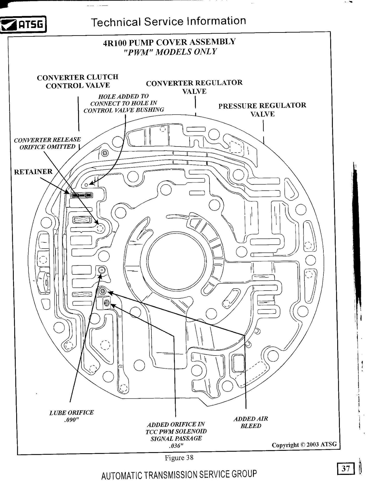

I have not done this in a while, just trying to make sure I convert the pump correctly. Last time I had written instructions from BTS. I should have kept them. In any case from what I remember I need to put and 0.090 orfice in the grayed out location for the converter release and pull the 0.036" orfice tube for the tcc pwm solenoid signal passage. Can anyone confirm?I have attached the pump drawing for a good reference.
