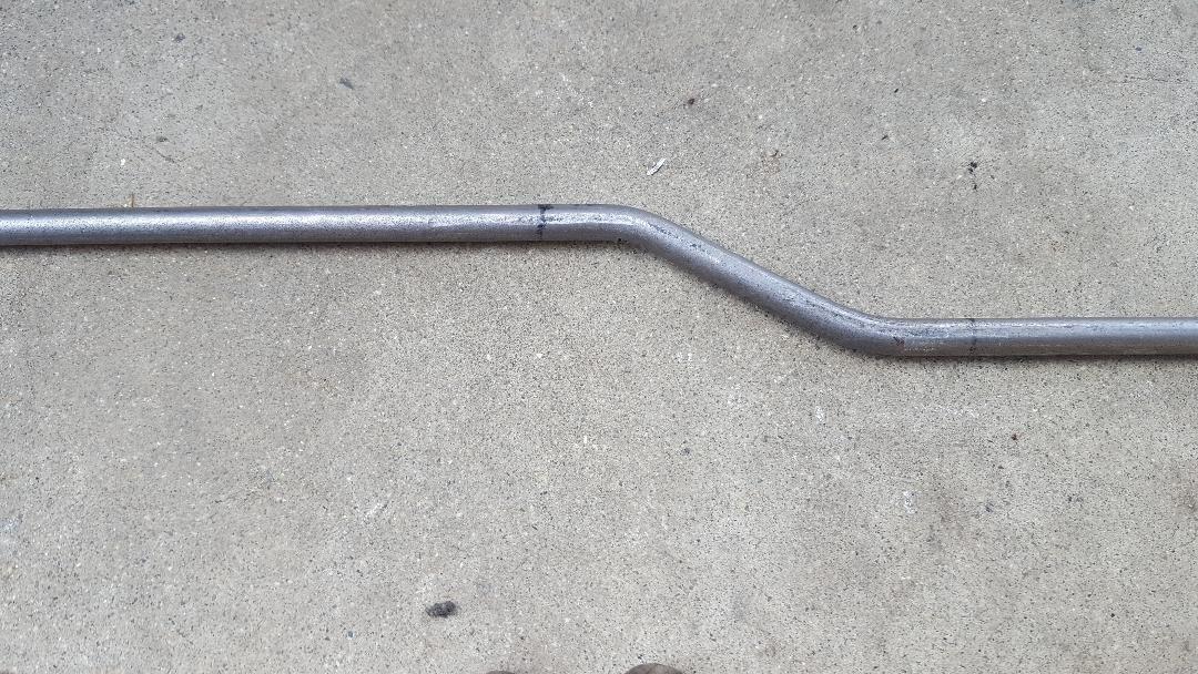

Originally Posted by fonz61econoline
can any one provide me with measurements for the rod that goes from the pedal to the box mount lever? part number 9A701 on the linkage diagram. My buddy where my vans stored at, accidentally tossed the rod, so now i need to source one. I figure all thread will do the trick, just gotta know where the bend is and the over all length of the rod.
C1UU-9A701-A .. Rod-Accelerator Shaft to Bellcrank - 58.00" long / Obsolete
1961/62 E100.
See post #31 for the clutch equalizer bar bushings.

Thanks numbersdummy for the assistance, Figure i might as well buy a piece of rod, bend it to shape, and thread it.
I had my friend contact the person I got the van from, he has some spare parts so hopefully he has a spare rod, if not then I will have to fabricate my own, not sure if its a 1/4" rod or 5/16" though. The image does look to appear to have a thicker rod displayed vs the smaller rods that actuate the rest of the linkage.
Can any one possibly verify?

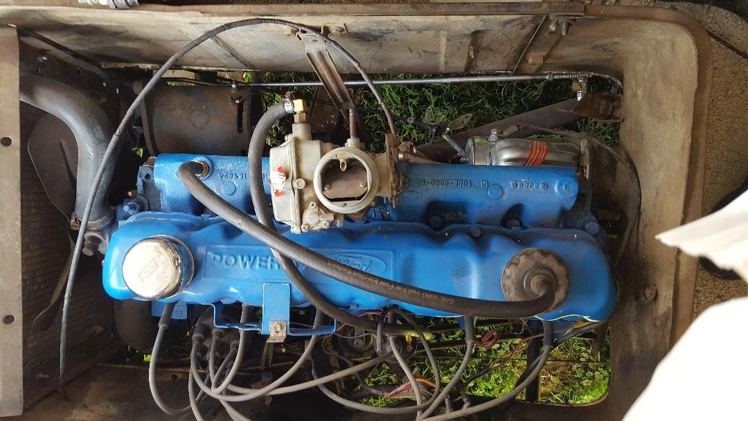

ordered a parts carb for the econoline in hopes it was in good shape
turns out it had a bunch of cracks on the inside, even though I asked ebay seller for truthful information on its condition. He said it was a good core
one of the ears was too stressed out and failed when i attempted to flatten the mounting face, by heating and using a table vice and a mallet.
most recent photo of the van, still waiting on contact from the gentleman who sold me the van to see if he has any spare parts. probably will purchase a steel rod and attempt some magic with it to make the rod to keep pressing forward.

found this carburetor at famoso durring the march meet, lucky enough it was complete, with a fresh rebuild, but the float adjustment was off and flooded like crazy. I installed a new old stock nitrophyl float, jetted up to 64 from a 61 it had. Also rigged up a linkage rod thanks to the help provided by numbersdumby,

I feel like I should have made the rod a bit longer, but the good thing with metal is you can always weld more to it. The throttle works fine for the most part, Ill try and keep up with photos and updates as I go, the Van is currently at where I stay, so i should be able to do funner things now.

tried to drive the van to the gas station to fuel up, but noticed the carburetor continued to flood. on disassembly I noticed that there was thread locker on the seat threads, and found a cracked gasket on the passage bolt that holds the float retainer in place. to top it off among all the investigating i some how managed to lose the needle.. So now I am in the market of a rebuild kit, wouldn't be a bad idea at this point for all the neat surprises ive found inside this little sucker. Plus flooding the oil with gas probably isnt the best either. So an oil change is due now too it seems.

carb keeps flooding , has anyone ran into an issue using the stock 61 econoline fuel pump? I tried putting a gauge to get a accurate reading, but the needle would just pulse from 1 to 3 psi, and makes the carb flood. replaced needle and seat, cleaned seals, verified it would close several times, but still flooding.
Did these early econoline have to run a fuel pressure regulator? I have 2 at my disposal, but one is a brand new return type i planned for later use, and have no found anyhting about being able to plug its return port safely.
My other blocking, or non return regulator is currently in opperation on my other car.
open to any suggestions.

is the float set properly and sealed? if the does not seat the needle valve into the seat, it will flood out.

x2 on float. see if you can find a you tube video on your carb. saves a lot of aggravation for me.

Check the weight of the float. Some float materials will soak up gas and become too heavy to float and seal off the needle and seat.
I've had this happen before on a non brass float.
