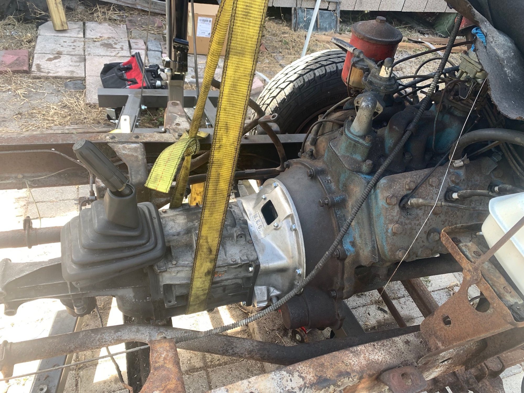

I am keeping my flathead for now. I considered a 351 swap, but I put that off for now, unless the 8BA is just too anemic, since I plan to use the truck as normal vehicle, not a show car.
I did do a swap for a T5 speed transmission though (to go with the rear end swap), as I don't like double clutching. I pulled the transmission from a 1995 junkyard S10 in great condition ($80 with shifter and driveshaft on 40% off day at the local PickaPart). I used a kit from Cornhuskers for that; bolted right on.
The paring of the trans and the rear (3.54 NLS) with the 8BA should give ok drivability, but OD will likely not be much use with the ole flattie.

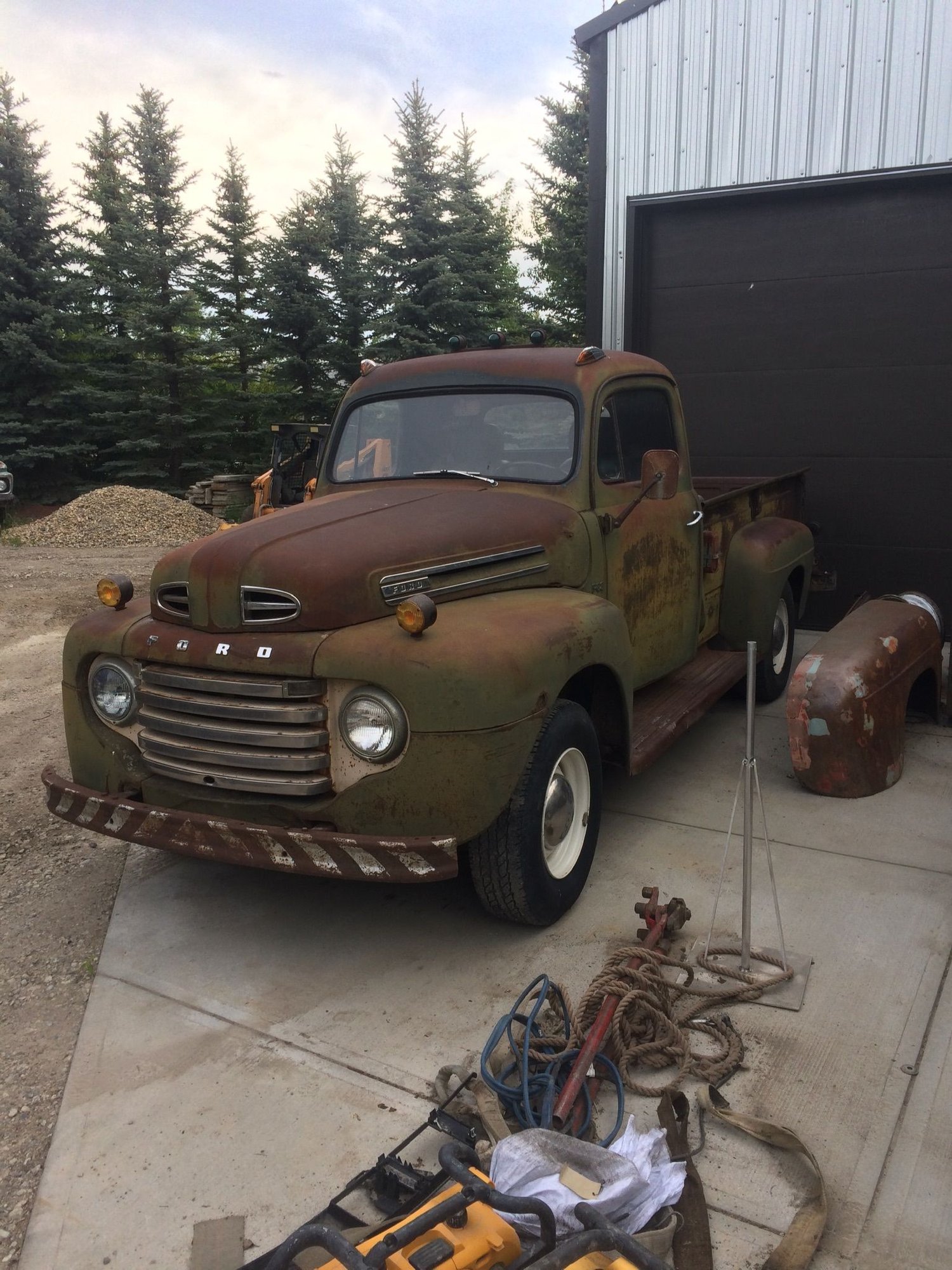

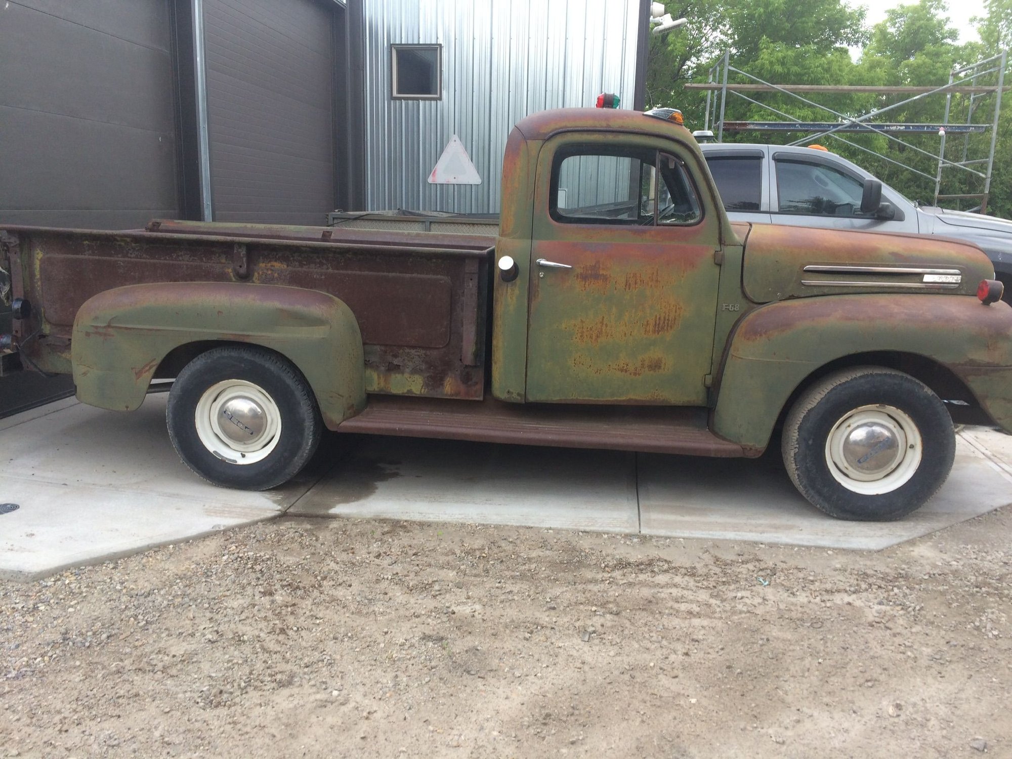

Hey CJ21, what part of Calgary are you in? I’ve converted two of my trucks to disc brakes 1948 F68 and 1952 M3. Both keeping the 8 bolt hubs. I used the components from 1977 F250. It takes a bit of time but I didn’t want to spend the money on the TSM kit. I have all the part numbers if you are interested. I also have an extra Dana 60 rear end here i might consider selling. I don’t know the ratio, but I can find out. Someone put it into a 62 F100 unibody that I bought. I have a Dana 60 from a 72 F250 in my 48 and one from 69 in my 52. I live just east of Chestermere if you want to have a look at what I did. The rims are 16.5 from a 77 F250, I used hubcap clips to hold the original hubcaps on. I haven’t had any fall off yet. Doug.
