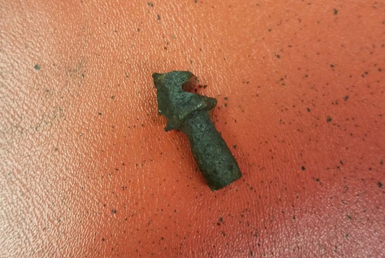

What was left of the crossover clamp bolt. I just cut it.

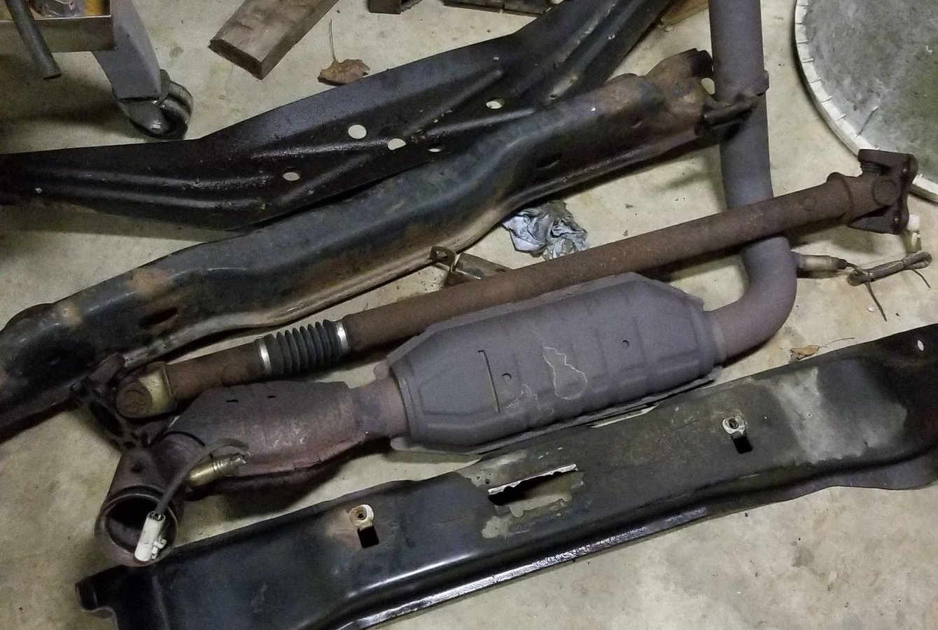

The top down. Skid plate, Support for the suspension, Front drive shaft, Left cat and crossover, Transmission support. Note the cracks. I will pick up one from the junk yard or add patch plate.

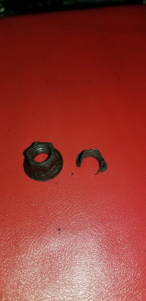

These were the nuts holding on the left pipe. Yes the halve nut was holding the pipe. I didn't know what was holding the pipe on but I could feel the bumps. I put a socket on it and it came off.
