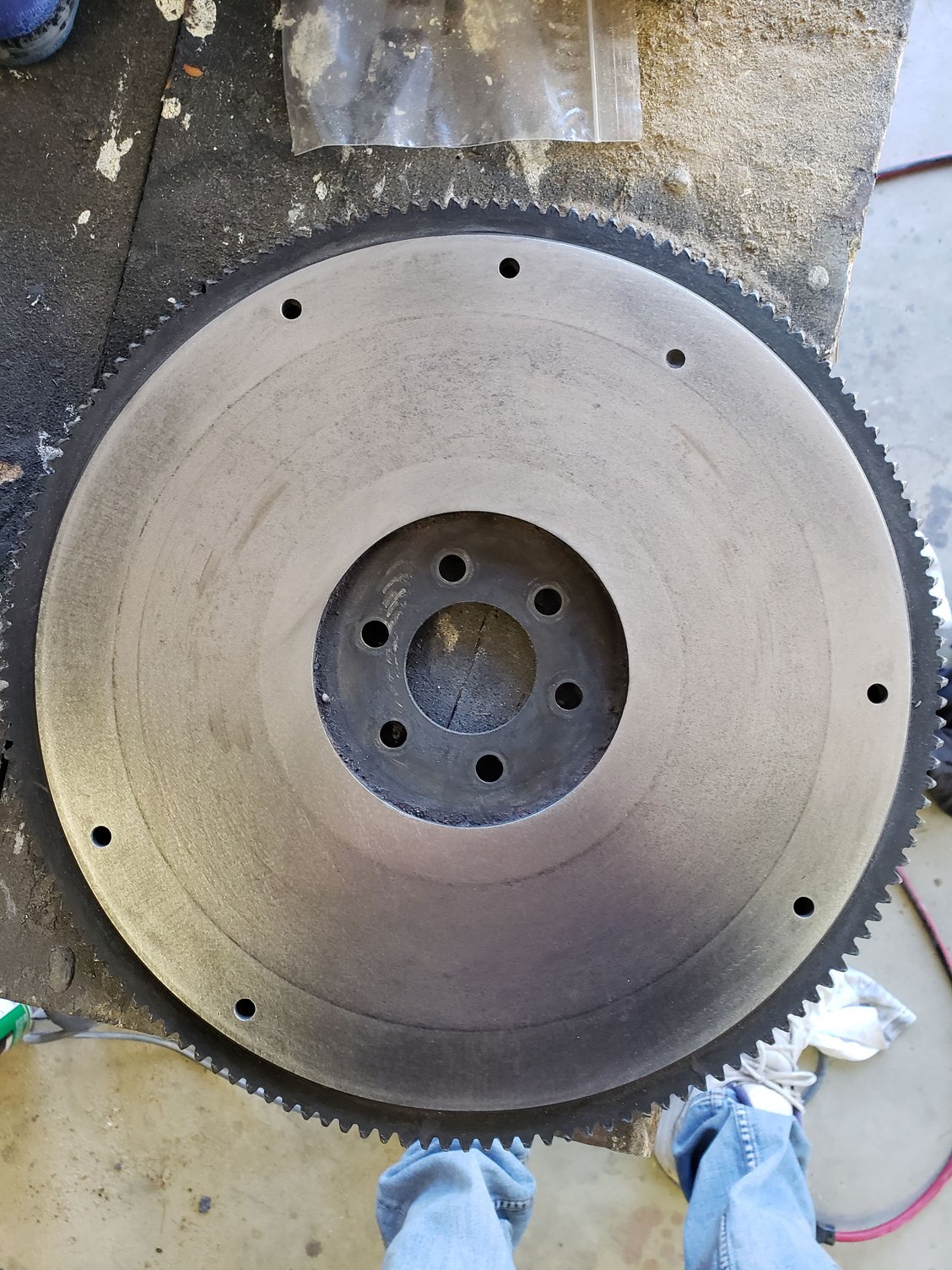

You are correct. It took longer to find bolt heads in 60 year grease accumulation than it did to pull bell off. Makes a huge difference having cab and front clip off. Now the flywheel issue. Can't find any machine shops to resurface. Cleaned up with palm sander.
