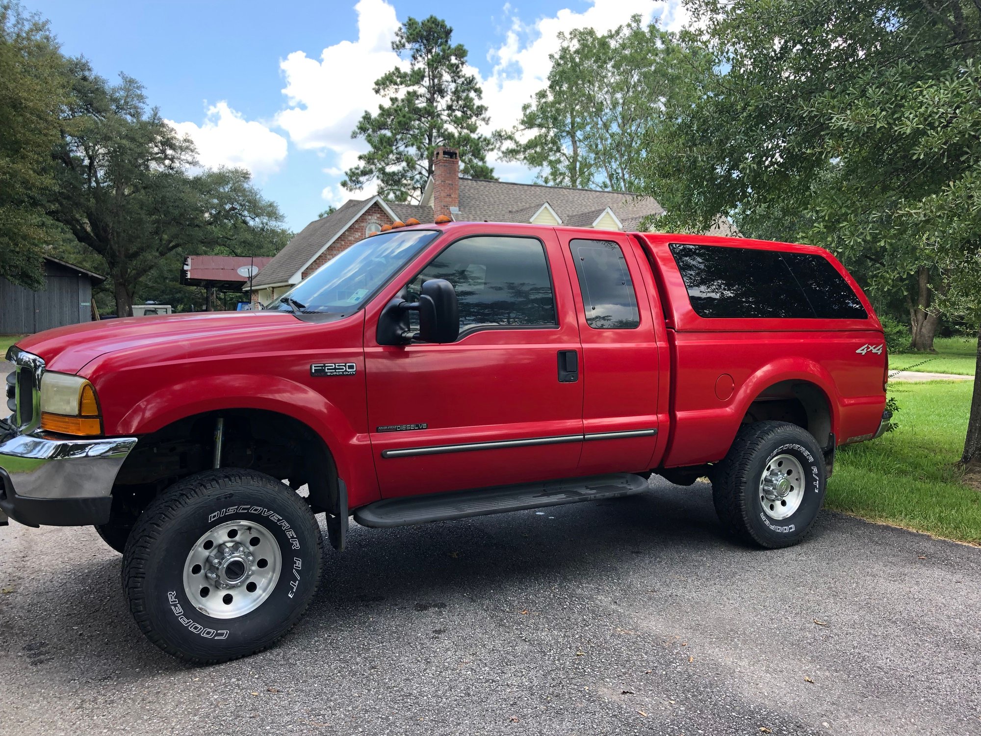

Hey guys my truck is a 2000 f250 4x4 . Completely stock 7.3 with just over 300k. I’m wanting to put new injectors in and looking for recommendations on injectors as I’m sure improvement have been made in 20 years. BUT! I’m not looking to go racing! Only planned mods are maybe a 4” exhaust ebv delete and new turbo wheel with the exhaust housing. Just looking for a little more power, and fuel mileage . Like I said this engine has had no mods in 20 years and it’s done me well. Just down on boost and power, but mechanically engine is fine just time for some tlc. Thanks.

I might be tempted to do something about those old headlights

Good looking truck!

you will experience with that shell on the back (I leaned from experience that those shells amplify the exhaust tones). Those two will get you a bit more power and
