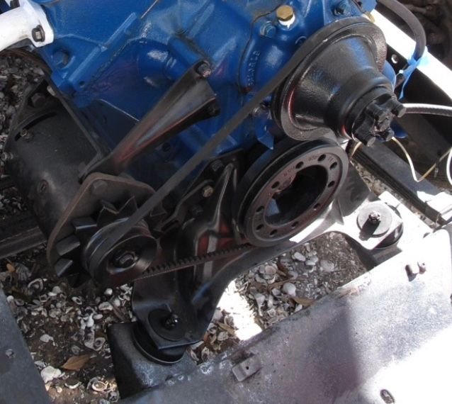

Branden,
My 59 F100 originally came with a 223, however it was swapped out for a 413 Chrysler at some point before I picked it up. Essentially you will need a front engine mount like the one pictured below. You will also need a V8 bellhousing to suit your gear box currently installed. Do you have a 4 speed box on the floor? Order new engine mounts & mount bolts all round too!

The page ND provided is for 61-63 not 57-60 that’s why the brackets look different.
You need the one pictured in post #6
Post #2: 1961/63 pic has been replaced by two correct 1957/60 pics.
