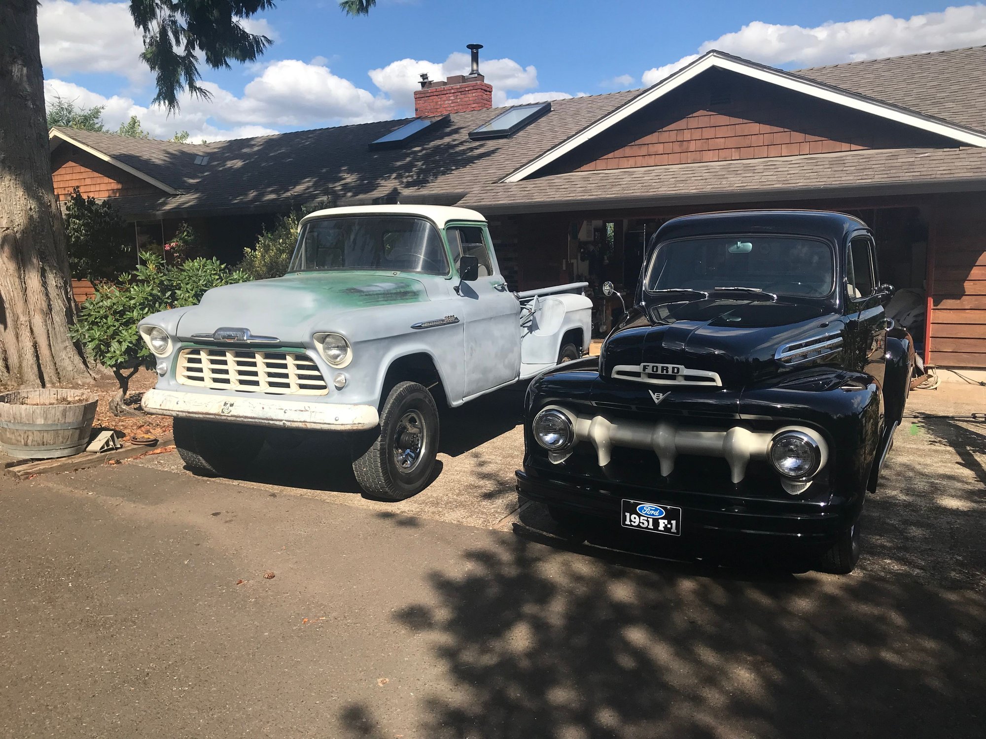

Ross,
There is only one shim. Should I leave it there and move on to other possibilities that may be coaxing the death wobble like you suggested? Thought I'd send you a pic of my '51 Ford. (The '56 Chevy is a NAPCO and my current project.)
Billy B.
