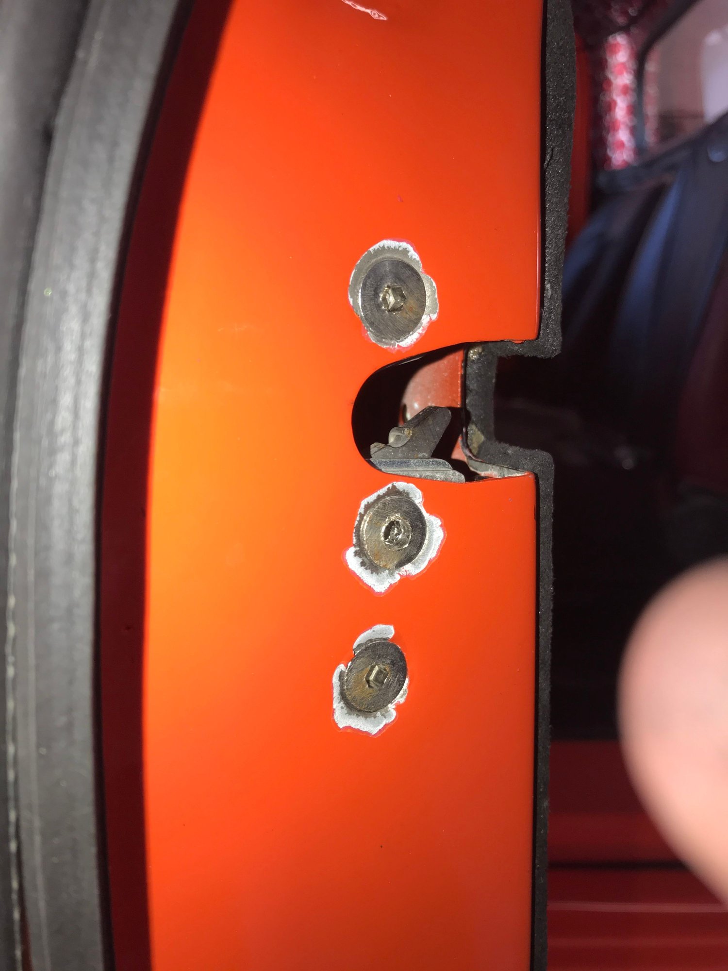

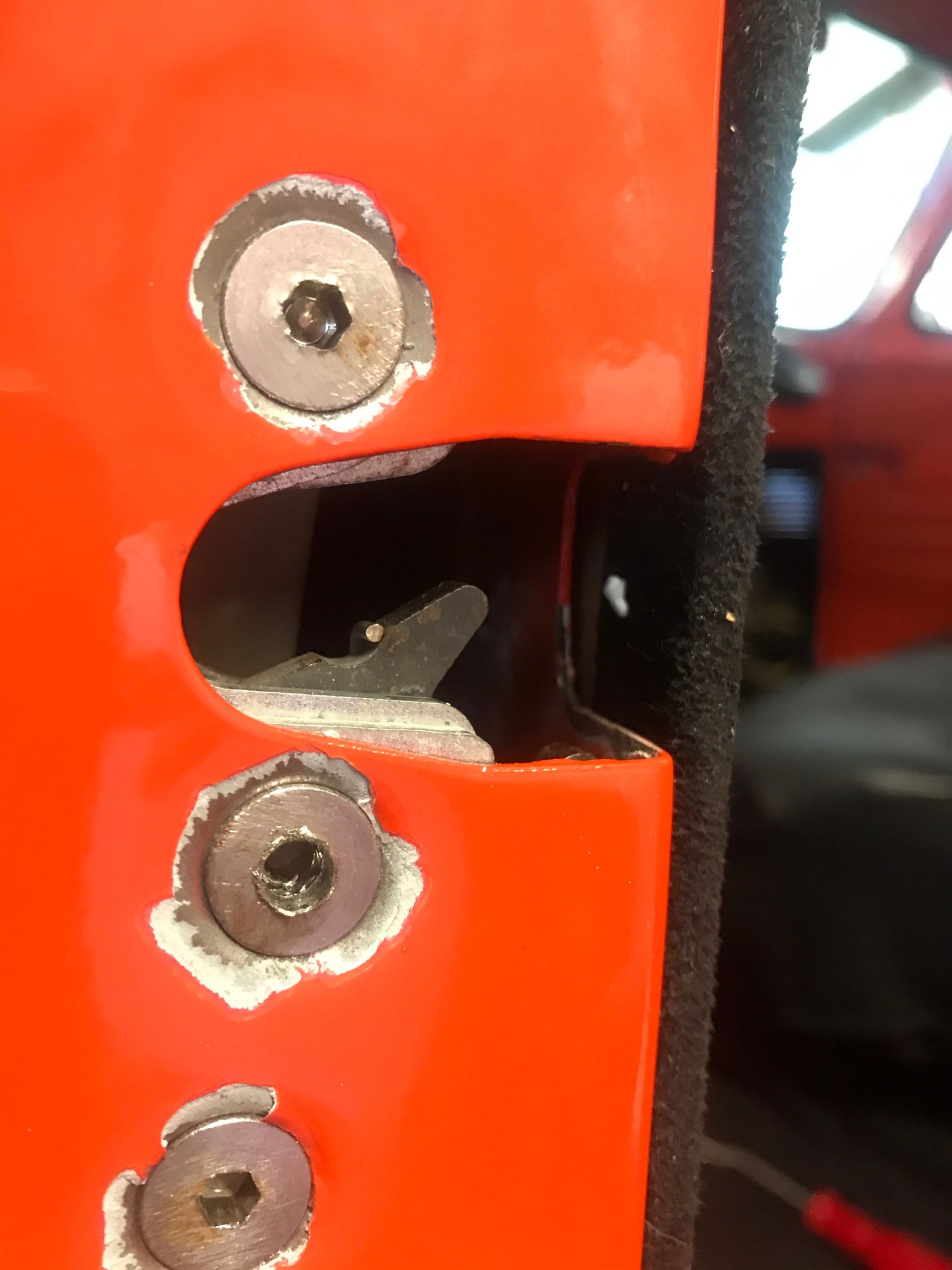

looks like I forgot a step. I installed Altman easy latches but didn’t think about it when ordering Tmi door panels for a stock latch. (Don’t mind they chipped paint &#128579 any ideas?

Just notch the door panel.
Looks like you did a great job on welding/painting in the Altman mounting plate, what happened with the screws?
I don’t wanna notch the door panel and make it look terrible. On the screws, I guess I tightened them down too much. Chipping the paint. I’m gonna touch them up and see how they look

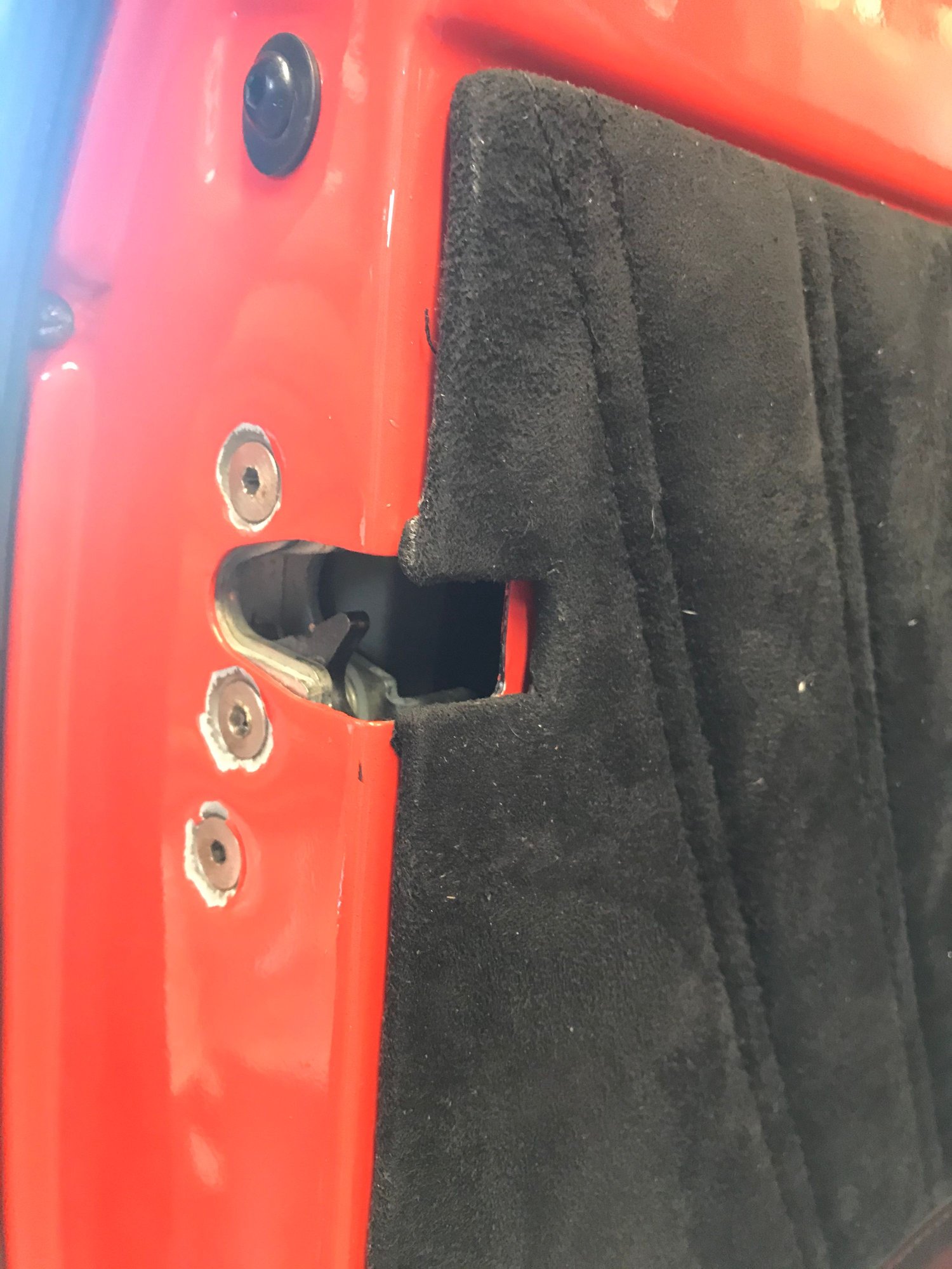

Remove the panel and try to cut the notch from the back side, without cutting the fabric. Then peel the notched piece from behind the fabric. Then cut the fabric as needed to roll it around the cut edge, and glue it to the back of the panel.
If you are very careful, and take your time, you might be able to cut the panel with a cutting wheel on a Dremel tool. Go very slow and take small bites to keep from melting the plastic.

I agree on that workflow. I’m worried about snapping the plastic clips holding the panel on. I have a panel popper removal tool so I’ll be careful.

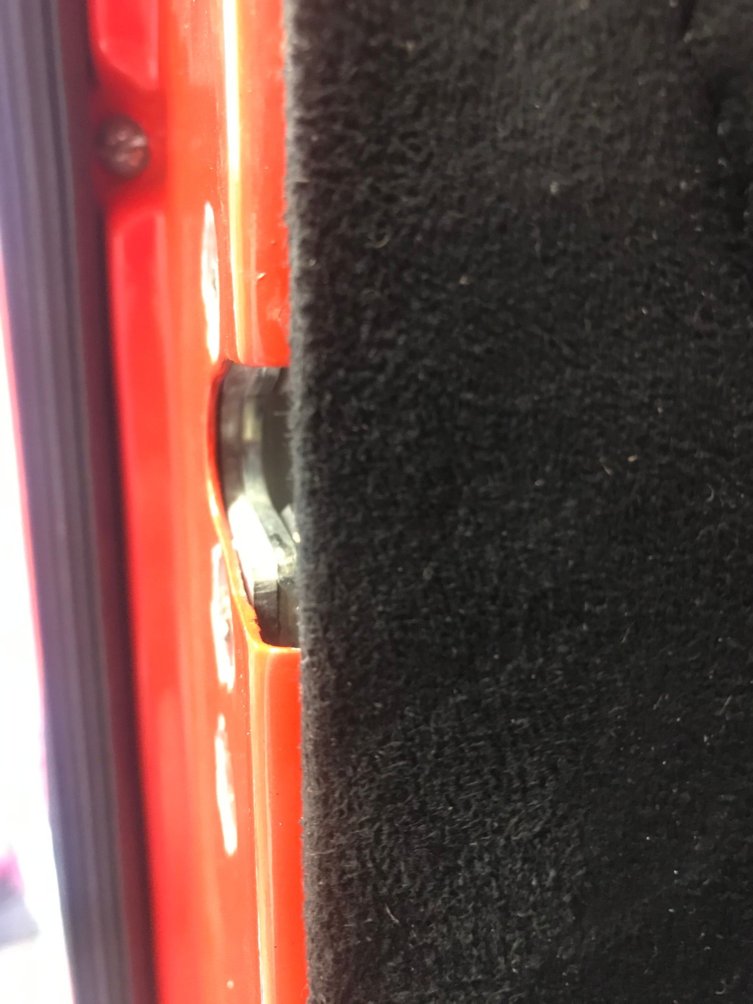

Just an update, after I peeled back the fabric with a razor blade, and notched the panel with a dremel, there wasn’t much fabric to fold over and hide the cardboard. Had to use a little black spray paint on the cardboard. I think it turned out great
