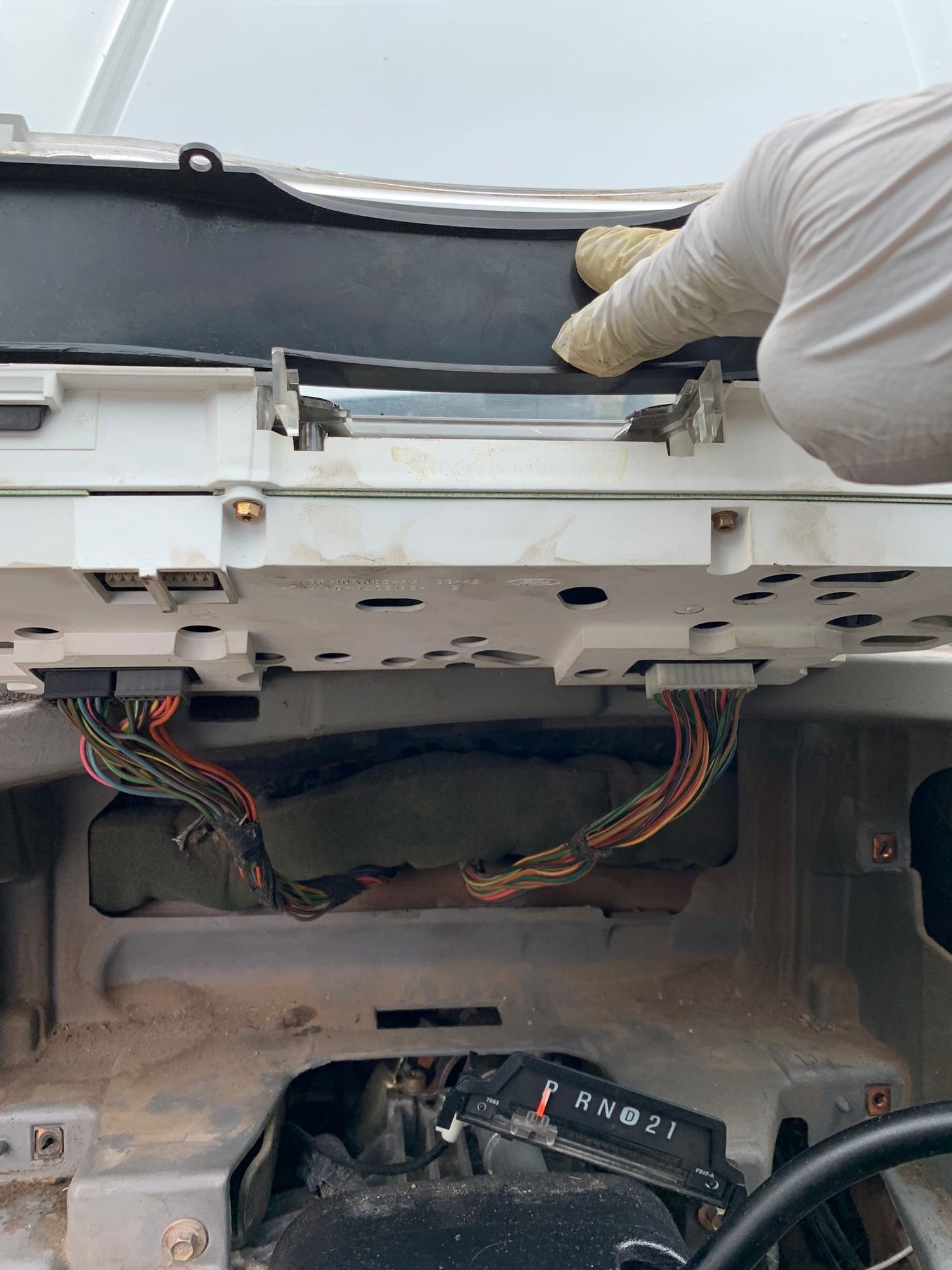

What I am referring to as the dash is the biggest plastic piece in the photo you do not need to remove the frame////do not remove the frame lol I believe all the screws are 8 mm that hold the dash on
Unless your ready to go all the way and have a huge cleaning party lol
Here is a photo of the frame it is attached in about 5 places.

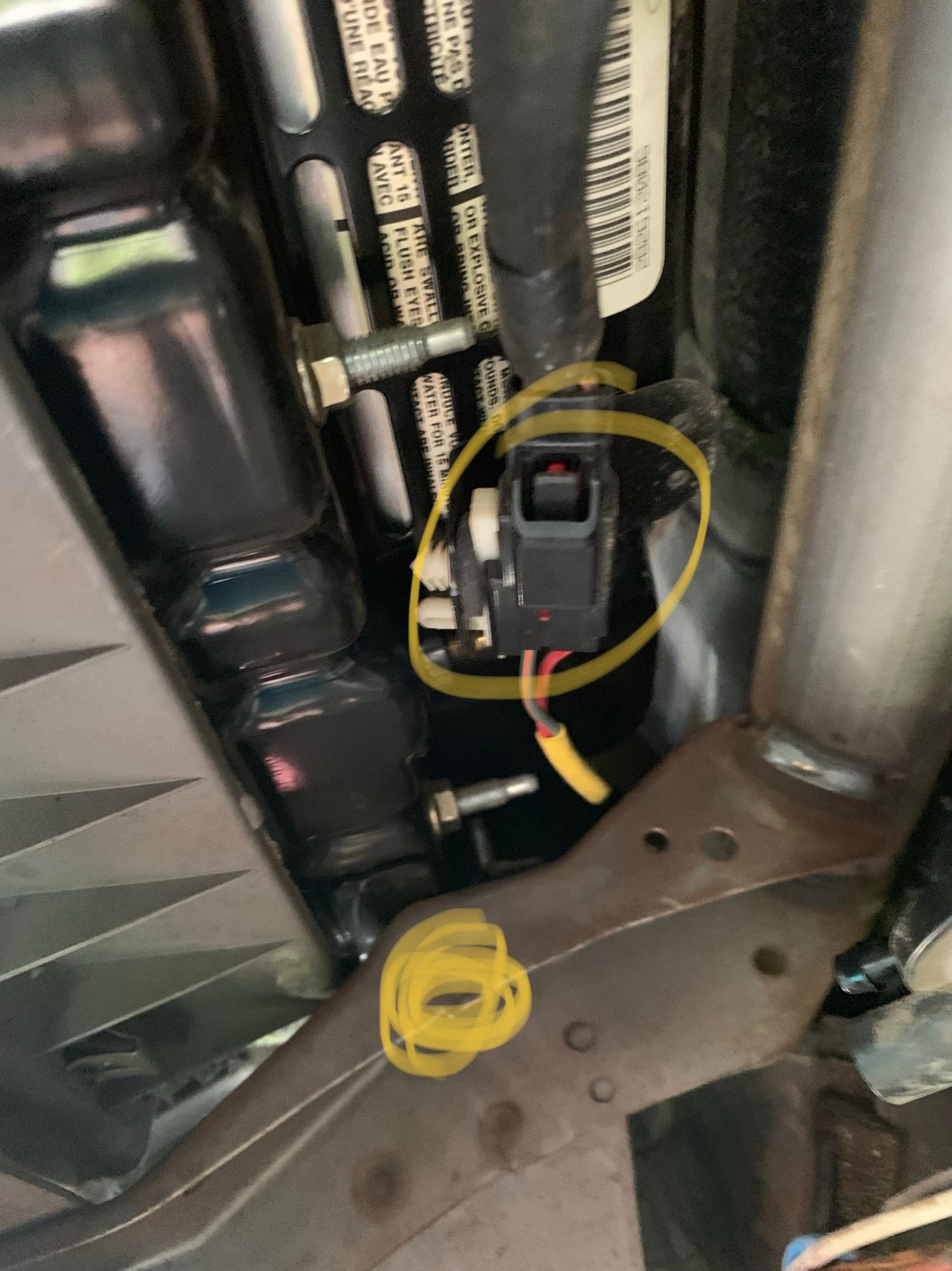

you want to leave the frame on removing the bolts on the side will start to remove the frame. If that is what you want to do all electrical must be disconnected first. To access the passenger vent I would pop the light switch, the bezel with the other 3 vents, than pop out the instrument cluster, than remove the lower dash(the piece of the dash the cup holder is part of, the cup holder has screws on the outside and under neath. I am pretty sure you have to pull the airbag there will be 2 bolts that are a different color than the rest you loosen them than it will slide out there is no need to fully remove the bolts, remove the glovebox before hand as well. The bolts should all be the same size except 1 of the front 3 on the windshield and the bolts that hold the fuse box in place. In that photo you will see a copper piece on the right windshield make sure that does not get lost and goes on right that's one of the harder parts. its probably closer to 20 bolts it sounds like a lot but its not too bad. Be prepared to hunt down a hiding bolt or 2 but once you start rolling its not too bad.

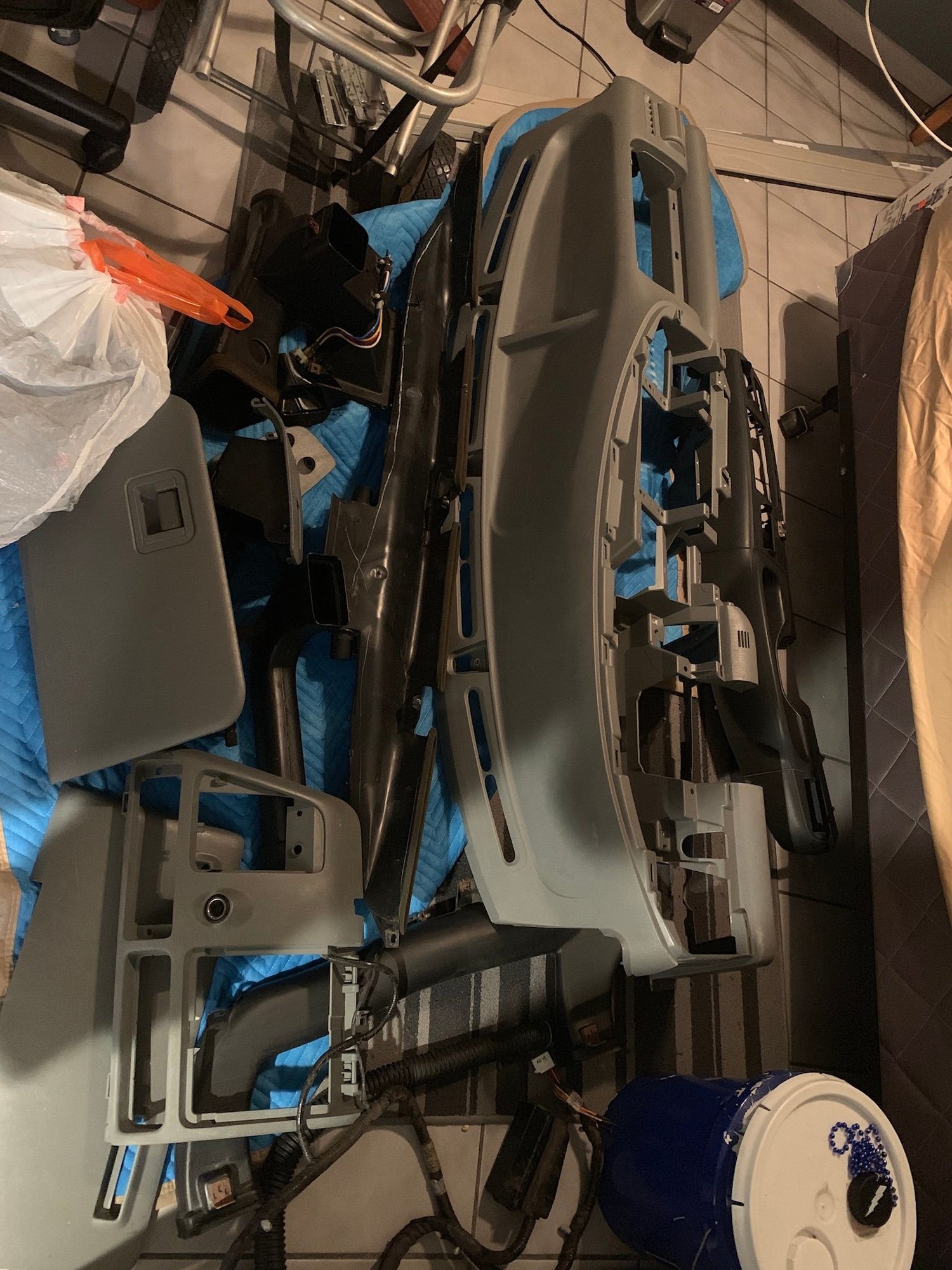

Here are a few photos I took 100s but the vast majority were at when my phone too a hit. The radio also has to be removed and maybe the parking brake release handle I know to remove the entire dash it does.

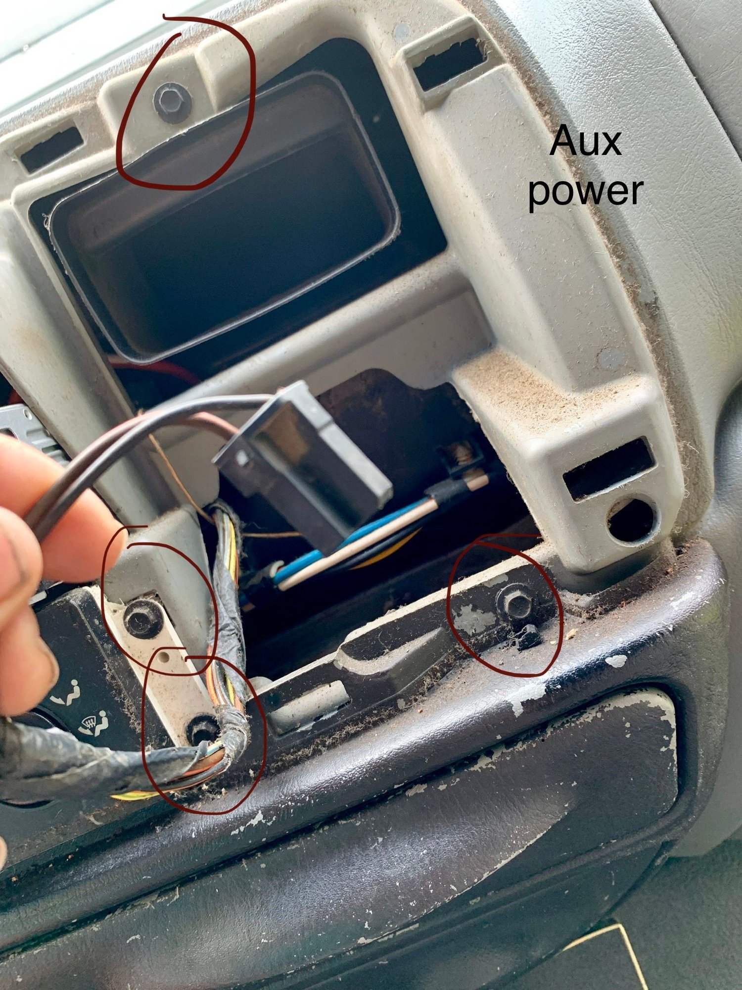

Just a few of the bolts but that’s the target style
The 2 gold bolts there need to be take out. The gear selector pops right out of the cluster.

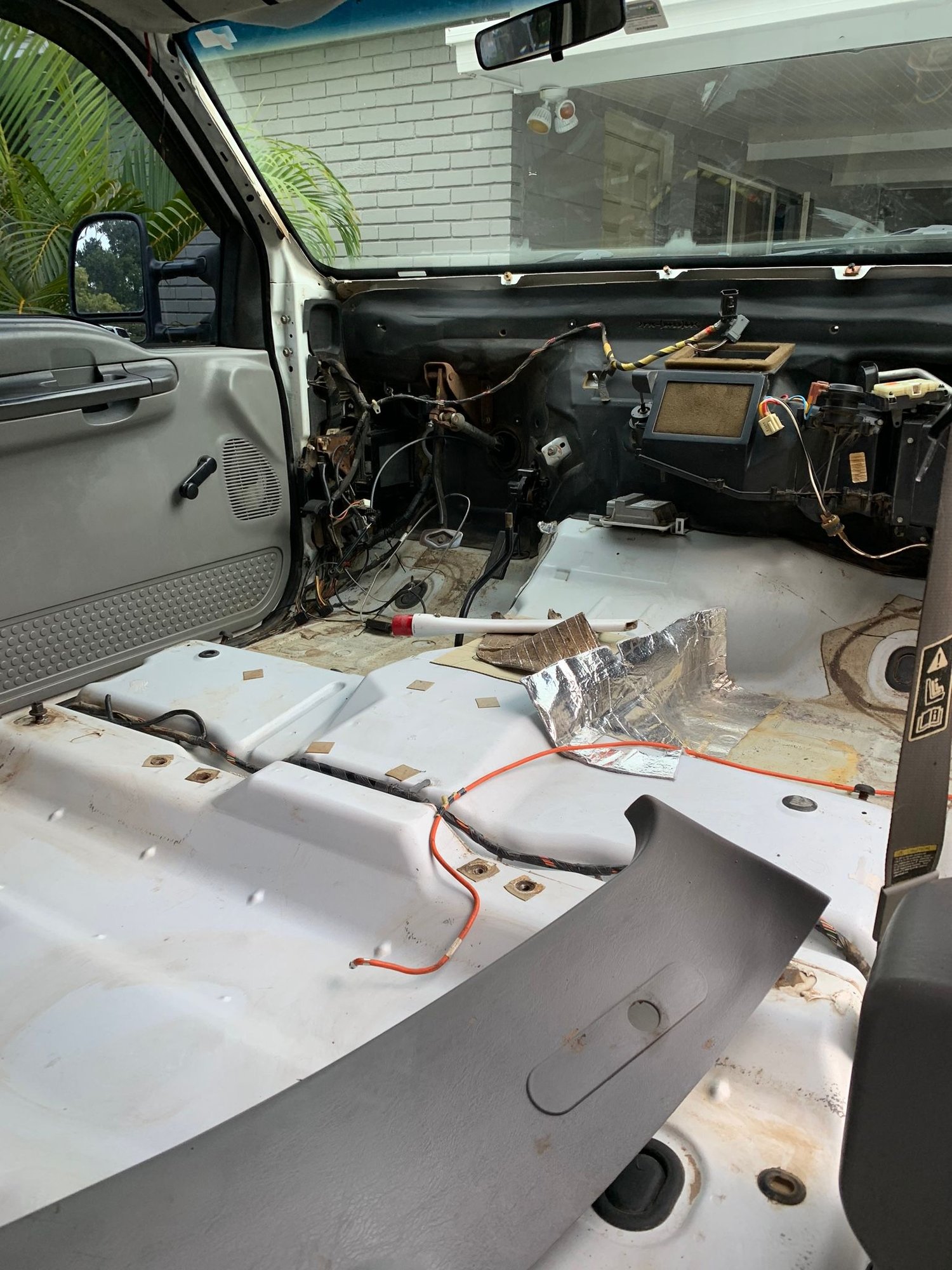

Air bag connected circled mounting bolt area is filled in.
