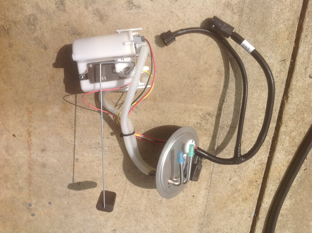

Originally Posted by bigric
I suspect that's the fuel pickup foot, not the pump. When the foot inevitably breaks, it brings the fuel pickup ~2" from the bottom of the tank AND reduces it from a 3" wide pickup to 1/4". The pickup is $30 from Ford. I've found a broken foot on every pump I've pulled.
On gassers? There really isn't a pickup foot on our fuel pumps, this is mine, it's sitting sideways, the end opposite the wires is the bottom that snaps into the base which is permanent in the tank bottom.
Attachment 282646
Old Nov 10, 2019 | 04:17 PM
bigric's Avatar
bigric
Joined: Aug 2001
Posts: 1,526
From: Round Rock, TX
Sorry, I skipped some context and assumed it was diesel.
